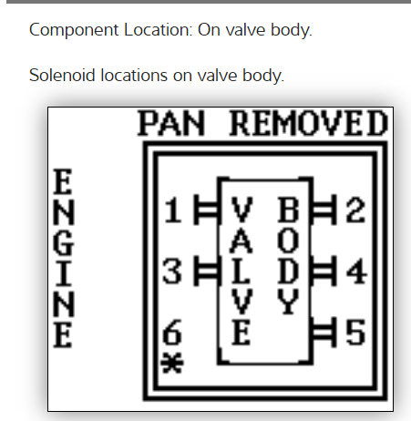

Hi, please can i have the location of Torque Converter solenoid on this vehicle listed above 2.0 diesel engine?
Dec 23, 2020 at 5:22 PM
STEVE W.
  • 15,351 POSTS
All of the solenoids are located under the cover on the valve body of the transmission. However what is the actual issue as there are multiple items that can cause things like no lock-up or poor shifting. Do you have a check engine light on?
Dec 24, 2020 at 3:28 AM
DANNY L
  • 5,648 POSTS
Hello, I'm Danny.
I've attached a picture below of the solenoids that are located on the valve body in your vehicle's transmission. Hope this helps and thanks for using 2CarPros. Happy Holidays.
Dec 26, 2020 at 8:55 AM
ANDRIN ATEM
  • 410 POSTS

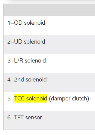

Thank you. So among those 5 solenoids, the torque converter clutch solenoid is amongst? or is the another position for that particular solenoid?
Dec 26, 2020 at 9:23 AM
DANNY L
  • 5,648 POSTS
Hello again.
On the picture of the valve body in the prior post it is in location #5. Hope this helps and thanks again for using 2CarPros.
