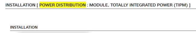

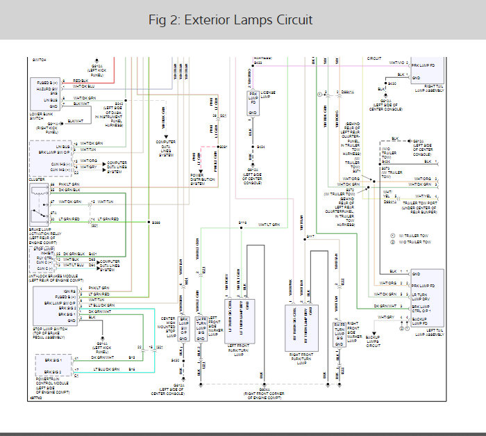

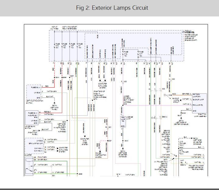

I have the vehicle listed above that the parking lights won't turn off. I even removed the multi-function switch and they still stay on. My guess is the BCM.
Thank you
Sep 18, 2019 at 2:13 AM
SCGRANTURISMO
  • 4,897 POSTS

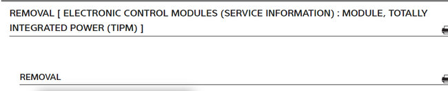

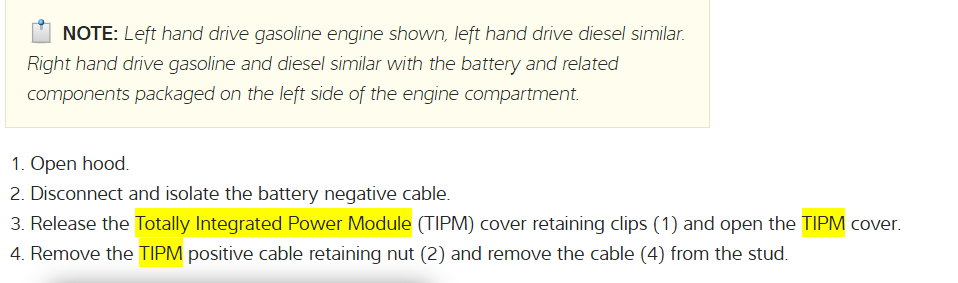

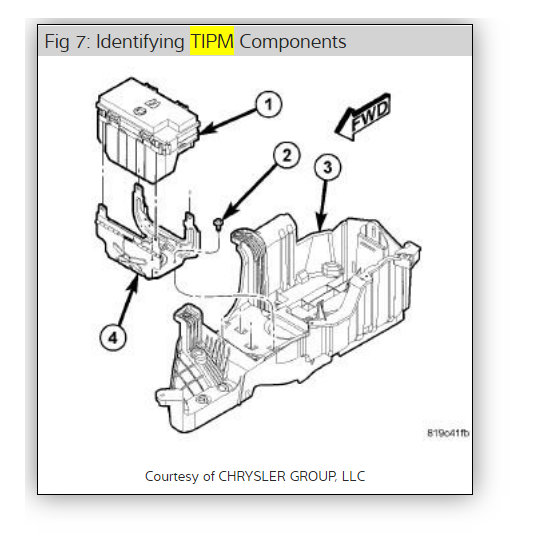

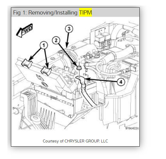

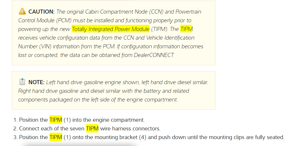

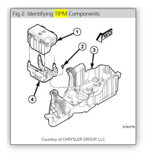

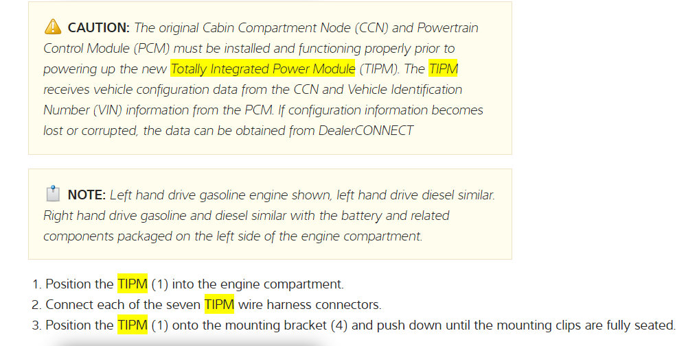

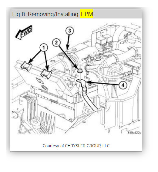

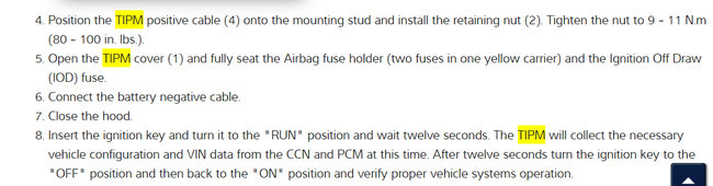

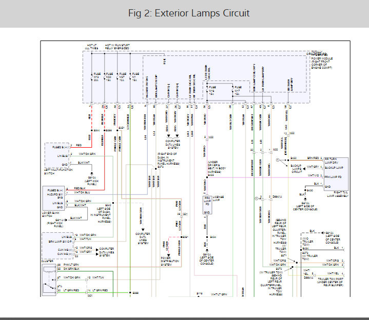

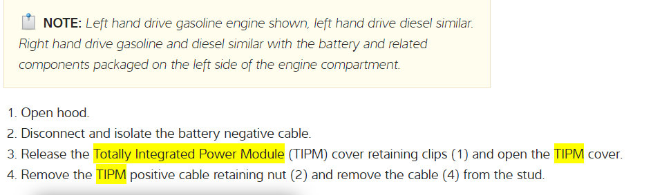

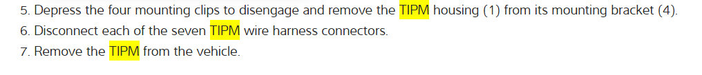

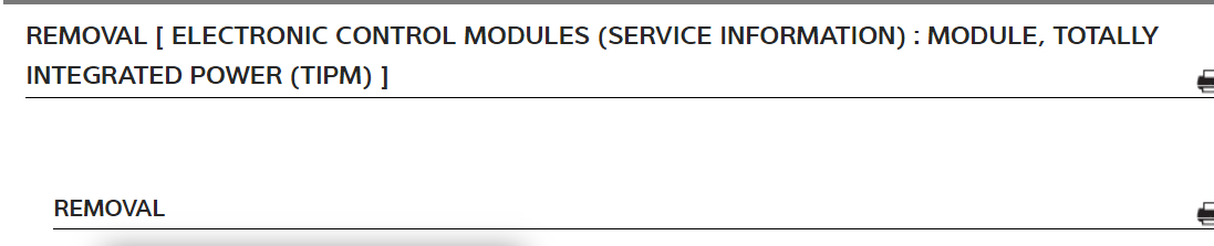

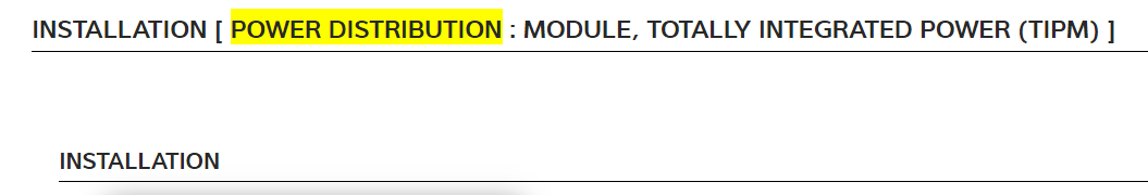

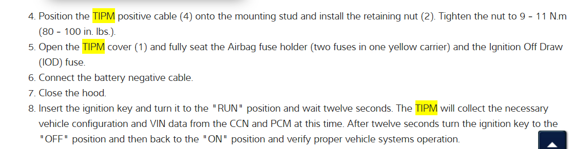

There is definitely a short to power somewhere in the parking light circuit. My guess is it is probably going to be in your vehicle's Totally Integrated Power Module(TIPM). In the diagrams down below I have included a wiring diagram of the exterior lighting of your vehicle as well as the instructions for the removal and installation of the TiPM.
Please go through this guide and get back to us with how everything turns out.

Thanks for the Reply. It's under warranty so I'm having the dealer handle it. I was just curious what was going on.

You where right it was the TIPM.
