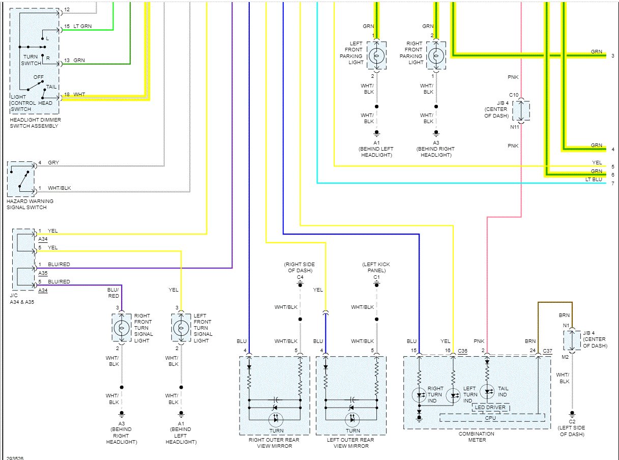

Bulbs all new fuses all new. regular headlights working fine and stop light except the parking lights are not turning on while driving at night. I have replaced all fuses the only thing that I need to know if there is a relay for them and where is locate.
Mar 12, 2022 at 3:45 AM
  • 110,244 POSTS

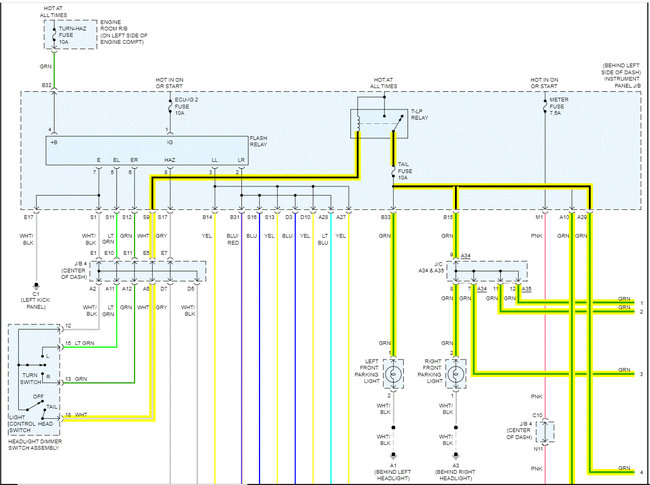

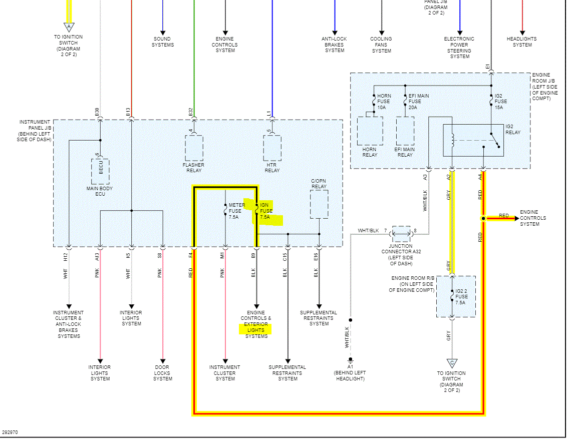

There should be a parking lamp relay in the junction box on the left side under the dash.

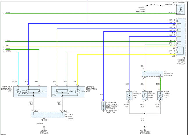

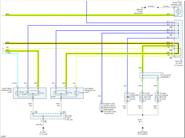

I attached the wiring schematic below for reference, and I highlighted the relay. Take a look through them and let me know if they help or if you have other questions.

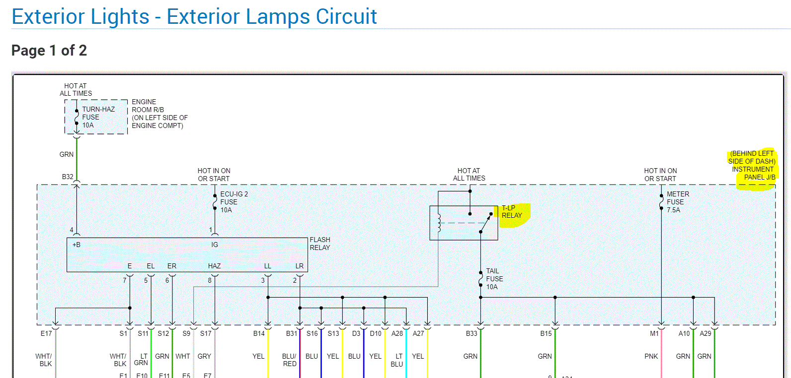

I notice you said you highlight the relay can you tell me which color you used to highlight because there are different colors on the schematic I appreciated. Also, I believe if not mistaken there is a relay for parking lights behind the fuse box on the inside cabin by the driver side. can you verify if I am correct, please? I just don't see it could be behind the fuse box? Thanks for your help.
Mar 20, 2022 at 2:47 AM
  • 110,244 POSTS
Yep, there is one. See the pics above. As far as wire color, between the lights and relay, they are all green. See pic below.

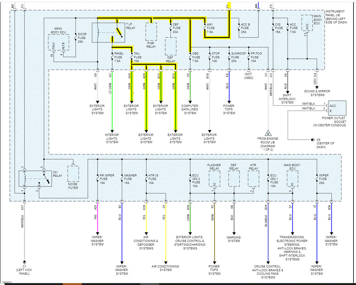

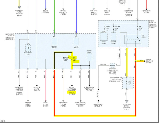

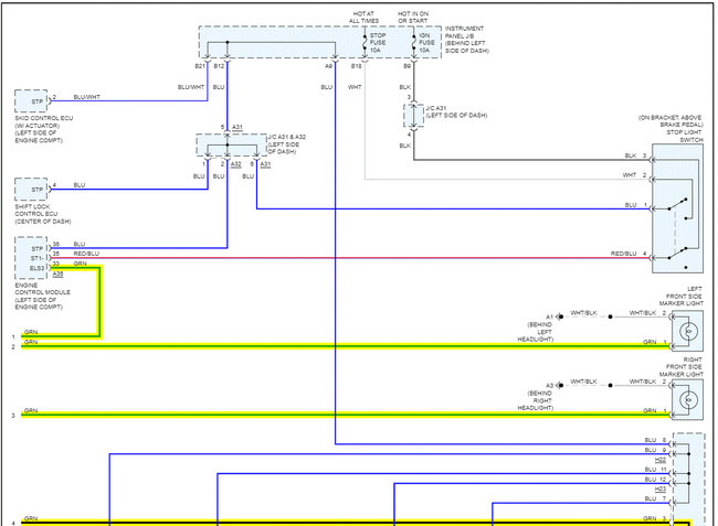

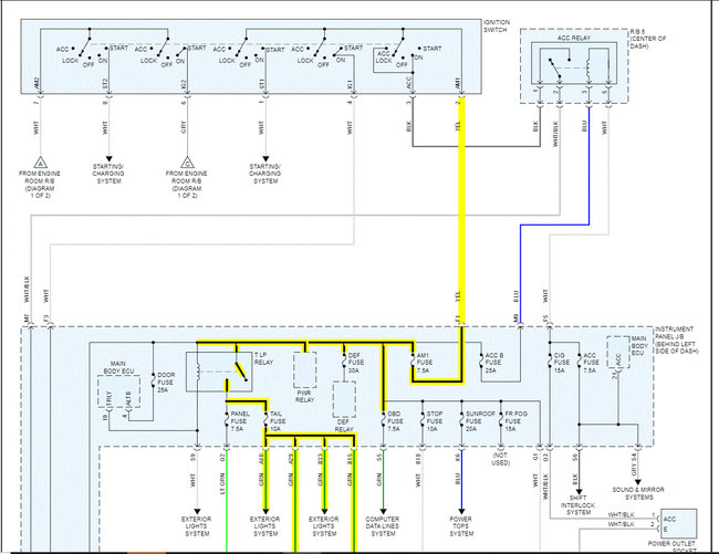

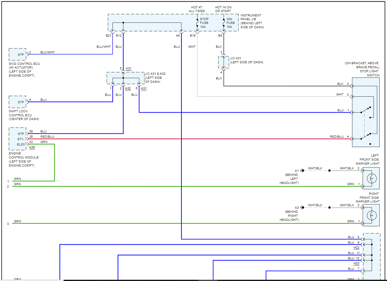

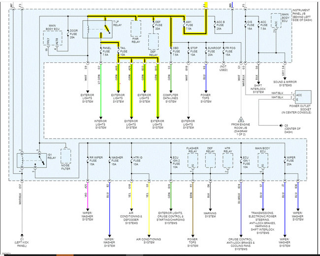

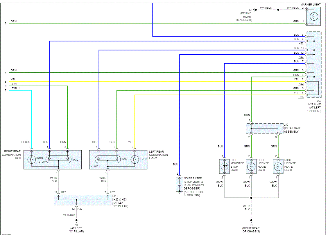

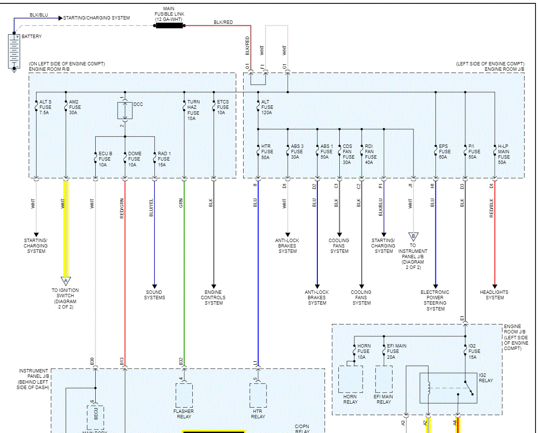

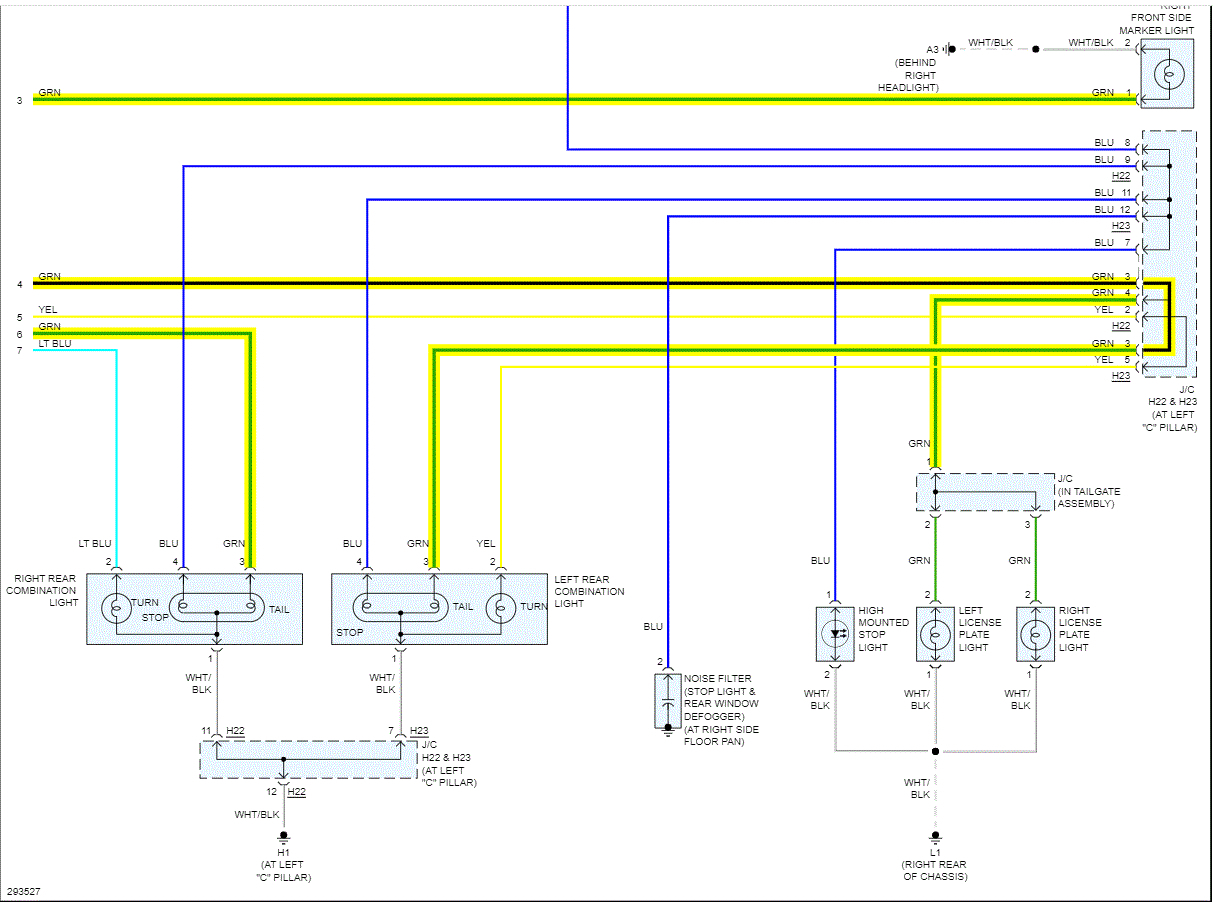

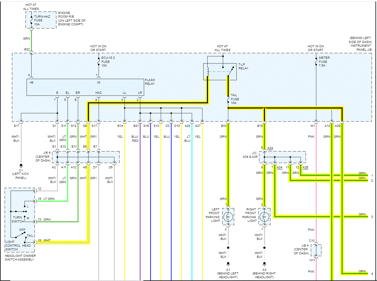

I attached the entire wiring schematic below for the exterior lighting system. We simply need to determine where power is lost. Since none of the parking lights work, it is likely at the fuse box.
The first 4 pics below are the exterior wiring schematics for the exterior lights. I highlighted all wires related to the parking lights. The last 4 are power distribution schematics.
There are several possible issues, but again, since none of the lights work, it is at the fuse box or before it. I'm basing that on the different directions the wiring branches after the taillight relay, which we still need to locate.
First, if you look at pic 1, it shows a 10-amp tail lamp fuse. Check the fuse. Next, with the lights turned on, see if there is power to and from that fuse. Pic 9 below shows the fuse and its location. (Interior fuse panel).
Start with this. Also, I went through every schematic I could find although the info below shows a relay, nothing is found. There is a chance something is different based on the production date.
