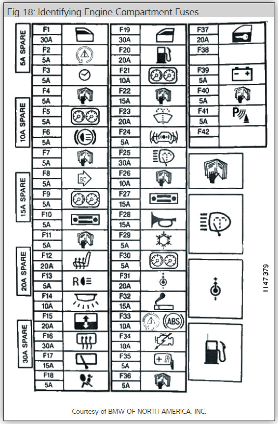

Yesterday water came in through my clogged sunroof. Now when I get out of car and turn lights off and take key out of it my parking lights stay on. I have tried to take battery cables off to reset. Now I am taking two fuses out under the hood so parking lights will go off so my battery does not drain.
Sep 8, 2018 at 9:29 PM
  • 55,691 POSTS

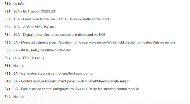

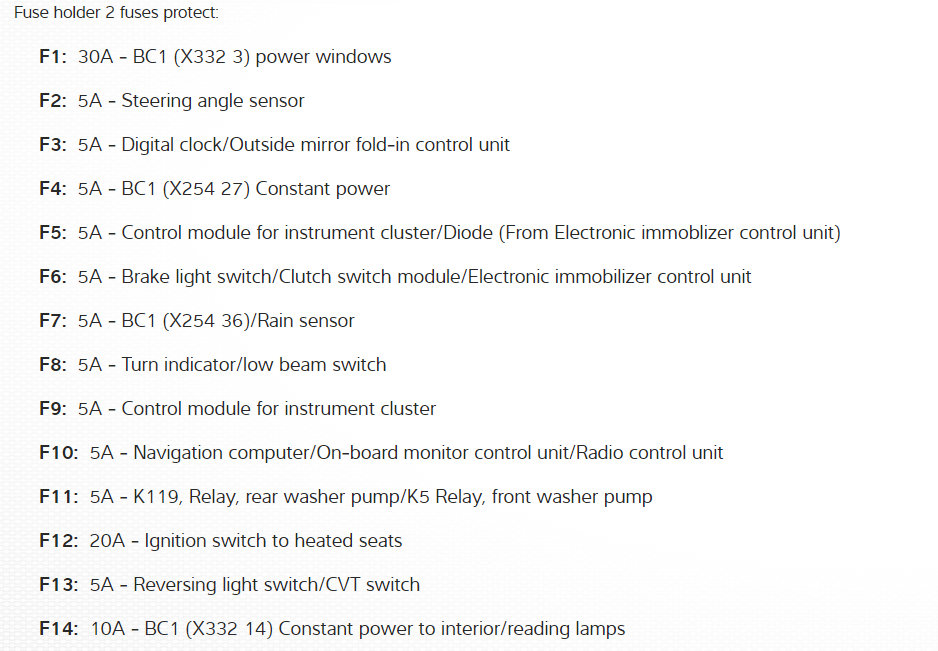

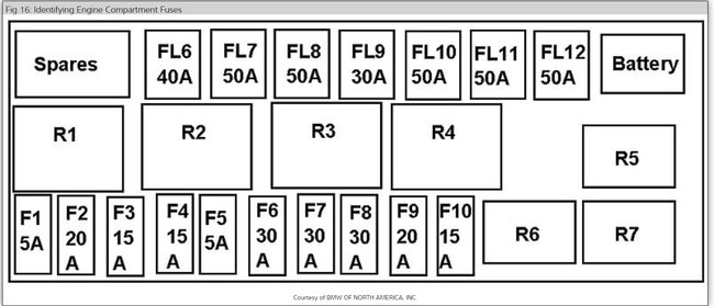

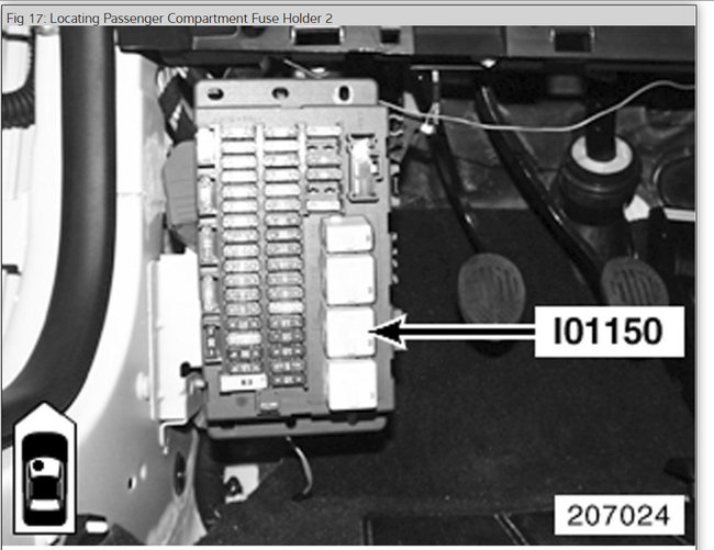

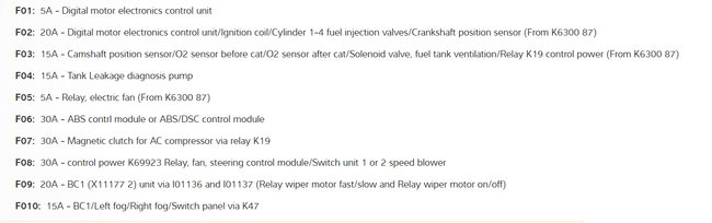

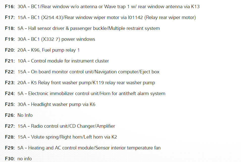

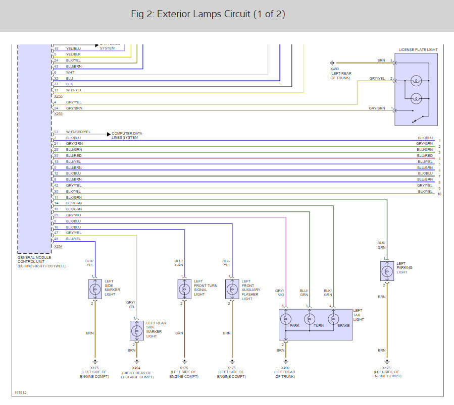

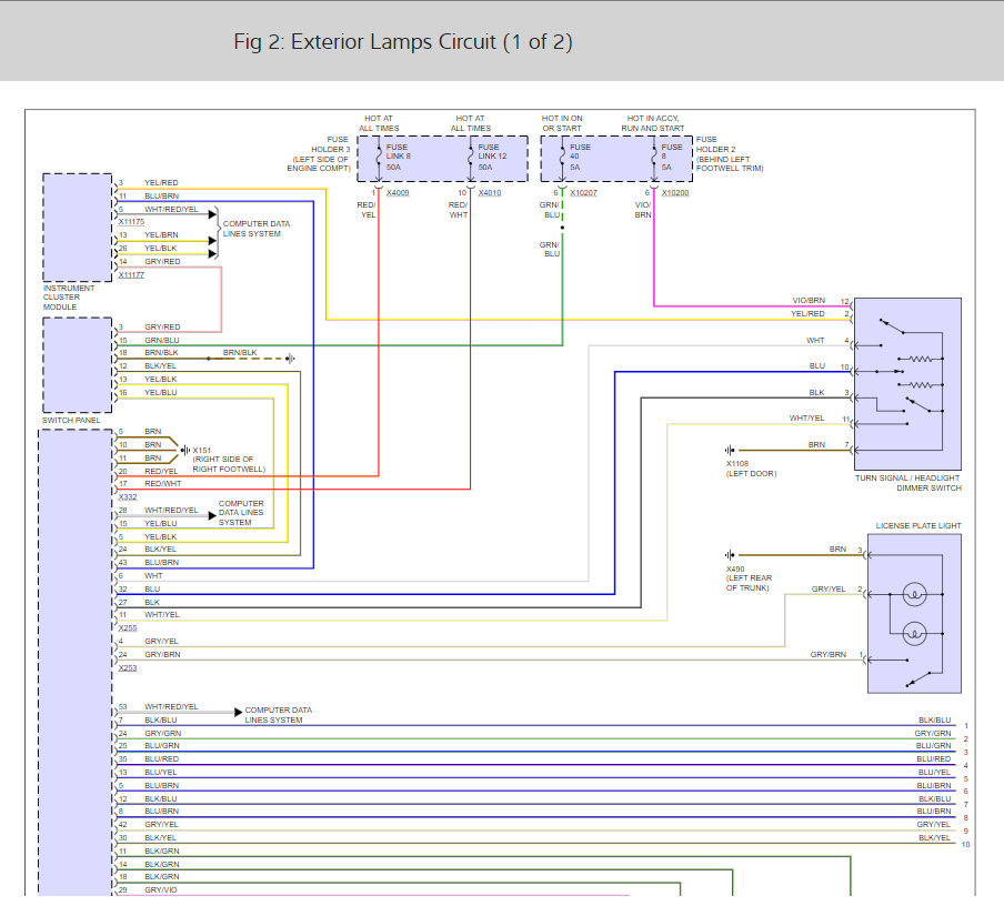

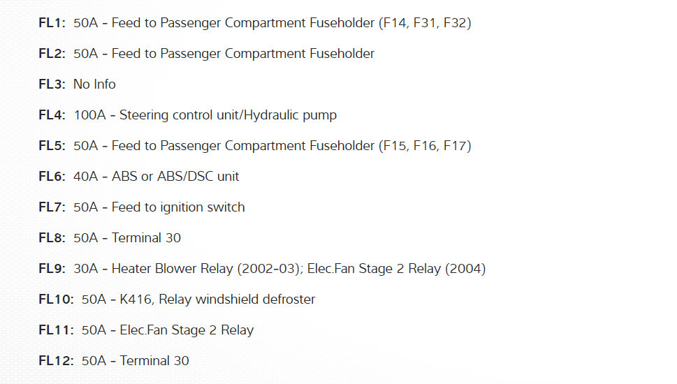

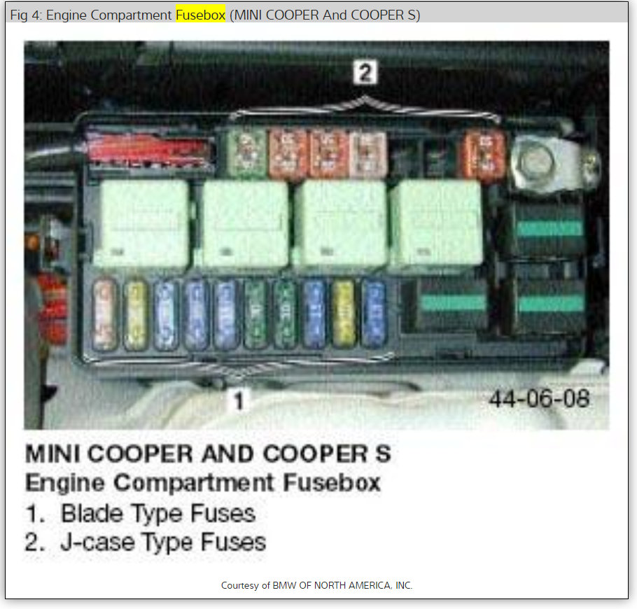

I would check fuse #40 and #5 which control the switch and general lighting module. Next I would unplug the headlight switch to see if they go out. Here is a guide to help you test the fuses and the fuse location as well as the running light wiring diagrams so you can see how the system works:
Check out the diagrams (below). Please let us know what you find.
