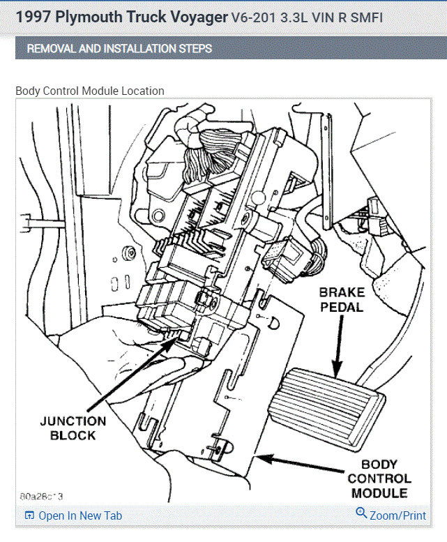

There will be a part number on the BCM. I did some quick research and found only one part number, but I could be wrong. Check out this site. They offer plug-and-play modules.
https://www.fs1inc.com/oem-bcm-body-control-module-plug-play-1997-plymouth-voyager-4686671.html
Please understand, I have absolutely nothing to do with that site, I just came across it. I don't want you to think that I or our site benefits from "selling parts" because we don't. See if you can find one cheaper that is plug-and-play. That way, you only have to remove and install it on your vehicle. The sites usually will ask for specifics such as engine size, VIN, transmission type, and so on.
I attached directions below for the removal and installation.
I hope this helps. Let me know.

Okay, so i finally replaced the BCM from that Flagship One site you suggested. They were very good to work with.
I had 3 electrical issues: 1) parking lights come on at random; 2) dashboard lights come on then fade out when headlights turned on; and 3) front wipers come on at random and wiper delay doesn't work.
1) I believe the parking lights are a wiring connection issue as they are now working properly after replacing the ECM and fooling with the connectors to the ECM.
2) Since replacing the BCM the dashboard lights are now working properly indicating I did have a faulty BCM.
3) Replacing the BCM has also fixed the wiper delay issue, but still at time when I hit a pothole in the road the wipers come on for a while with the switch off. I had already replaced the switch so somewhere in the wiring there is a short that I will try to find, eventually.
