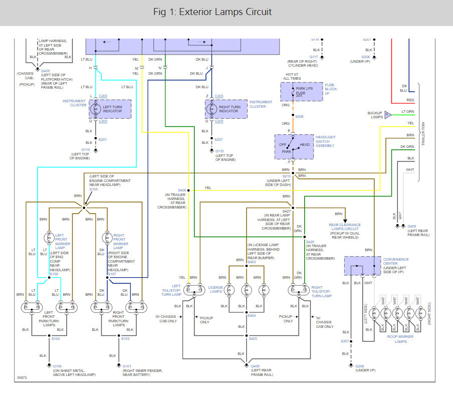

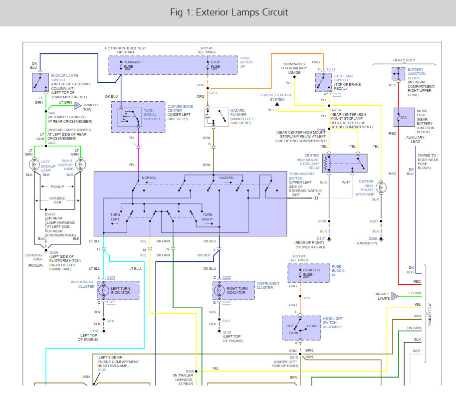

I accidentally broke the wire that controls the parking lights they now stay on all the time. Can you help me? thanks, Jim
Jul 2, 2022 at 3:35 AM
  • 55,433 POSTS
I don't understand what wire would keep the lights on, here is a parking light wiring diagram can you show me which wire you are talking about? Please send pictures of the problem. Check out the diagrams (below). Please let us know what happens.
