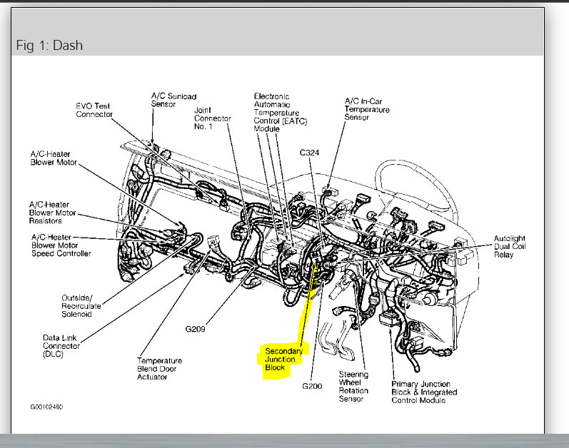

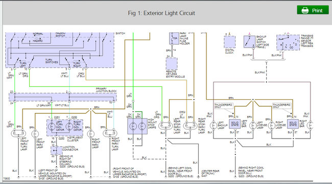

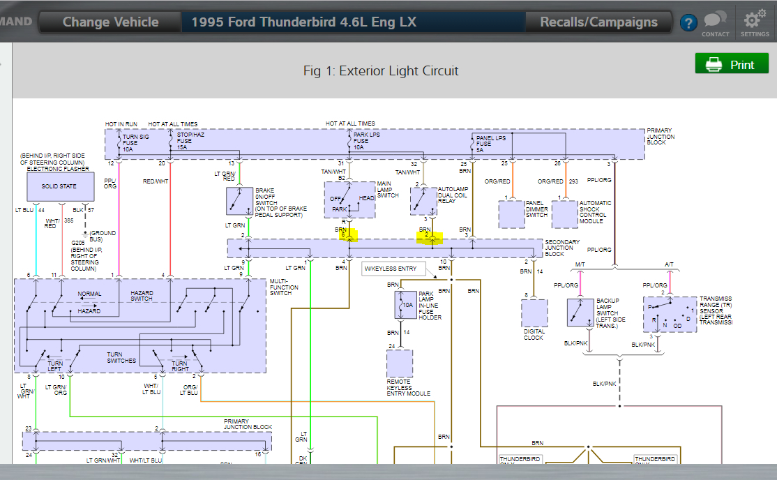

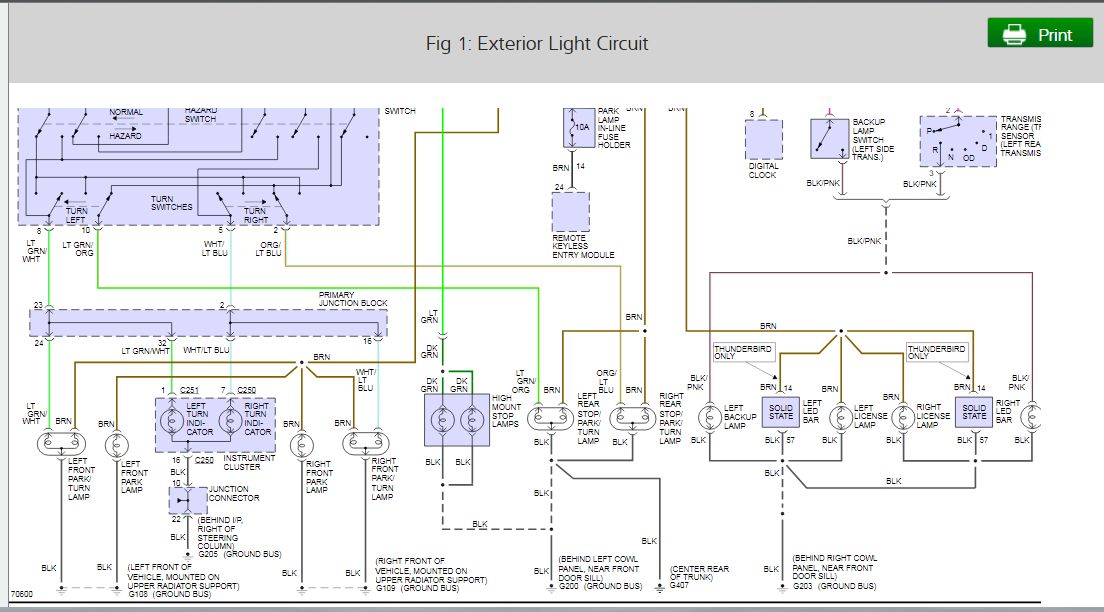

One night my cars horn blew and the headlights and parking lights came on then the headlights went off but the parking lights stayed on. I changed out the light switch and they still are on.
Apr 30, 2019 at 12:56 PM
SCGRANTURISMO
  • 4,897 POSTS
This sounds like your vehicle might have a short to power in the parking lamp circuit. I need you you to take a voltage reading at pin # 2 and 6 in from the secondary junction block with the light switch off. I have included the exterior lighting wiring diagram and the location of the secondary junction block in the diagrams down below. I have also included a link below for you to go to if you are unfamiliar with how to use a multi-meter. You will need to use one to a voltage reading for tracking this short down.
Please go through these guides and get back to us with you get on the two voltage readings. We will go from there.
