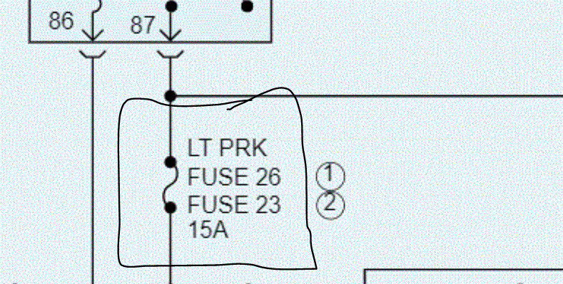

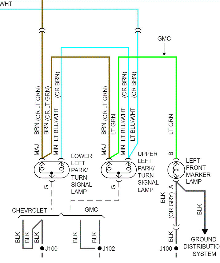

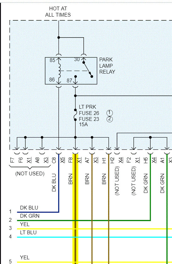

I attached a portion of the wiring schematic below. What I need to know is if there are actually two bulbs that are on. The power supply comes one fuse that will turn several lights off if removed.
Let me know if there are two. Also, remove the bulbs and inspect the light socket and bulb to make sure nothing is causing a short.

Yes, both top and bottom bulbs are illuminated on the driver side parking light only. I visually inspected the connectors but did not see any damage to them. All signs point to a bad ground. I have cleaned and polished the main ground that runs from the battery. Did not fix the problem. I am unsure where it may also be grounded. Is that something you can point me towards?

If the lights are on, then it is a short to power. Something is providing power to the lights that shouldn't be. The ground is good otherwise, the lights wouldn't work.
If you remove the parking light fuse, do they turn off?

If the light was staying on when the fuse I mentioned above was removed, then there is something shorting to power. The fuse above is under the hood.
If it happens again, what you will need to do is remove one fuse at a time and then replace it until you find one that turns off that light. Then we will know what circuit is causing the issue.
