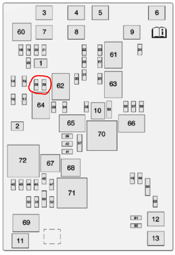

First thing you should check is the parking lamp fuse. One is for the left side the other is for right side. Here is a tutorial on how to check and replace fuses:
I've attached a picture below showing its location in the under hood fuse box. The fuses are in the micro blade locations number 28 and 29 And I circled in red. Hope this helps and thanks for using 2CarPros.

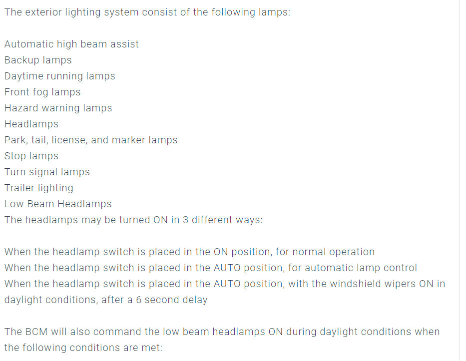

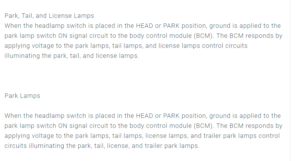

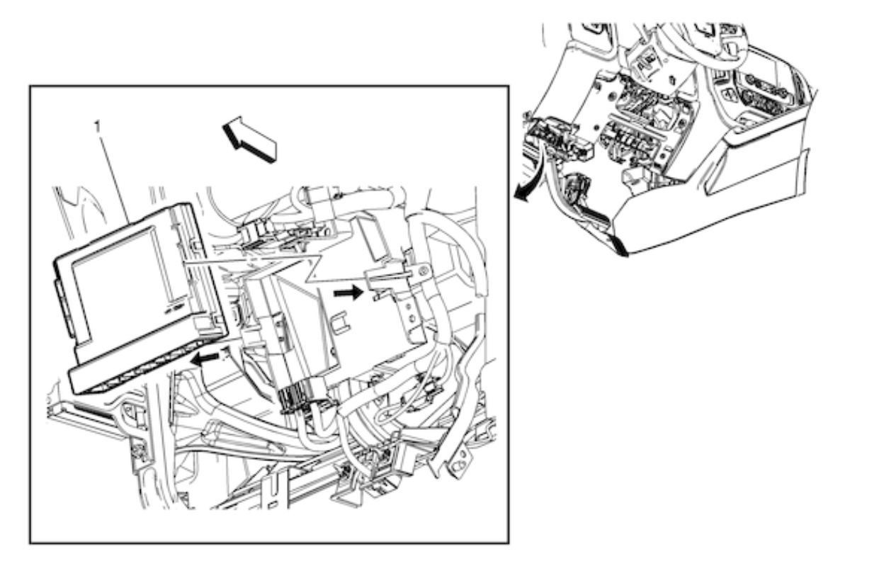

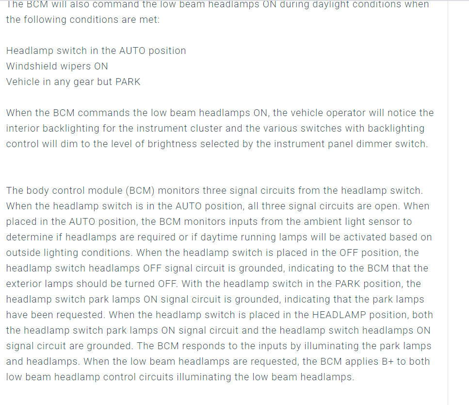

Good morning,
The body control module controls the operation of the lights. If your Canadian model does not allow just parking lights, you will need to go to a GM dealer and have them program the BCM for the lights to work on there own as they do in the USA.
