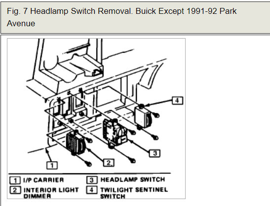

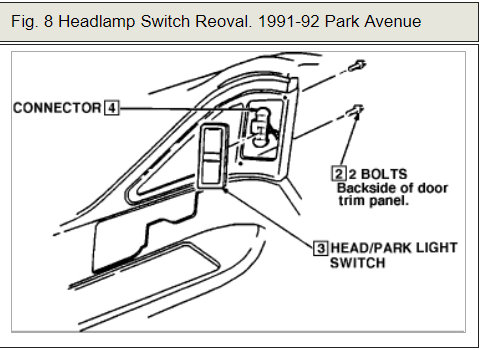

Parking lamps will not go off.
Saturday, February 24th, 2018 AT 3:48 PM
KEN L
MASTER CERTIFIED MECHANIC
47,602 POSTS
It sounds like the headlight switch has gone bad. Can you unplug it to confirm?
