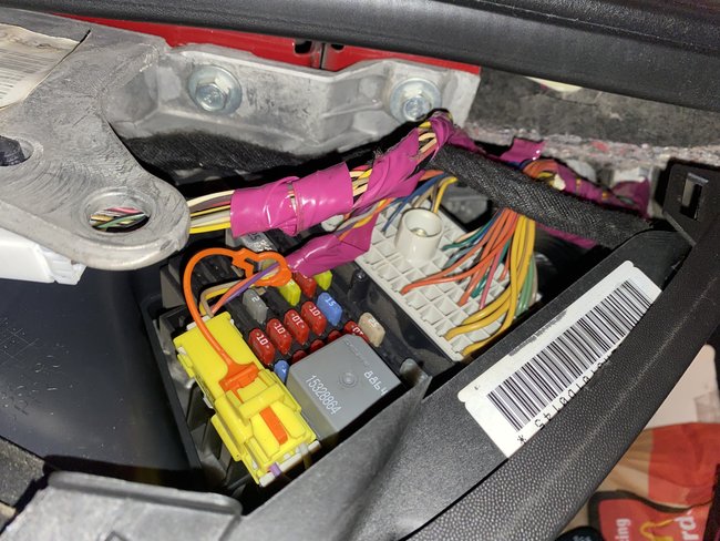

So when I say a noise I mean I can hear and feel a relay popping in the passenger side fuse box when I put my hand on it while turning the key to on. I haven’t been able to change out that relay as I can’t figure out a good way to get the retainer unhooked as it very oddly placed and seems to be very stiff and don’t want to risk snapping it. I didn’t have the issue prior to changing out the multi switch which I believe is what caused it. as I originally put in one that had a fog light switch but the vehicle doesn’t have fog lights. so I got the correct one and returned the old one as before with the original switch my high beams would stay on at night. when I say only one light works on the exterior the driver side bumper light or parking light is on but the passenger side isn’t never changes only that orientation but my signals work fine and they share the same bulb. I know exactly where and how to pull out the relay I need to change and I have the replacement relay already just have been having issues with actually getting to the backside of the fuse box.

Do me a favor. Take a pic of what you are seeing that is causing problems for you and upload it for me to see. When I look at the manual, all it shows me is the fuse box and nothing as far as removal.
Jul 25, 2021 at 12:03 PM
ASTRORIP
  • 28 POSTS
Okay, when I get the chance I’ll get a picture of both the lights dimming and the front lights not working probably and I’ll try and get a video of the relay popping.

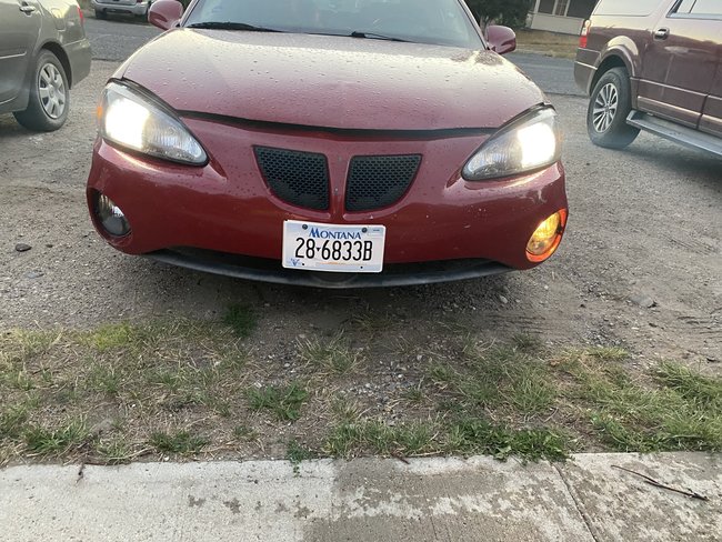

Sorry it has been a while since the last reply. here is some videos and pictures I have put together. got some new issues that have recently popped up as well. First video of the front of the car the passenger side turn signal and parking lamp is not as bright when the headlights are off but when they are on it doesn’t work at all the the right turn signal blinks fast. And in the last video sorry for the occasional bad footage but when I turn off the headlights the interior lights are fully lit but when they are turned on it they dim and the part of the relay box where the wires go into the white panel I need to get on the backside of that to replace the relay that is popping.

Do all lights work on the right side signals? The double-time. flash is designed to indicate an open circuit. Have you gotten to the relay you originally asked about?
Aug 13, 2021 at 11:57 AM
ASTRORIP
  • 28 POSTS
I have not gotten to relay yet as I’m still having trouble accessing it and currently if the main low beams are not on the right side signals do work, but when they are on only the rear right works at double speed.
Aug 13, 2021 at 12:00 PM
  • 110,244 POSTS
Have you checked for ground problems? The added load from the headlamp may cause the right front to lose ground. Is that the one that is dimmer? It sounds like a ground issue.

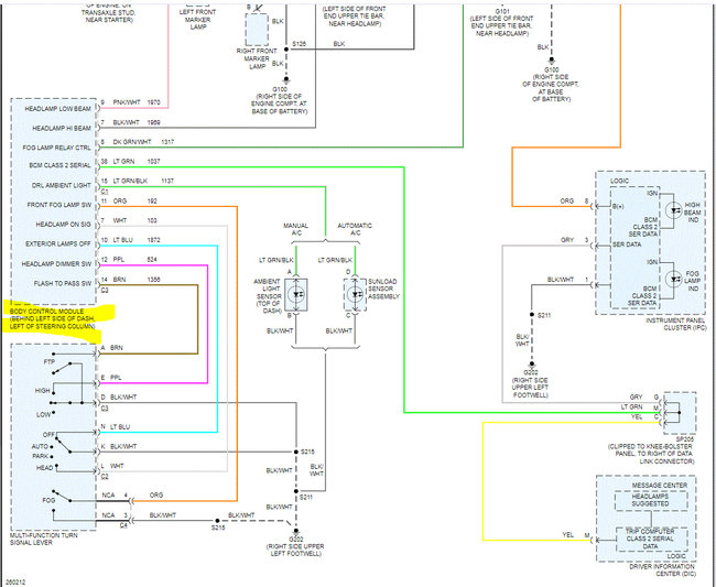

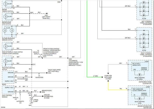

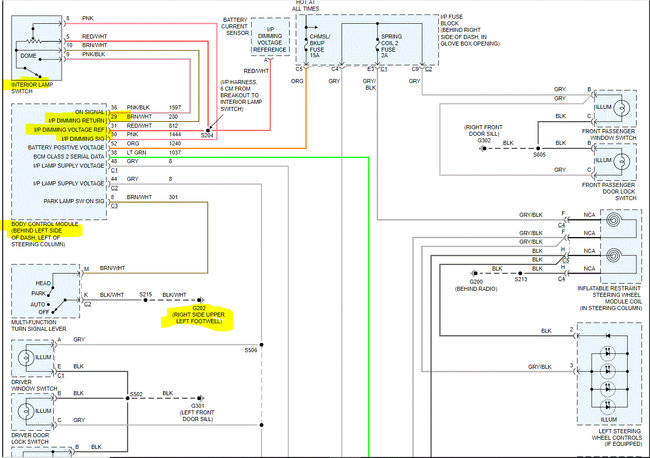

Do the lights respond at all when you adjust the dimmer?
I attached the wiring schematic below for the interior lights. I highlighted the dimmer, where it goes to the body control module, and so on. If the dimmer switch doesn't make any difference, it could be bad.
Also, you may want to check the ground in the left kick panel to make sure it isn't loose or corroded.
See pics below
Note: I had to cut the schematic in half to make it readable. I did overlap them so you can follow from one to the next.
Aug 17, 2021 at 1:26 PM
ASTRORIP
  • 28 POSTS
Yes, when using the dimmer switch the dash lights and everything so respond properly. I will work on checking grounds inside the car to see if they need replaced.

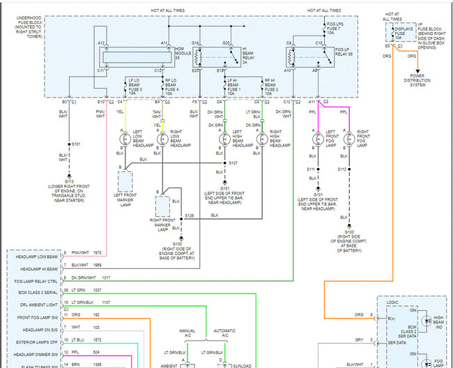

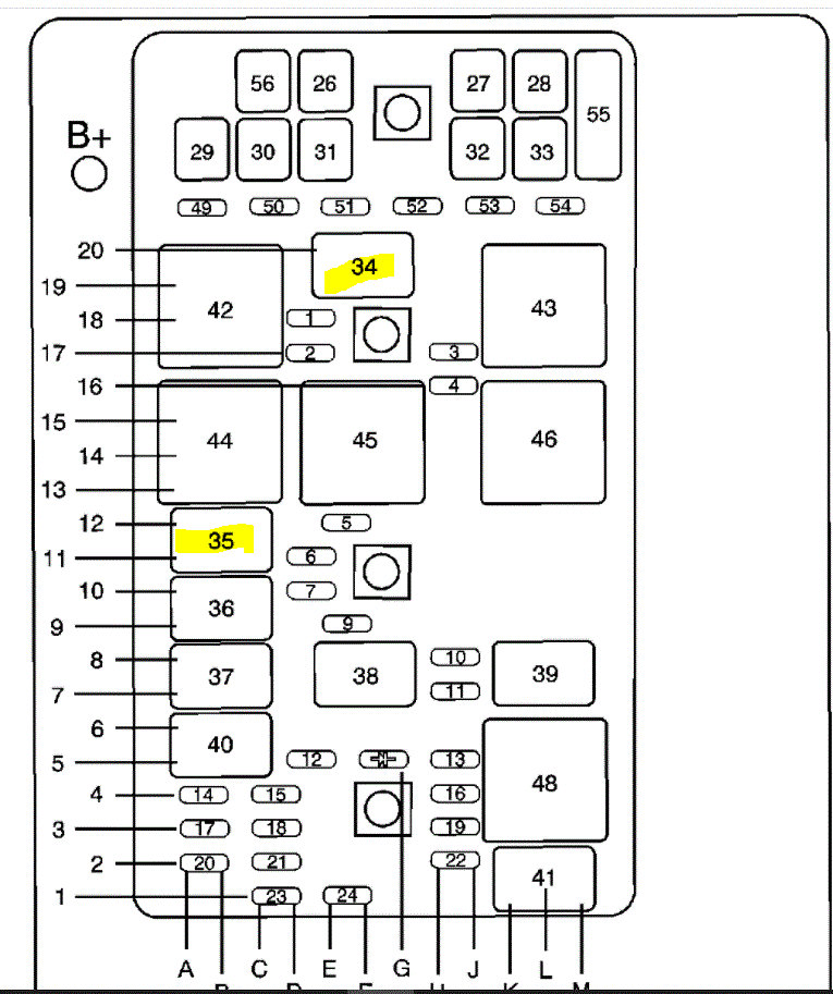

Are the headlamps working properly? Years ago there was a recall on the HDM. It would overheat and you could lose low beams. Was that recall ever taken care of? I'm asking because it could be something related to that.
Also, there is a headlamp relay that you may be hearing. One is for the high beam and the other for the HDM module. HDM stands for headlamp driver module.
I attached a pic below and highlighted the relays. The only issue is, they are in the under hood fuse/relay box.
Try this. Pull one of the relays at a time to see if the noise stops. If it does, tell me which relay was removed to stop it.
The only other thing under the dash related is the body control module. Check to see if that is where the sound is coming from.
I attached the schematics below.
Aug 21, 2021 at 3:26 PM

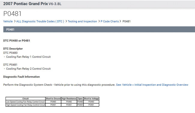

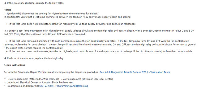

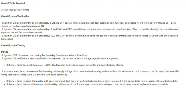

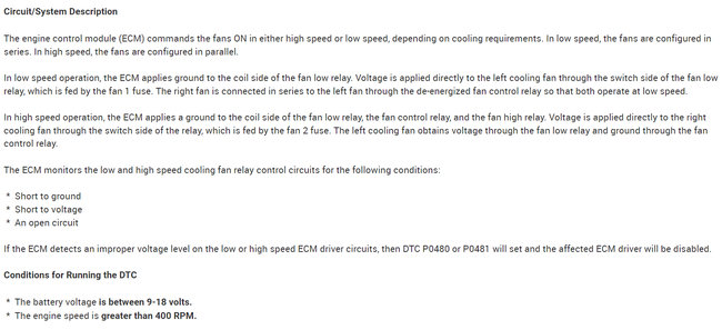

Well, here I am again with probably a final update after lots of changes and replacements including sensors thermostats fans relays and even full flushes just in case. I have still had to no update on the situation regarding the p0481 code regard fan 2 relay issue. I am stuck between it being a possible PCM issue or just straight wiring I have bought a multimeter to check those before buying anything as they can be a bit pricey but if I see no answers I’ll have hit a brick wall and won’t know what to do to fix it still/ also have the weird electrical short issue with my lights but that’s not a big deal/
Sep 26, 2021 at 9:35 AM
  • 110,244 POSTS

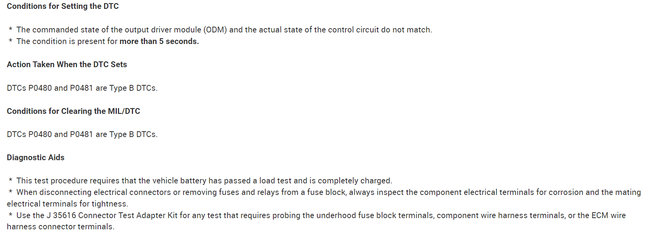

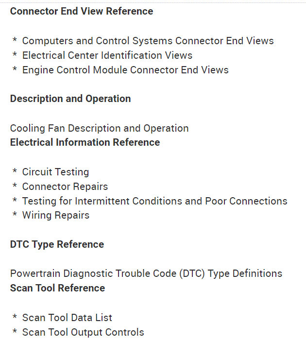

I don't recall seeing the code. Is this something you just found? I have diagnostics specific to this code. Take a look through them and let me know if they help.
Sep 26, 2021 at 1:35 PM
ASTRORIP
  • 28 POSTS
Most of this I have seen and or tested already including all relays and fuses linked to the fans with no luck on what’s going on. I have sorted it down to most likely a short in the wiring harness as resistance in almost everything else has read correctly. so, I’m going to need to either splice new wires wherever the old ones are bad or find a whole new wiring harness to replace.
