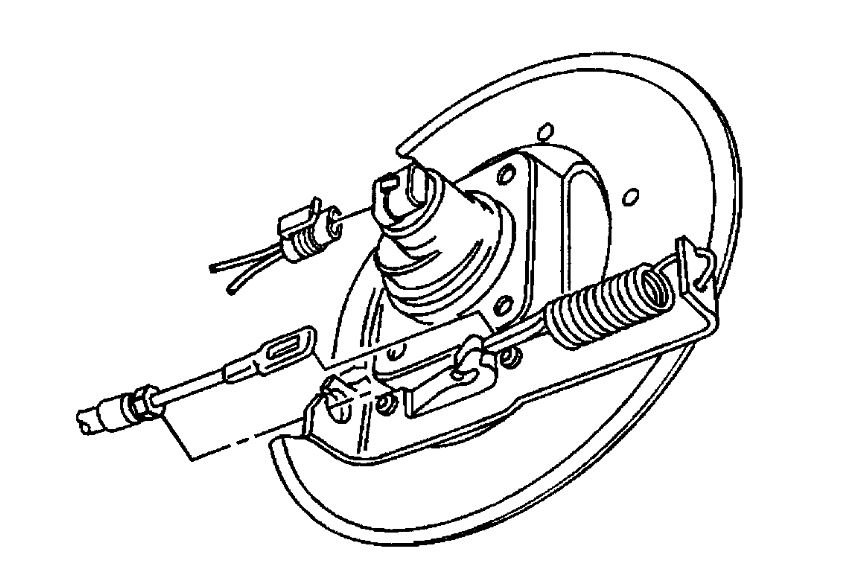

Working on this car, and never seen how it is suppose to look. Seams like might be parts missing, I do not know. Can I find a video, or a PDF to study from? I tried YouTube, but not getting this particular vehicle specific. Hope someone can advise.

After you remove the rotor, you should see the shoes. What normally happens is the actuator seizes up or the cable seizes up from the environment entering in such as snow, ice, debris.
I attached some pictures for you to view. If you can, can you upload what you see?
https://www.2carpros.com/articles/parking-brake-shoe-replacement

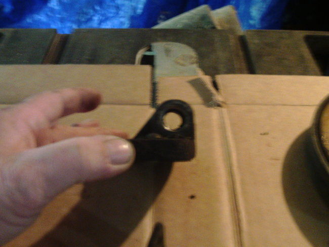

Yeah, but those pictures do not really help me much. I have replaced regular brakes (drum) and/or (disc) before, but these are the parking brakes on the inside of the rear disc rotors. I kind of need a video showing the removal and install of the components. I have ordered all the brake parts through RockAuto, but like I mentioned, I think there are parts missing from the old ones so I have no idea what I am doing after the new parts come in; like how the components fit together. I can take pictures or video of what I have here to start with if it helps.
Mar 12, 2021 at 2:56 AM
HKFROMNY.
  • 112 POSTS

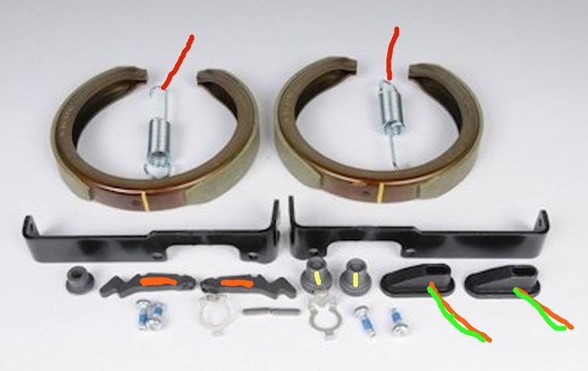

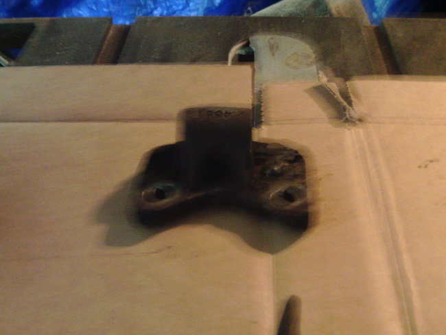

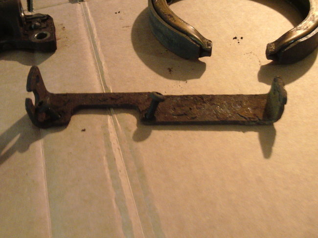

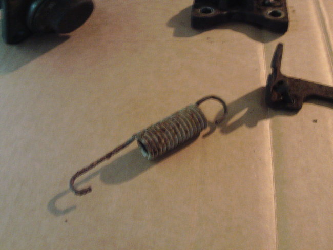

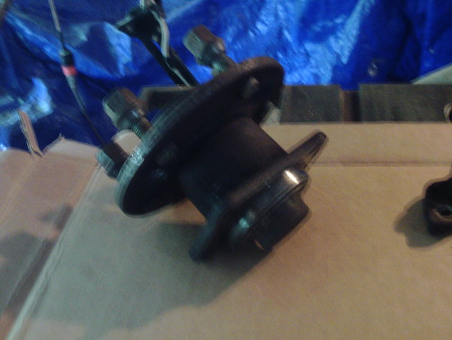

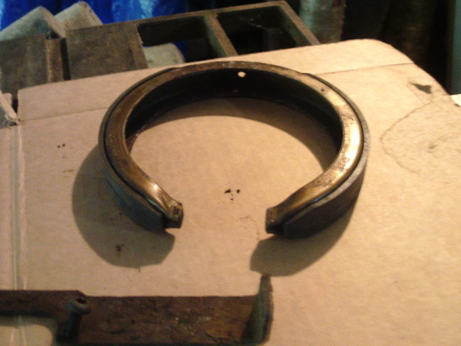

Okay, here is a few pictures of the parts, mind you, I have all new parts excluding the hub and knuckle sections, on their way. The pictures show each part that came off during dismantling. I thought that I may have dropped something, but found nothing using a magnet to check the ground area. Maybe you will need to see all the new parts once they arrive to give me some guidance?

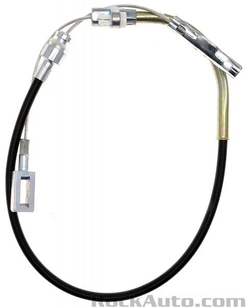

STEVE W.
  • 15,423 POSTS

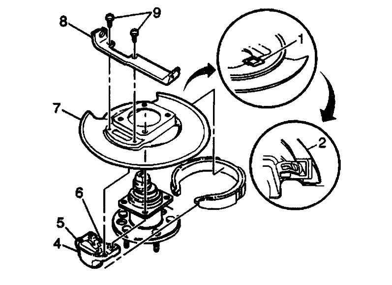

The cable goes through the bracket pictured. There is a slot on the end that goes over the actuator lever that slides into a slot in the rear of the second image piece. The second part will have two notched parts in it, one just sets into the part the the other has an adjuster.
This is the same basic set up GM used on the Blazers and even the full sized trucks. They all go together the same basic way although a couple reverse the cable location.
www.youtube.com/watch?v=bSS1qHMNdLM

Okay, I think I am understanding the procedure. So, my thought that there would be some form of lever type that the cable hooks to in order to put pressure on the actuator to spread the horseshoe brake-shoe to set park. I was completely wrong. I will have to see if these parts from Rock Auto tell me any more details. I really do appreciate all you guys's help and patience with me. I will be in touch if needed again after Thursday when parts arrive. Thanks again crew.

STEVE W.
  • 15,423 POSTS
The levers that actuates the parking brake are in the third picture. They now have orange on them. They go through the two rubber pieces G/O which go into the large hole in the backing plates. The large black cable brackets mount to the rear of the axle flange and the cables attach to those. The end of the cable slides over the actuator lever and the spring goes out the other side to the mount. In NY you usually see those springs rot off and the backing plates rot out and need to tear most of the hardware off to replace it.
I read your name as being in NY? What general area?

I will sends some pictures of the stages if I get lost in the madness. I did happen to locate one of the levers that go into the back slot, it was, believe it or not, fused in a rusty clump still attached to the cable, the other side must have rusted completely off the end of the cable, might be the reason why the parking brake failed, lol. Anyhow, enough humor for the night, and we will be talking later maybe.

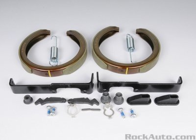

Hey, RockAuto sent along detailed instructions of the install process, great, they must figure that most of us are DIY'ers. So far, we have saved close to $1,000.00 in labor alone.
HKFROMNY.
  • 112 POSTS
Hey guys, piece of cake, I was really overthinking this whole thing. I am definitely telling all my friends about your service. Thanks so much guys!
