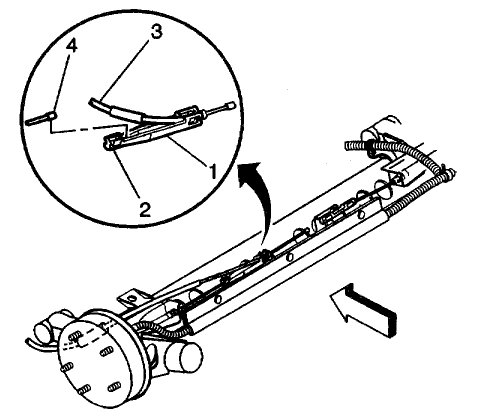

Removal Procedure:
Raise and support the vehicle. Refer to Vehicle Lifting.
Pull and hold the cable towards the rear of the car in order to create slack in the cable.
Bend the tang (2) on the connector (1) in order to allow cable removal.
Disconnect the cable (3) from the connector (1).
Fold over the retaining clip.
Disconnect the cable (3) from the equalizer.
Remove the safety stands. Lower the vehicle.

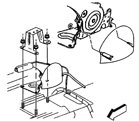

Remove the console.
Move the lever to the OFF position.

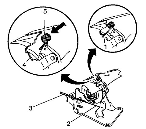

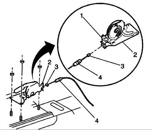

Remove the cable conduit end fitting (3) from the lever assembly (1).
Pull the cable (3) until the notch on the ratchet (1) is visible through the cover plate opening (4).
Push the pawl spring downward toward the notch in the ratchet.
Release the cable (3) slowly in order to allow the notch to catch the leg of the spring (5).
Remove the front parking brake cable button (2) from the reel assembly.

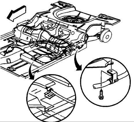

Remove the left door sill plate.
Remove the grommet and retainer from the floor pan.
Remove the cable from the clip.
Remove the front cable.
