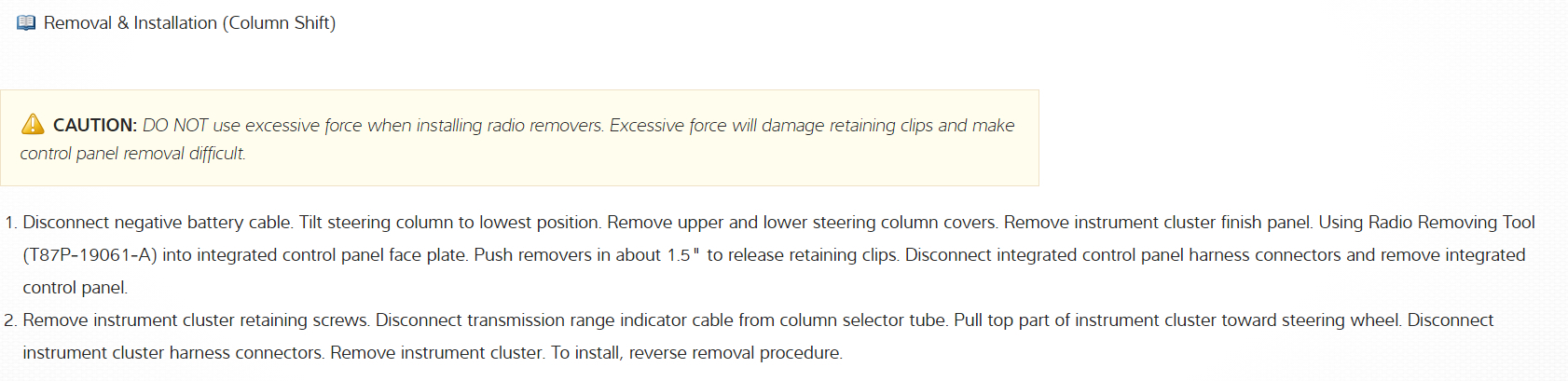

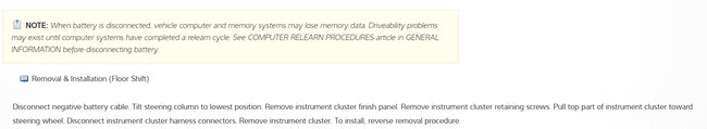

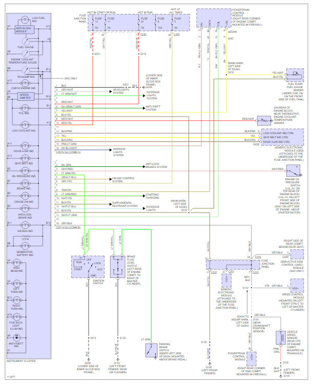

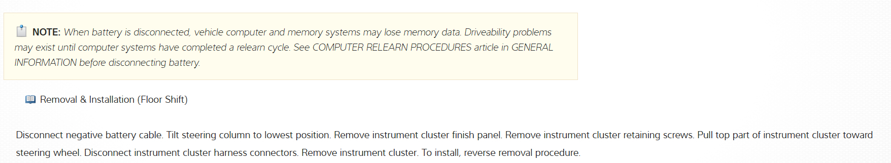

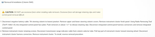

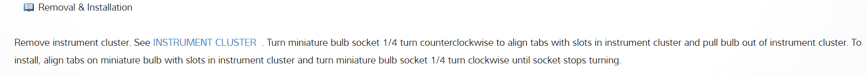

This could be a burned out bulb in your instrument cluster. I have included instructions and a wiring diagram on how to replace the bulb down below in the diagrams. Let us know if we can help with anything else.
