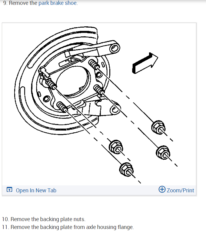

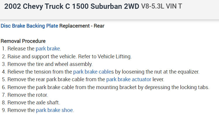

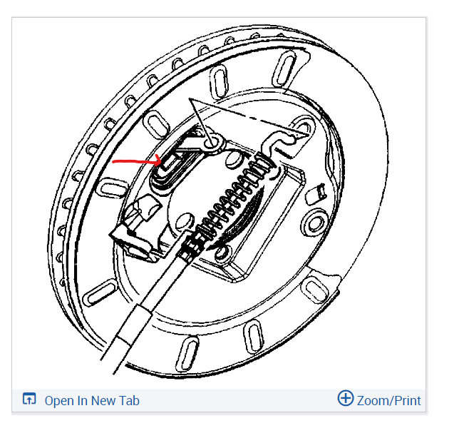

Replacing the back passenger side rotor, brake pads and caliper and emergency brake actuator. Parking brake lever boot is torn and partially missing. How do I remove it from the brake backing plate so I can install a new one?
Oct 16, 2024 at 2:15 AM
  • 55,784 POSTS
That is part of the backing plate, you will need to remove the parking brake cable from the wheel to remove the boot, here is how the job is done. Check out the images (below). Let us know if you need anything else.
