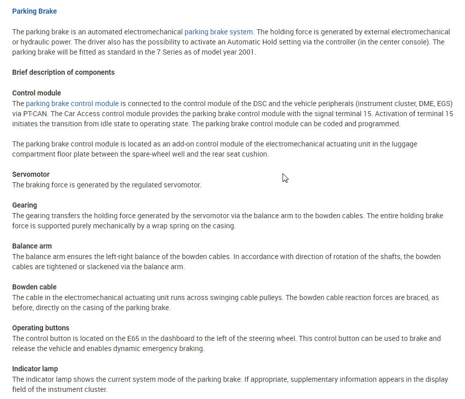

When this does not work, is there any indicator that it is not working? Meaning is there a message that says there is an issue or the light not come on? Or does everything operate normally but the brake just doesn't engage? In other words, how do you know it is not working?

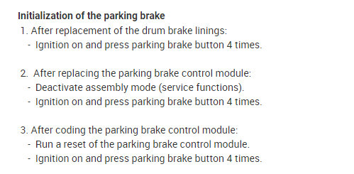

Here is the process from the manual on how this works and how to do the initialization process. Let's try that and see if it makes an improvement. Basically just press the parking brake button 4 times with the ignition in the on position but the engine off.
Let me know what about this info and we can go from there. Thanks

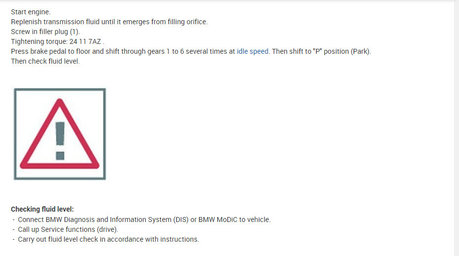

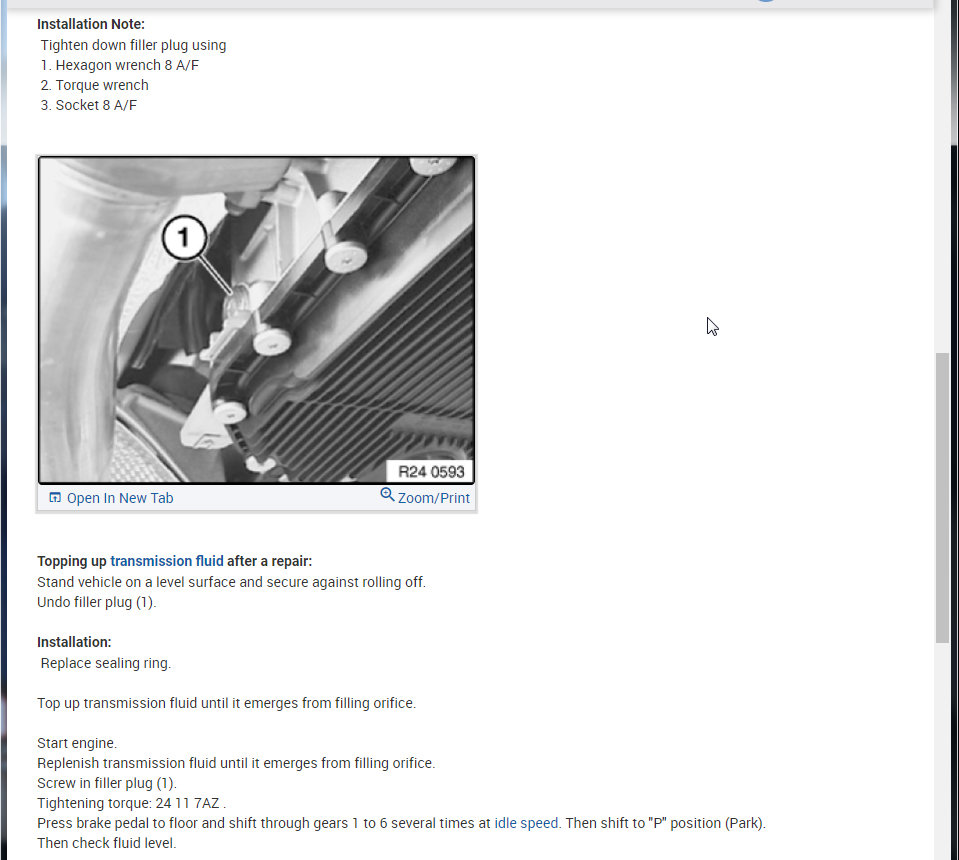

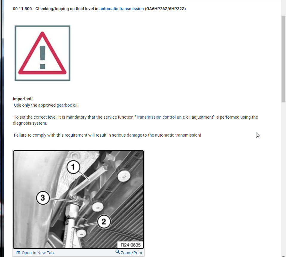

This could be a couple things but I would start with checking the fluid condition and level. I attached the process below on how to check the fluid level but if this park lock is not engaging then it may be this simple which would explain why it works at times.
