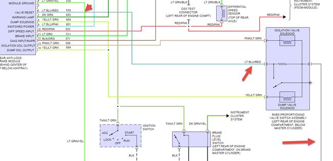

OK, Hi all,
Another problem having trouble correcting.... going through the code 4 testing all was checking out till got to number 5 were is says - Measure resistance between anti-lock electronic control module harness connector Pin 6 and chassis ground, there should be a reading of greater than 12 ohms well I get nothing and it says to find and repair the ground short along Circuit 535 (LB/R). Well check wiring and all appears to be good. So if anyone knows were to look for this ground short in the circuit please let me know.
Thank Gang
Mark

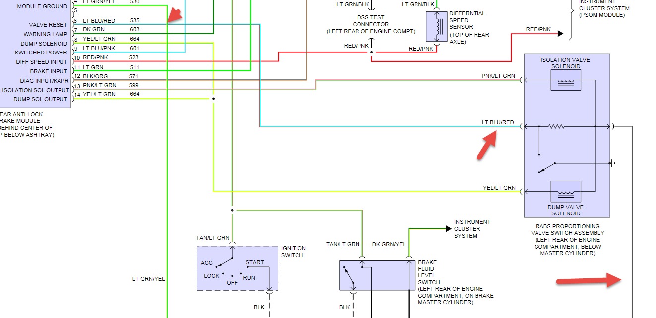

HMAC300
  • 48,601 POSTS
in pic check ground for pin6 harness wire to where I've pointed out to switch below master. if it shows zero on ohms then it' s good til there(harness) then check black wire to ground on fender or battery if that is good then I'd say it's the switch is bad. just looking at the diagram.

OBXAUTOMEDIC
  • 3,715 POSTS
OK, Think I did that once or twice, have gone over it so many times. But will check it again once I get a day it's not raining.

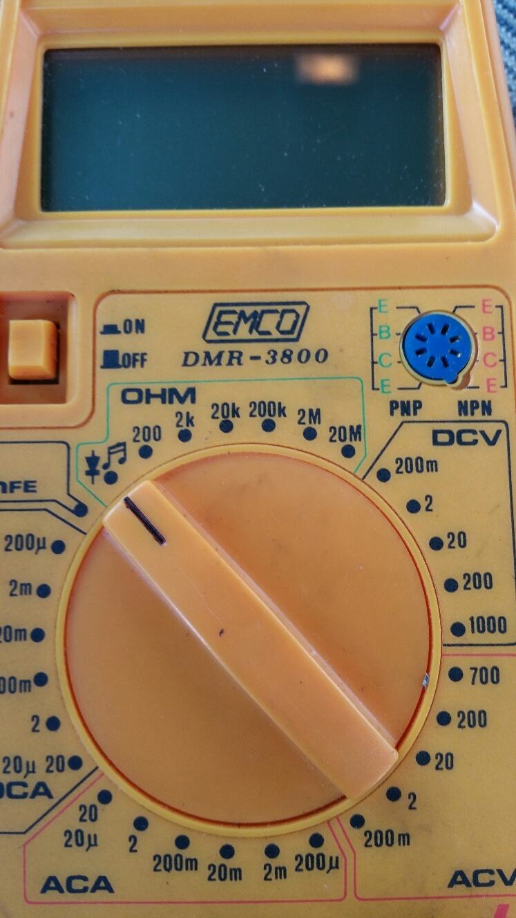

OBXAUTOMEDIC
  • 3,715 POSTS
OK, So I get 0 readings when checking harness pin 6 at module. So I'm taking it since that checks out good and the ground checks out good that the ABS Hydraulic Assembly is the culprit. Also here is a pic of my DVM and OHMS Scale and everything I read said to use the 200 ohms scale

OBXAUTOMEDIC
  • 3,715 POSTS
OK, part finally can in and put it on and lights are off.... Thanks for all your input and Mitchell1 needs to correct the test procedure.
