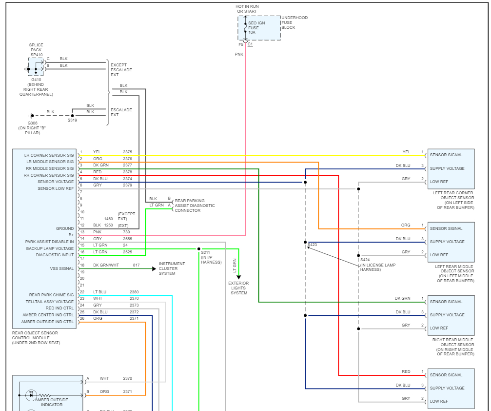

Any idea how I should approach the upra system not having any power? I shorted the connector under the rear seat to put it in diagnostic mode which wouldn't work because of no power.

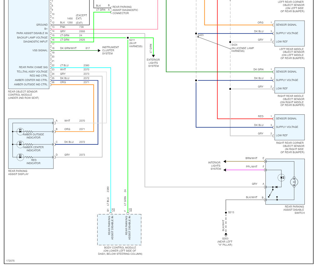

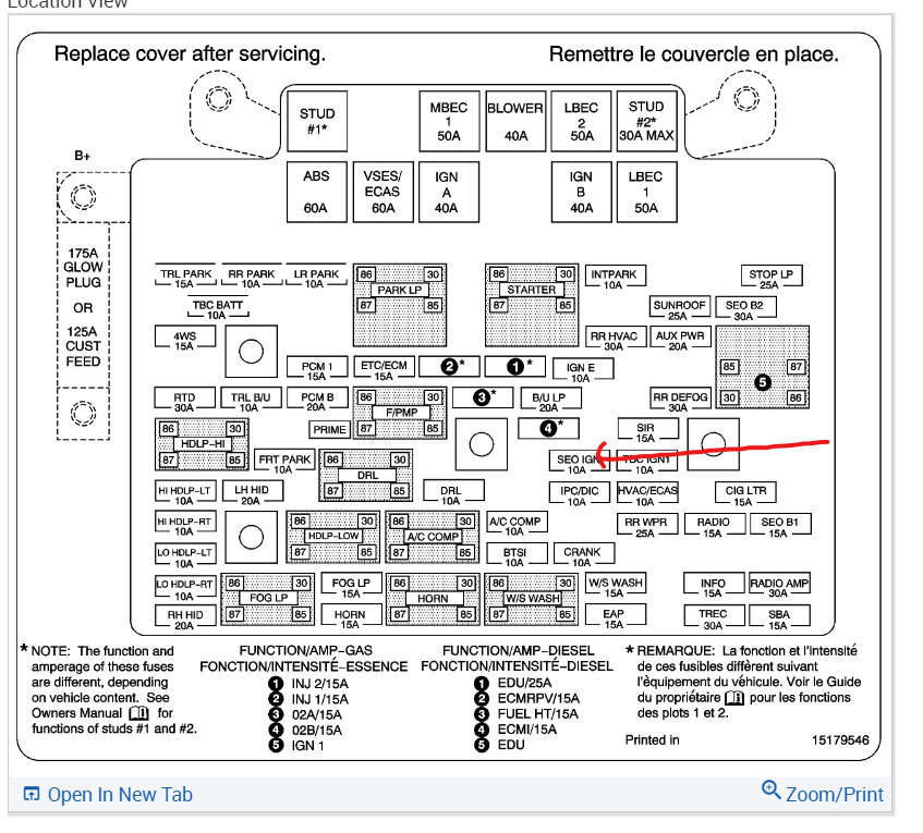

Thank you. Okay let's check the fuse SEO IGN under the hood, here is a guide that can help:
Here is the location of the fuse and the parking assistant wiring diagrams so you can see how the system works. Check out the images (below). Let us know what happens and please upload pictures or videos of the problem so we can see what's going on.
