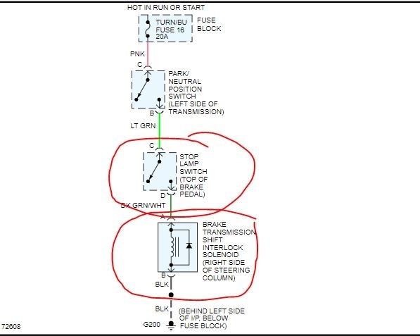

I replaced the power brake booster and the stop light switch. now it wont come out of park even with the brakes applied and the parking brake off.

Are the brake lights working? Take a look at the schematic I attached. It shows power from the brake light switch is what releases the interlock solenoid. Let me know if the brake lights are working, if there is power to the brake light switch (which there will be if the lights are working), and if there is power to the interlock solenoid.
Let me know what you find.
