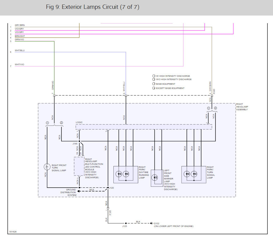

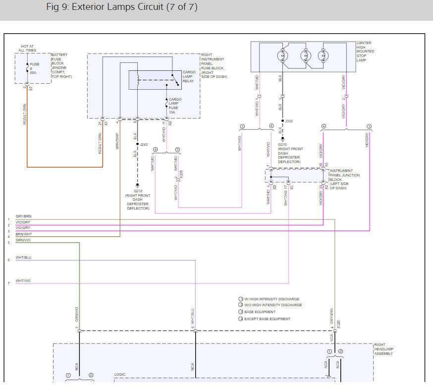

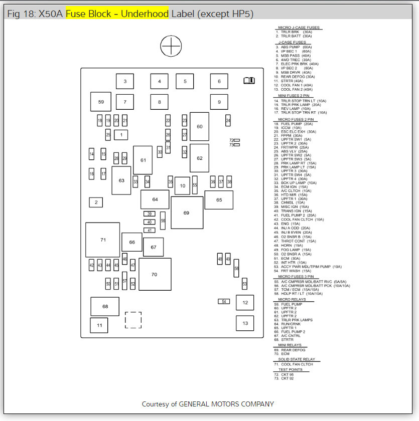

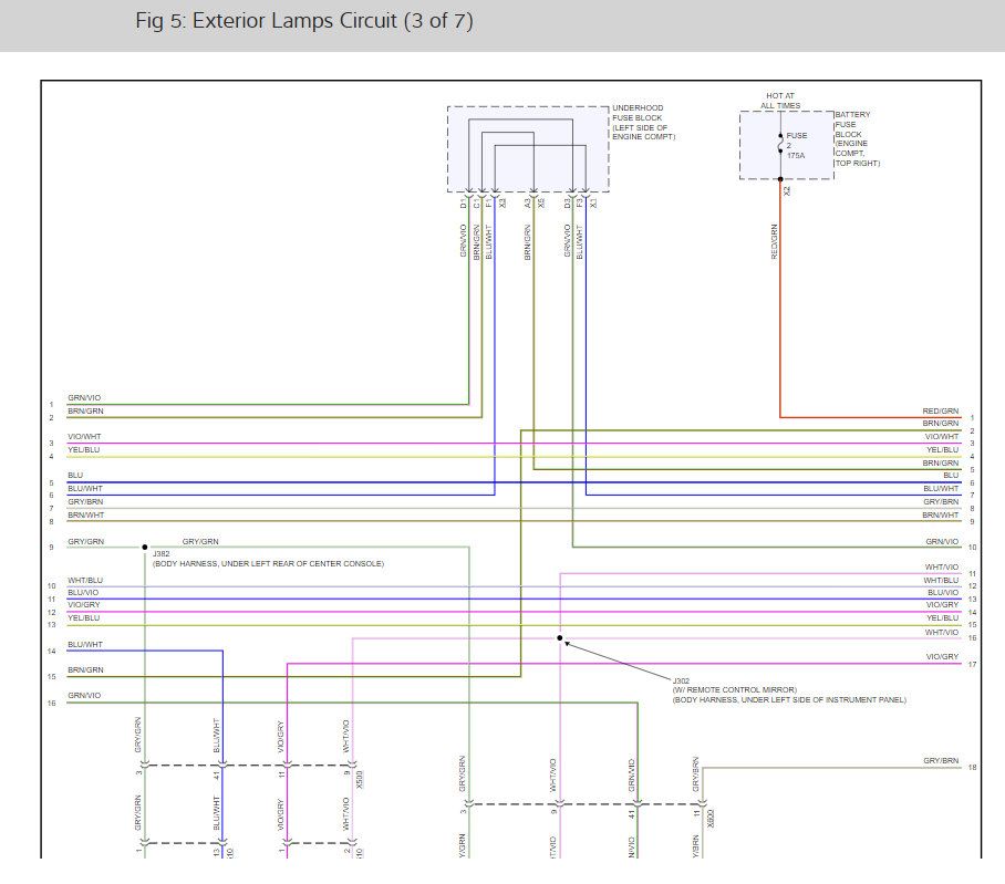

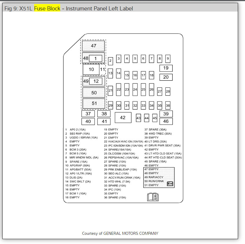

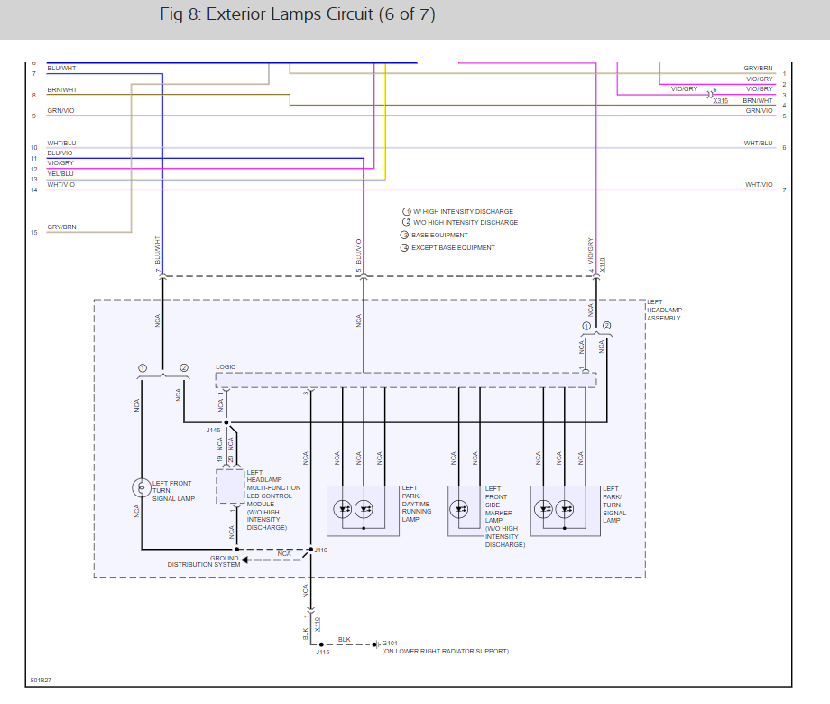

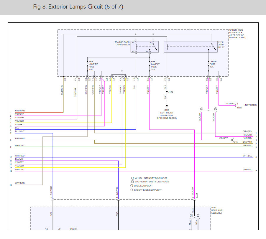

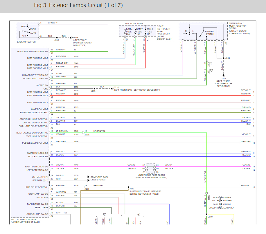

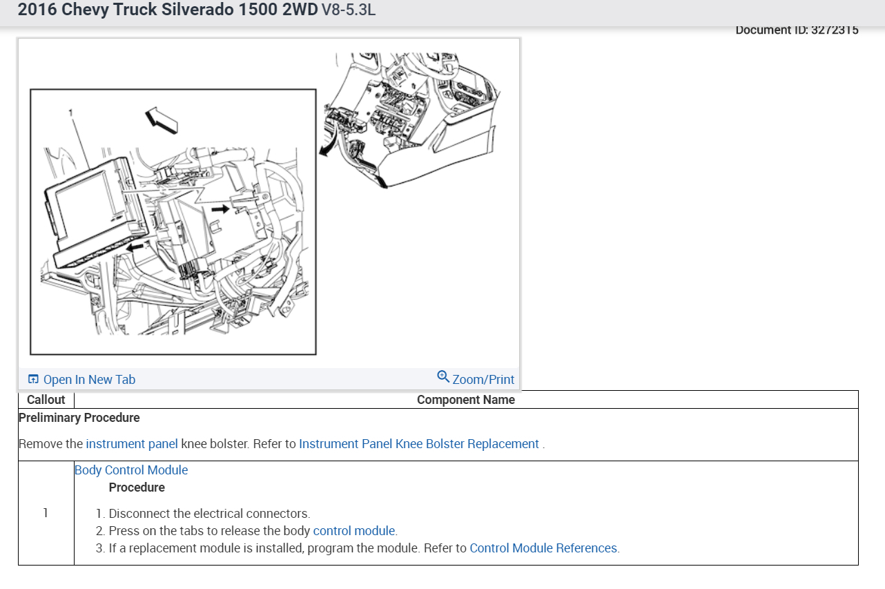

Shut engine off and park lights remain on and will not shut off.
Sep 8, 2019 at 12:23 PM
  • 55,423 POSTS
Hello.

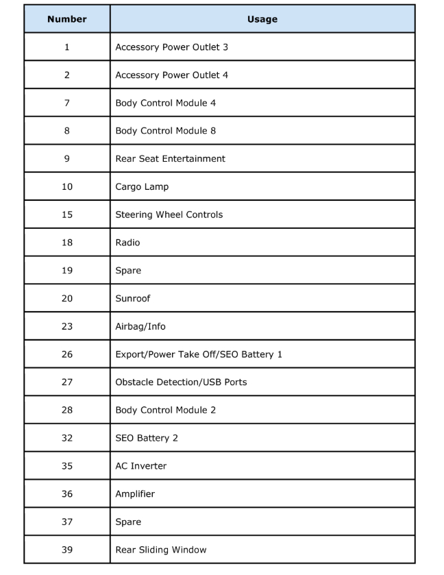

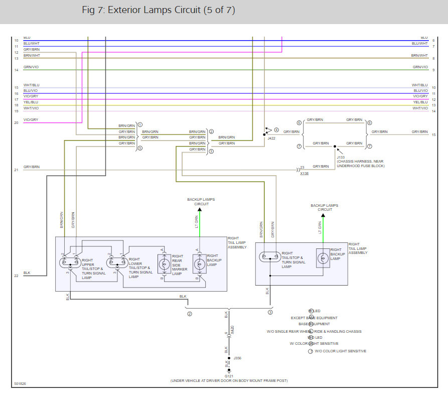

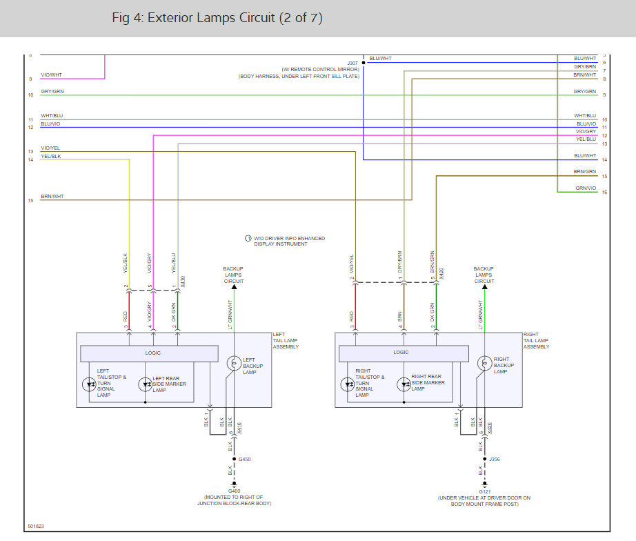

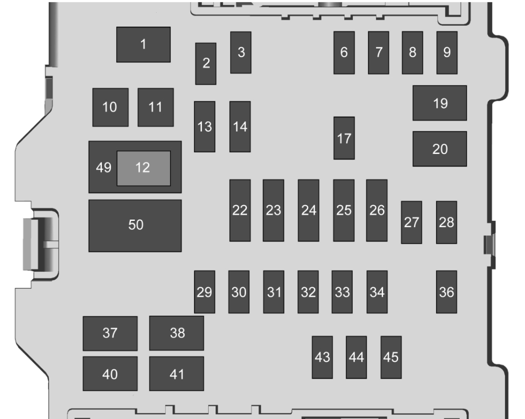

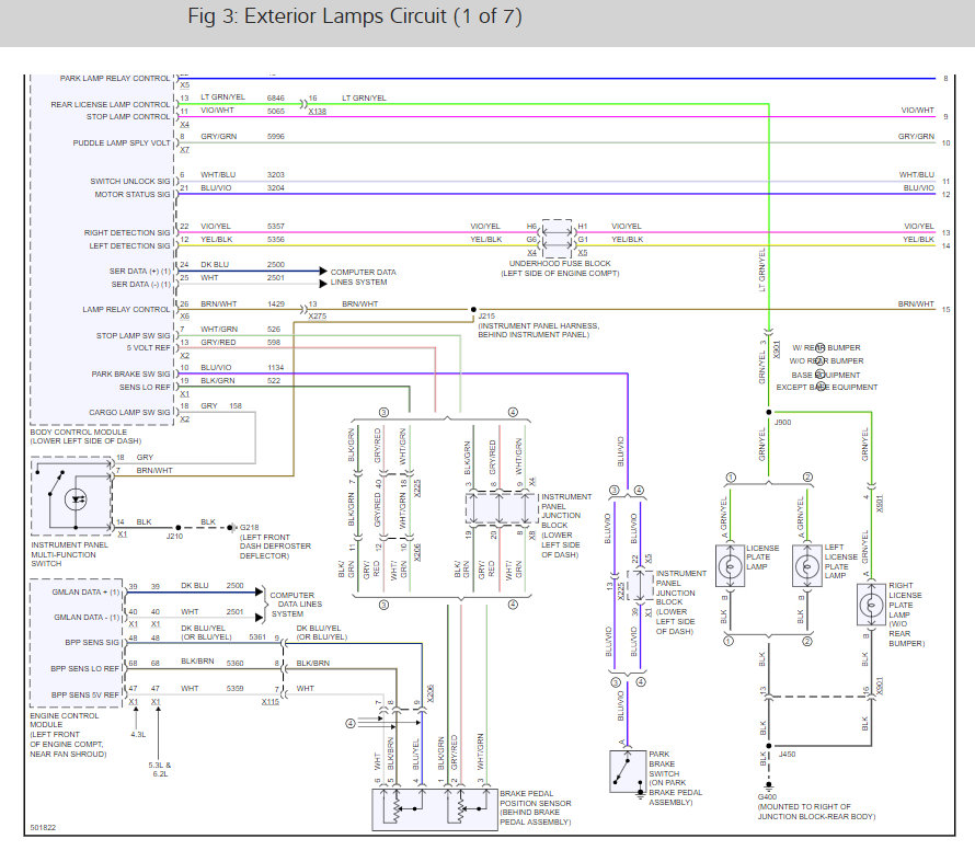

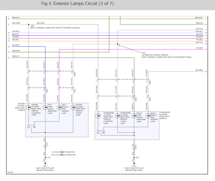

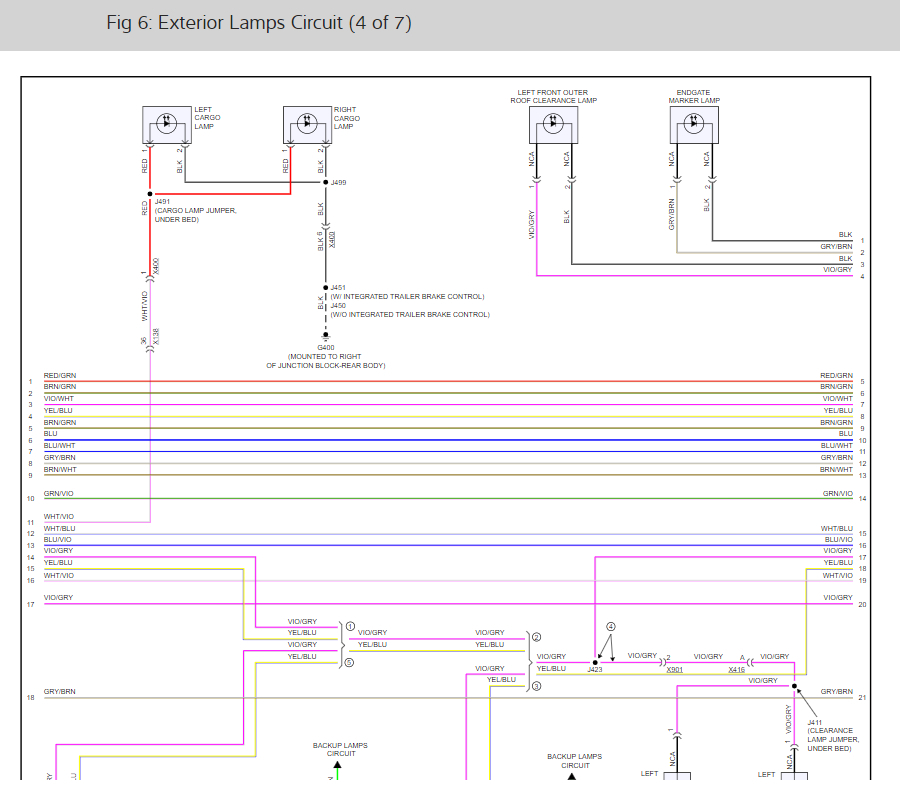

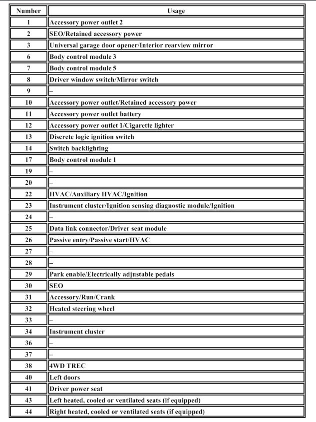

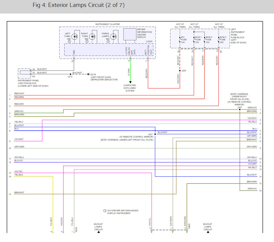

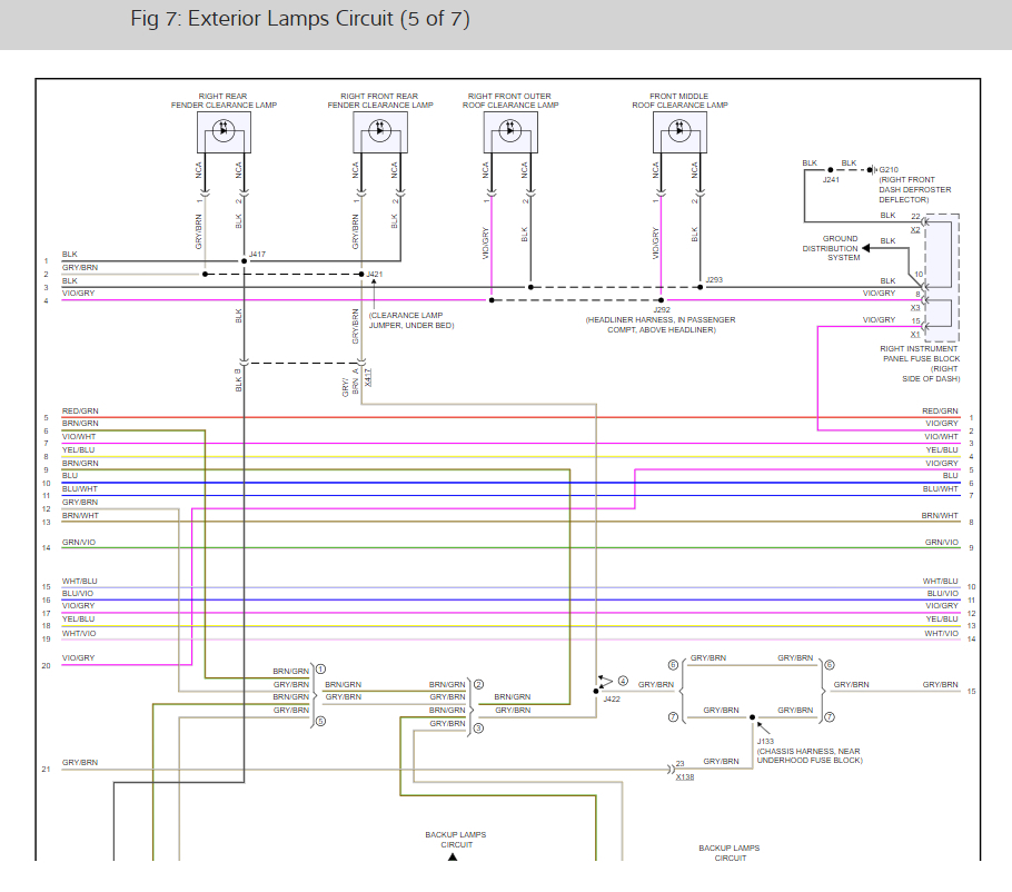

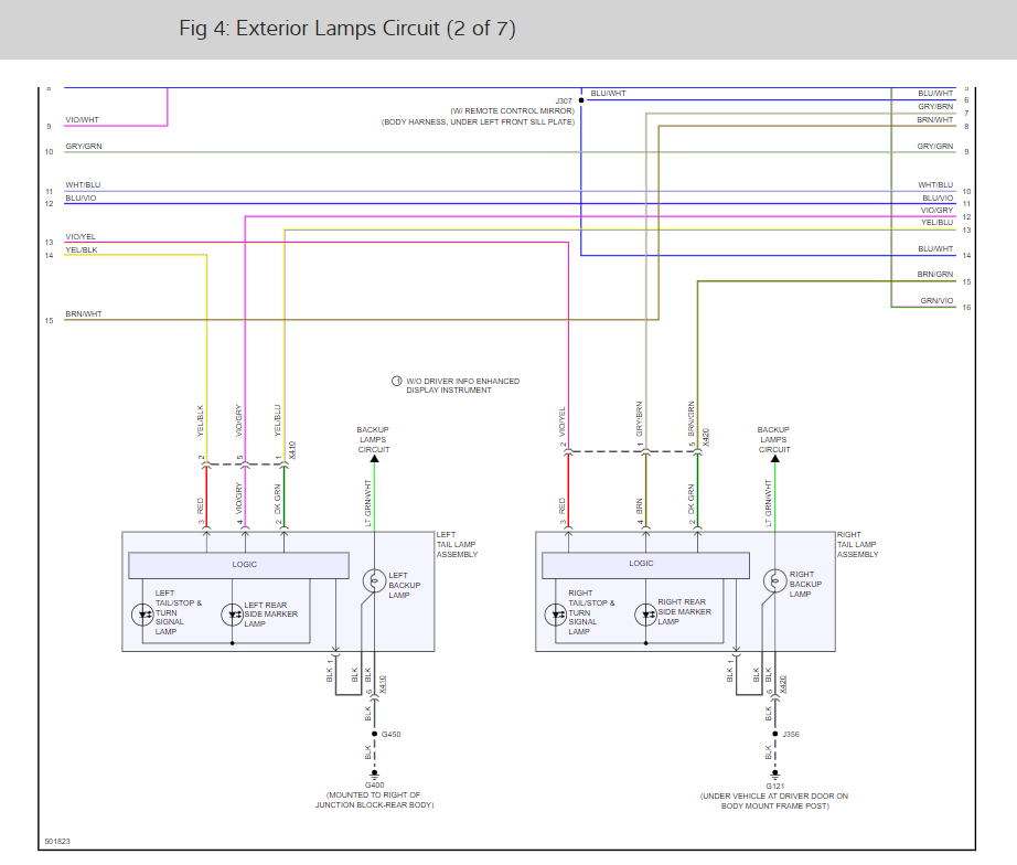

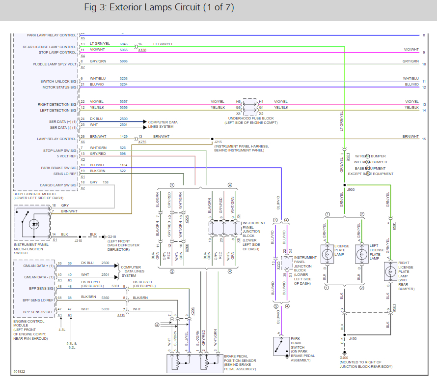

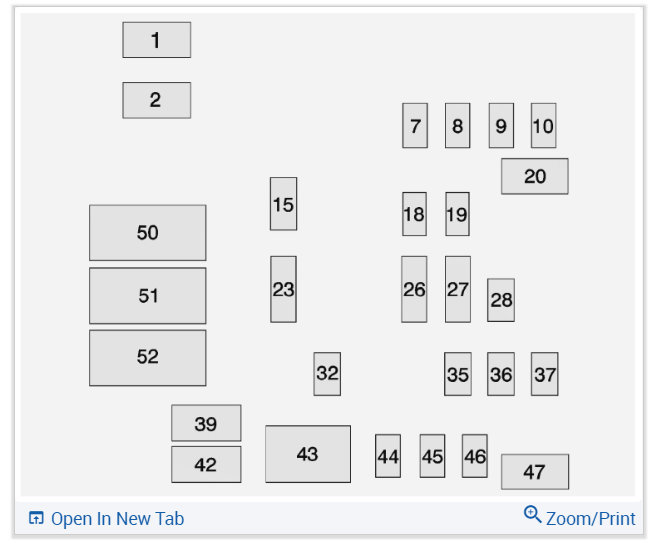

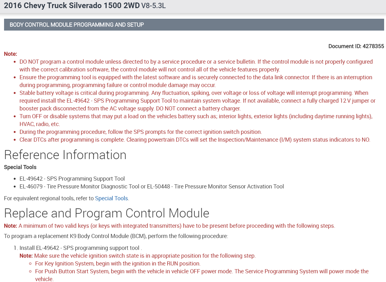

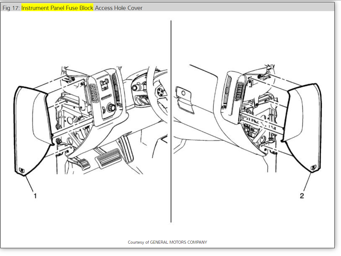

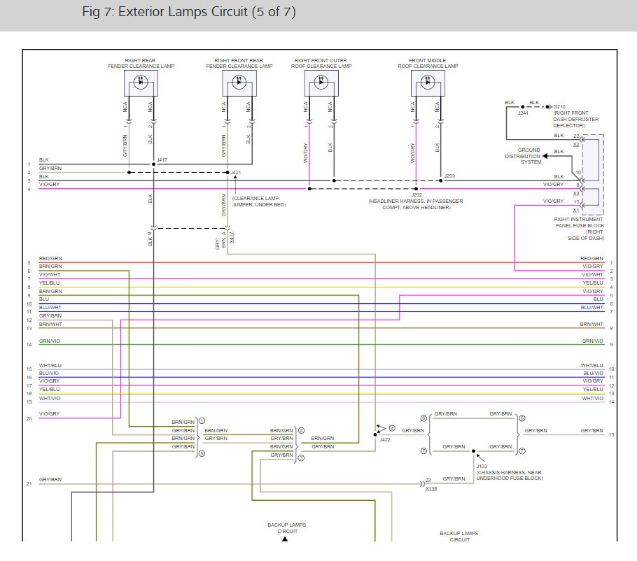

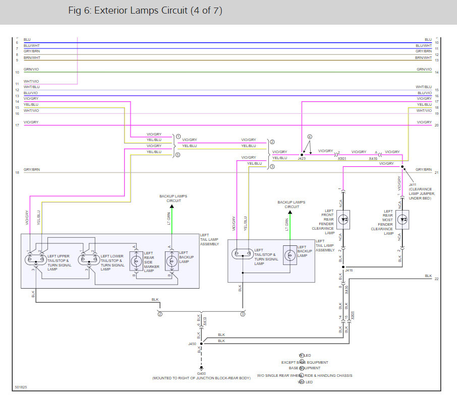

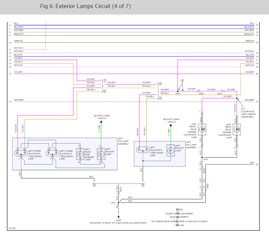

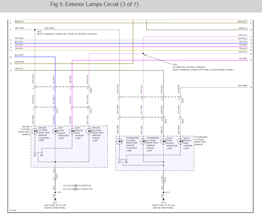

There is a park lamp relay we need to check and a handful of fuses. here is the relay location and a guide on how to test the relay with the fuse locations and a guide to help check for power there. I have also included the running light wiring diagrams so you can see how the system works and which fuses to check in the diagrams below.
and

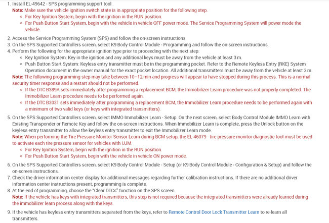

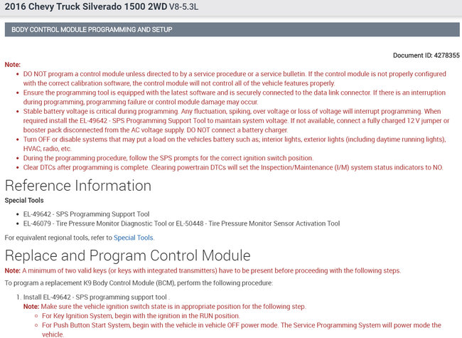

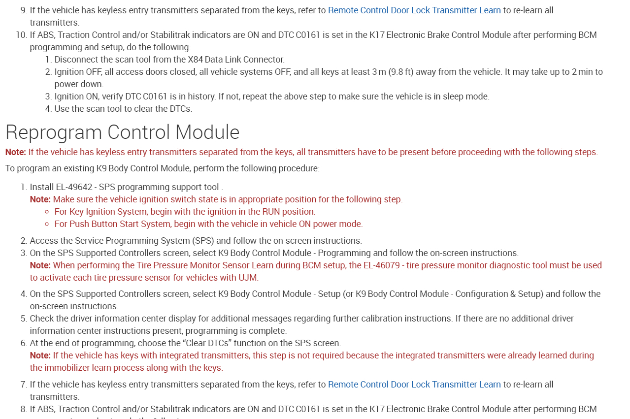

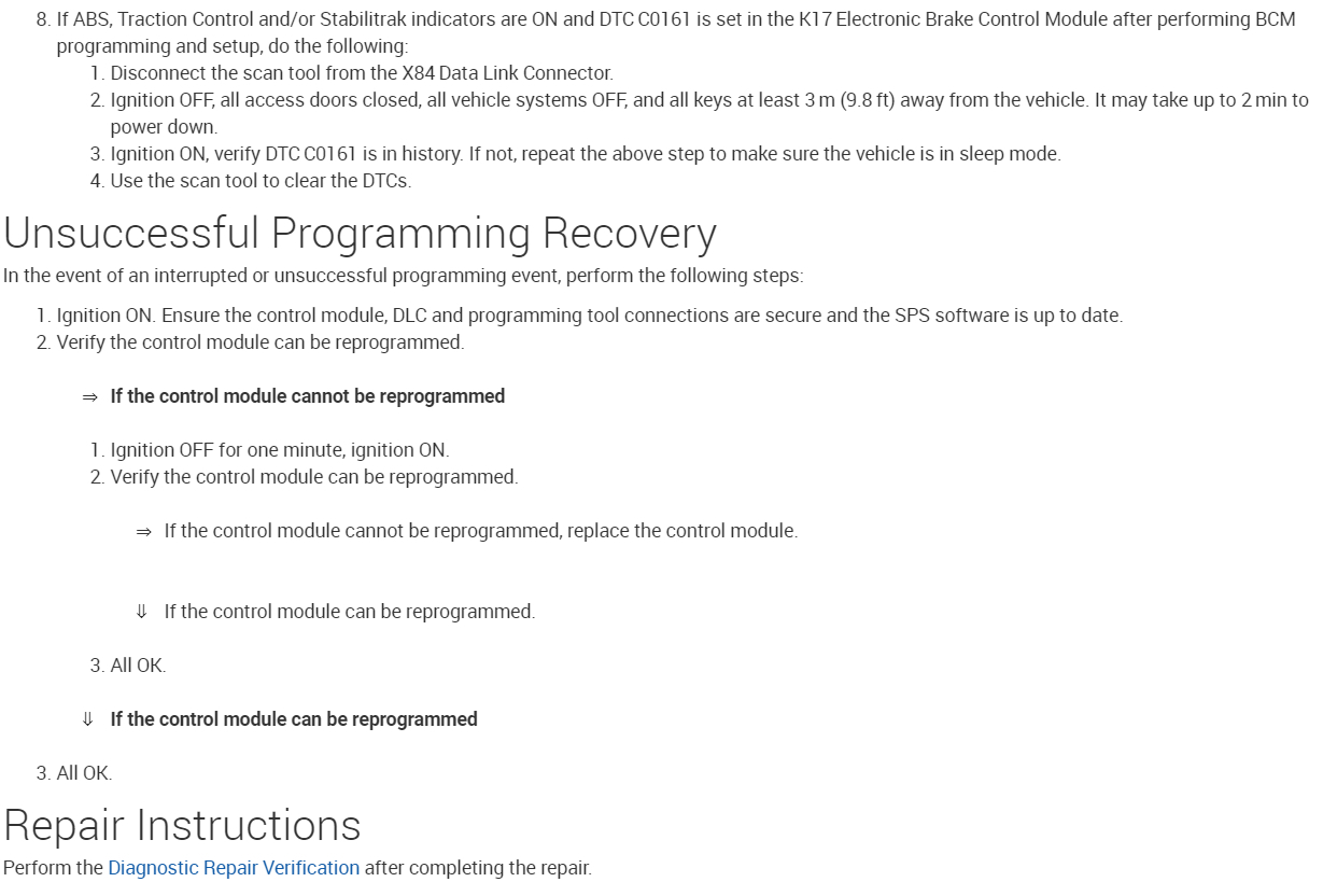

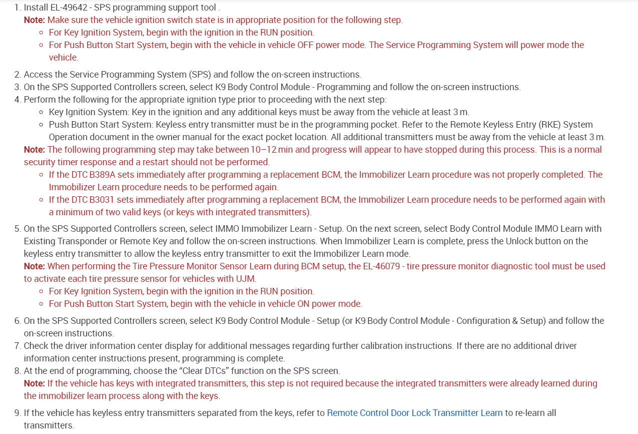

If the fuses and relay check out the BCM could be going bad I have included the replacement instructions for that as well.
