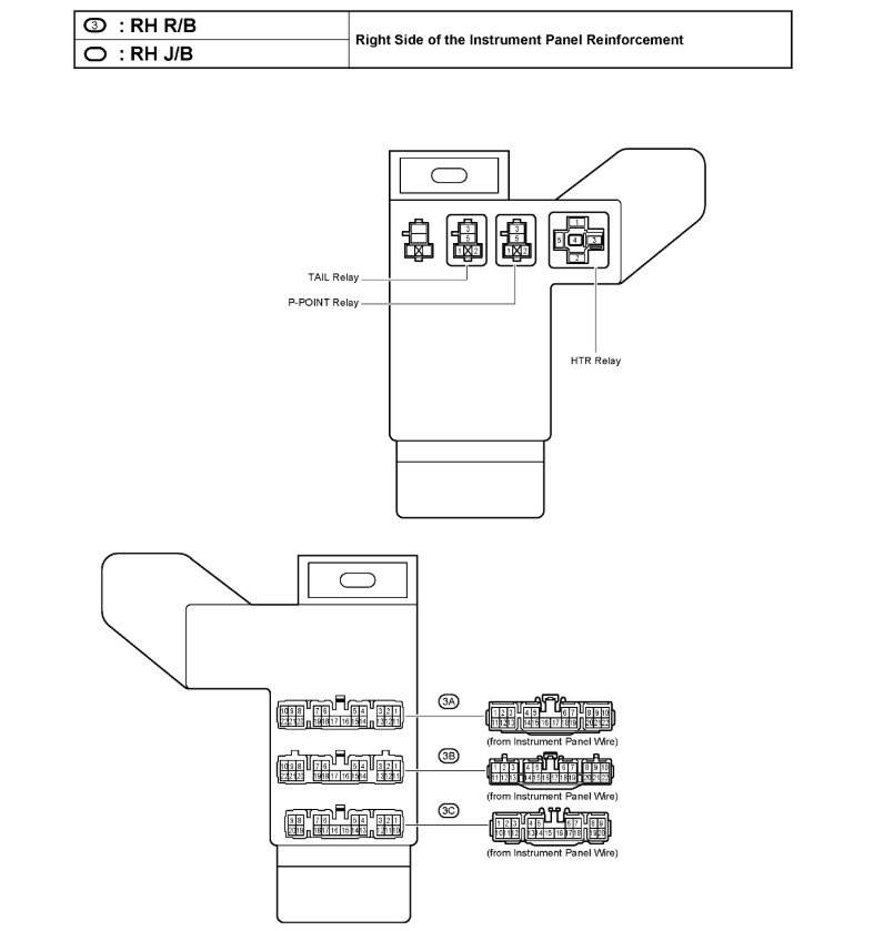

I have a 2008 Toyota Corrola Altis Professional and the park lights at times they work and at times they don't work. What could be the problem?? I also have a problem with the A/C, it only works when it is summer and in winter heater doesn't work. what could be the problem?
Jun 11, 2019 at 5:20 AM
  • 55,447 POSTS

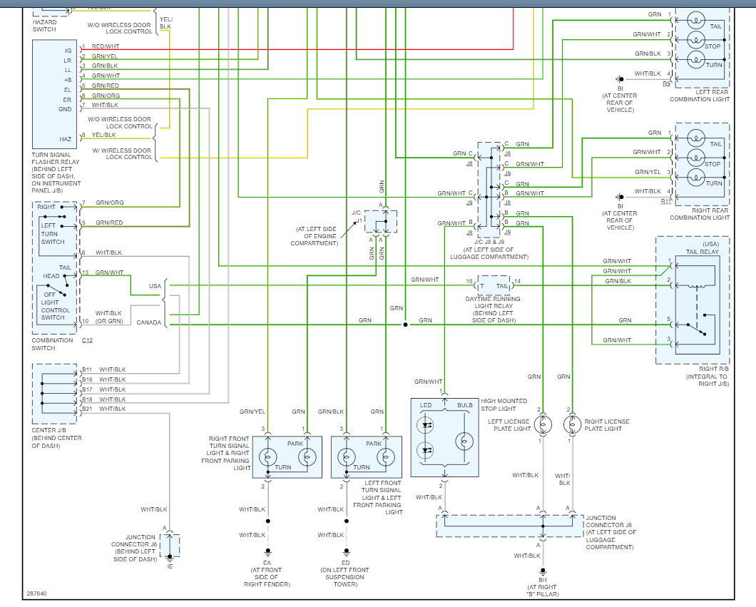

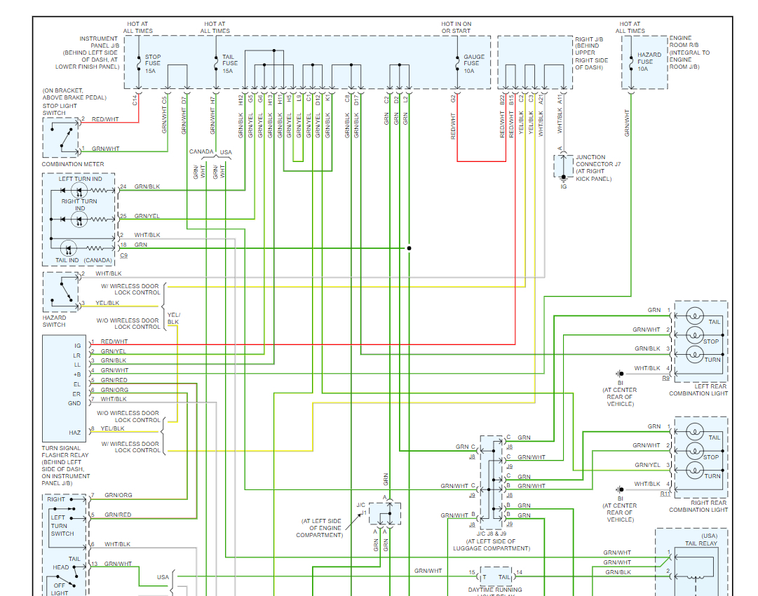

We must handle one problem per thread this one will be for the parking light issue please re-post the AC problem on a new question. It sounds like you have a taillight relay that is weak and needs to be replaced. To confirm here is a guide to help check it with the location of the relay and running light wiring diagrams so you can see how the lighting system works below:
