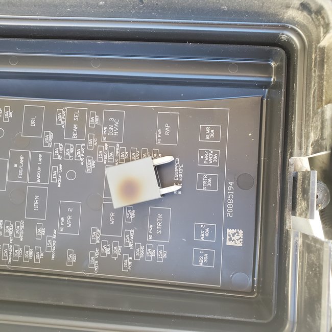

I believe I found the problem this is the PRK/LAMP labeled 15328866 that I pulled out and I sent a pic for you to see.
Dec 1, 2019 at 3:36 AM
  • 110,251 POSTS
Sorry I missed your questions. I wasn't online at that time. The fuse you show in the pic looks burnt. Have you replaced it and has it fixed the problem? That appears to be the relay that I mentioned in one of the prior threads. Let me know if that took care of it for you.

I changed the relay but it didn't fix the park lights, I'm going to try to disconnect the battery to reset the BCM body control module and see what happens. I did a lot of reading and I think that I may need to replace the BCM. What do you think?

The relay I changed is new and the guy at o'Reilly tested all the fuses in the fuse box under hood along w the relays and all lit up but they had one 15amp fuse that was for rear backup I believe that wouldn't light up but the fuse was good. We checked to see if when I put the truck in reverse if the reverse lights worked and they did. The guy also put the tester to where the park lights plug in and there was no power going to it, but there was power to the signal lights that are right next to the park lights.

There really isn't a lot left. Have you confirmed that the ground wasn't damaged? If you look at the attached pics, (I had to break the schematic into several parts) you'll see that power goes via the switch to the body control module. When you turn the lights on, power is sent via the switch to the BCM and the out of the BCM to the park lamp relay. From there it runs to the front parking lights and finally to ground. Since you have no power at the light socket, it can't be a ground because you provide a new ground with a test light. So the problem is before. At this point, you need to work backwards. We know the fuse is good and has power, so the break has to be between the fuse and lights.
If I had your vehicle, I would start by checking and confirming that power from the fuse is present in the brown wire right at the fuse box. Note that it is provided by one pin but splits two different ways. If power is present, then you need to follow those wires all the way to the lights to determine where power is lost. Since you lost power on both sides, I would assume the problem is right at the box and no further.
