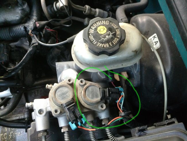

Park brake light will not go off, I have checked the switch, if I take the plug off of the rear abs solenoid and jump the wires across the light will go out, is it possible to replace that solenoid on the abs, would that solve the problem? Thanks Mark

Can you post a picture of what you jumped?

That is a very early model ABS system.
See if any of the parts stores can read the system for a fault. There should be a fault code stored that will help narrow the area of failure.
One thing you can try. Remove the connector for the level sensor in the brake fluid tank and jump it with a paper clip and see if the light goes out.
