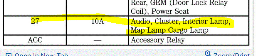

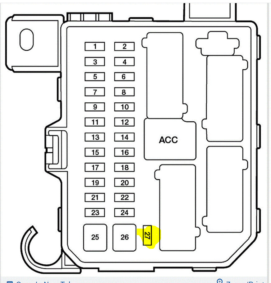

Tested for parasitic drain in circuit with negative battery cable finding 0.10 Amps. Further diagnosis finding btn#2 at battery junction box removed fuse removed brings amps to 0.00. also fuse #27 in cabin fuse box when removed also brings amperage draw to 0.00 amps. I'm showing #27 10amp fuse controls : GEM, Audio, Cluster, Interior lamp, Map lamp, Cargo lamp, . My question is, how do I find which item is causing the power drain and how to test each item in circuit? A huge thank you to all mechanics and 2CarPros and owners for your help and assistance you don't get enough praise or thanks for what you do .Thank you all! JJ

I looked up the fuse number to confirm what fuse 27 powers. Take a look below at pic 1. Pic 2 shows fuse 27, just to confirm.
Here is what I suggest: I would disconnect one component at a time. For example; disconnect the radio and see if that changes things. If it doesn't, disconnect the instrument cluster, lamps, and other components powered by this fuse. If you remove a bulb, it opens the circuit and will help narrow things down for you.
