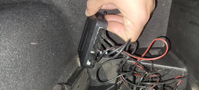

Car is honda civic 8th gen FK2 europe version. Battery died over few days, found out that it had big parasitic power drain.
Started to pull off fuses and it was fuse #16, 15A, under a bonnet, about 0.40A. In manual its says its "back up" fuse. When fuse is out, central lock system and radio doesnt work.
When I tried to pull fuses from inside under the steering wheel, while fuse #16 was in, to maybe narrow it down, but nothing changed.
Disconnected each actuator, one by one, thought one was gone bad, found nothing.
Tried different key, thought it was sending constant signal to car, but it was not it.
Found out, that these civics have problem with bluetooth modules that can drain power, but my civic doesnt have bluetooth, navigation or hands-free system.
Dont know where to look next and no more information on internet.

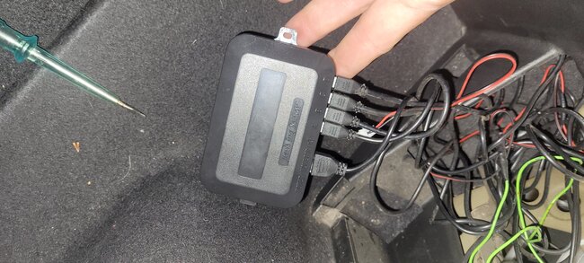

After reading about aftermarket parts you wrote, I remembered that car has rear park sensors that look like they are not original. I found main module and disconnected it, and bingo, power drain dropped to normal. Funny thing is, I tried to dissasamble that module to see its name, so I can buy new one, but didnt found it, so I just connected it again, and theres no more power drain. Interesting. I think its good idea to replace park sensor module anyways, but dont know if its enough to change only module and not whole system with park sensors. Maybe you recognize it?

I can look the vehicle up by the vin number to see what modules its supposed to have. But yeah that's not an oem. There isnt any numbers or names on it anywhere?
That is if that vin number even comes up here, but Ill try.

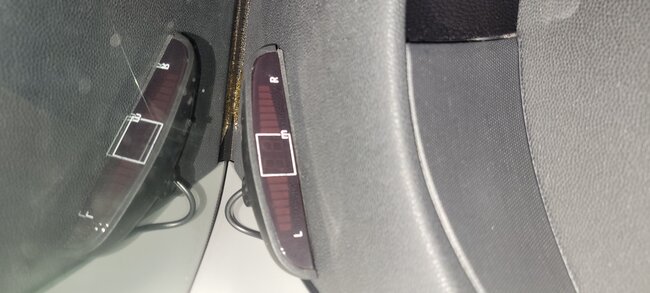

Is there another display besides the L-R graph looking display (pic 2)?

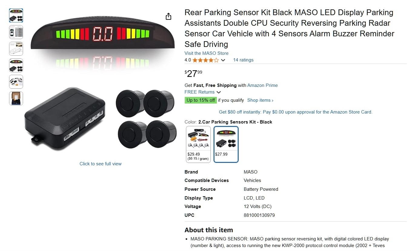

Well that wasnt too hard to find, and yup its an Amazon special...
If youre going to go with this module again, I would put it on its own fuse so if there is another draw issue you can go right to that fuse to check it.

Yeah, just this one display in pic 2. No numbers or letters on module, nothing. Alright, I mean it looks easy to replace, just connect wires to new module and thats it? Or maybe its the sensors in bumper that is faulty? Best option should be to replace whole park sensor system somehow. It could be possible with module and sensors, but display is so far in front, under all that plastic. Is it possible to put parking system on new fuse on my own, any tutorial on how?

This kit it comes with has all new sensors and it looks like the same plugs on the module, just need to make sure its the same model. Looks pretty close. So you wouldnt have to run new wires for the display. Does the current one not work at all? Its not a high tech device or anything, it just uses proximity sensors to detect a close object and transmits that data onto the display to tell you if something is close on the right or left, actually pretty simple. $30 and you get the whole kit, but these are the cheap kits that may not last as long as you would like. As for running it to its own fuse, that would be a little difficult from my end since I cant locate a correct wiring diagram for this car. Like I mentioned I can look up the vin number but it may not bring up the correct power distribution diagrams.

I mean its working fine, maybe just a display is not showing digits correctly, want to change that too, but that wire from display is going all the way from front to back, dont want to break any more plastic taking it out lol. Anyway, I'll order that sensor, looks pretty much identical.
