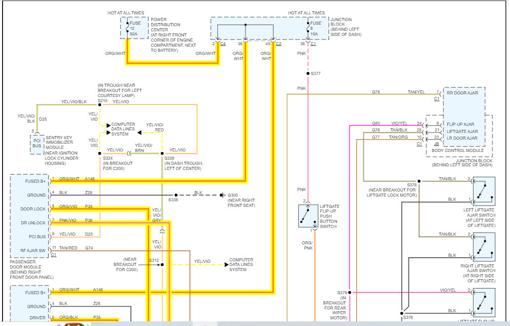

Hello, I'm having an issue with my battery draining overnight. I'm getting current draw from fuse #7 inside driver side compartment fuse block. I was wondering how do I pinpoint the draw when the fuse controls multiple components. One of which is the BCM which controls multiple components. Any idea what could be the culprit?

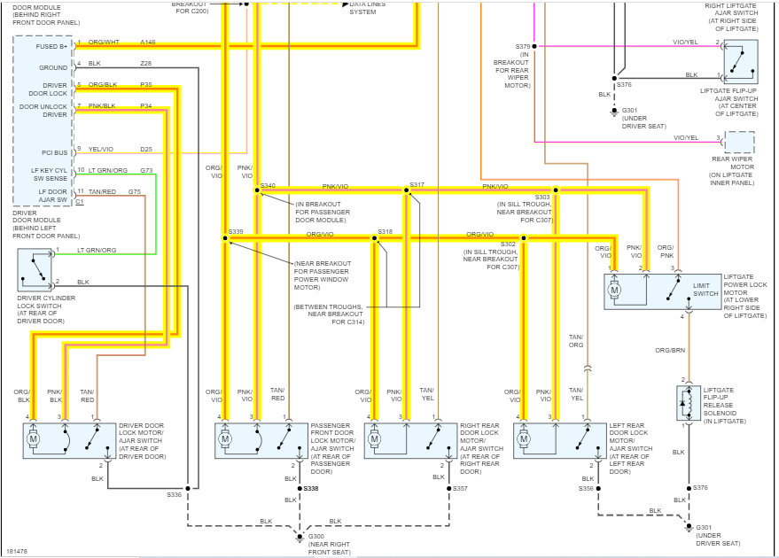

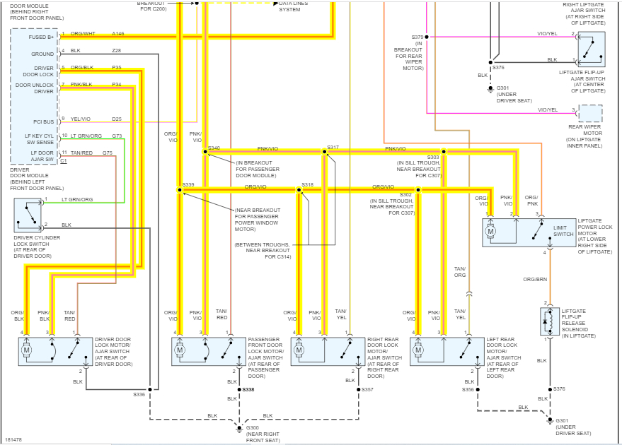

It could be the DDM. I looked through the schematics and there are splices, but power all comes from the same fuse. Also, they share the same ground except for the left rear.
I attached the wiring schematics below so you can reference them. Note there are three wires at each lock actuator. The one I didn't highlight is the door ajar switch. The actuator either locks or unlocks based on polarity. If you send the power in one direction, it locks and the opposite.
Also, you may want to scan the can-bus. CAN stands for controller area network. Basically, the modules are tied together via a few wires. This type of scan will provide codes regardless of the module storing them. Here is a link showing how it's done.
Let me know your thoughts.
See pics below. Note: I had to cut the schematic in half to make it readable for you. I did overlap the two so you can follow from one to the next. Also, I highlighted all wiring related to the door locks for you.
