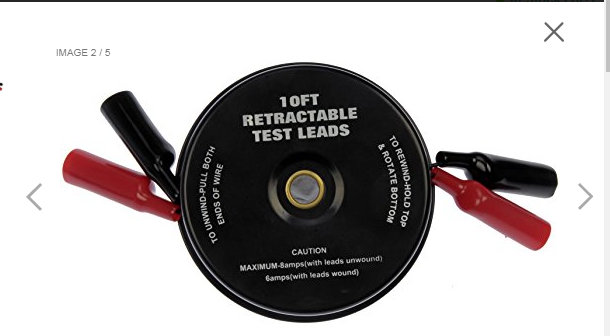

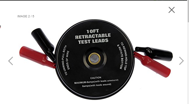

Two options. First, you can pull one fuse and then walk back and check it each time. This can get old quick. The option I would choose is to get a retractable test lead reel. Then unhook the battery for the test and connect the alligator clip to it then run that up to the front of the vehicle and connect your meter so you can see it.
If the alligator clip will not grasp the battery post because it doesn't open wide enough, just connect a set of vise grips to the battery post and then clip the alligator clip to the vise grips.

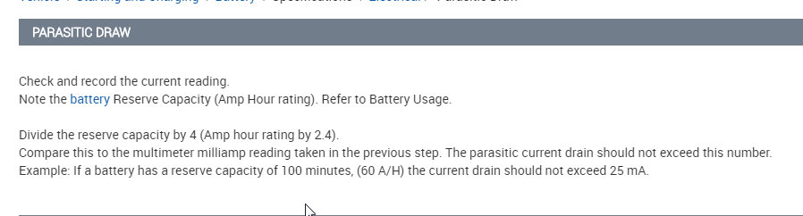

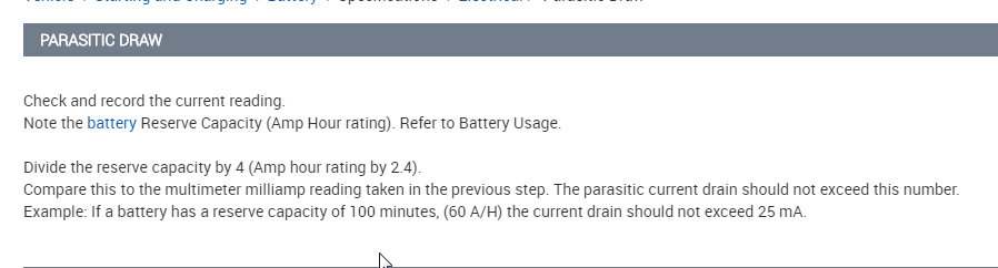

As for the measurement. A properly operating vehicle will have a draw around 25 millamps or lower. So if you still have 100 I would think you will still have issues. 100 milliamps will drain a battery in a night or two. I attached the picture of what I am talking about and the spec on your vehicle's draw.
