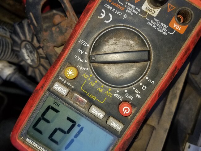

I have a parasitic draw and have found roughly where I think it is. When i close the right rear Dutch door the VTM goes down .90 mA then will slowly climb back up to 1.22/1.23 mA I have pulled all bulbs in the rear lights no change when I do get the draw to drop I can push the rear bench seat up and down buttons the draw will climb bac up rapidly I have disconnected one of the 2 switches for the seat has anyone experienced this need help trying to figure this out. All lights in rear are unplugged and have pulled all fuses and no change to the draw it does have an added trailer light hook up as well Any ideas where to look and none of the other doors effect the draw when they are closed I have moved and check all wires it the general area without accessing the side panels.

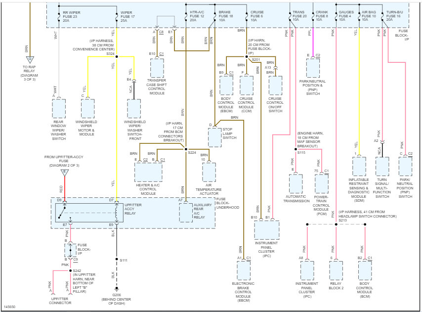

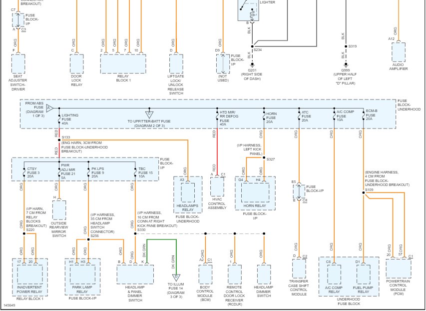

When I personally have a parasitic draw, I start under the hood of a vehicle at the power distribution box. With a voltmeter between the negative battery cable and the negative battery terminal, I remove one fuse at a time to see which one causes the draw to stop.
From that point, I review the power distribution wiring schematics to see what that specific fuse powers and move to one thing at a time there. If there is enough of a draw, you may find one of the fuses or relays warm compared to the others.

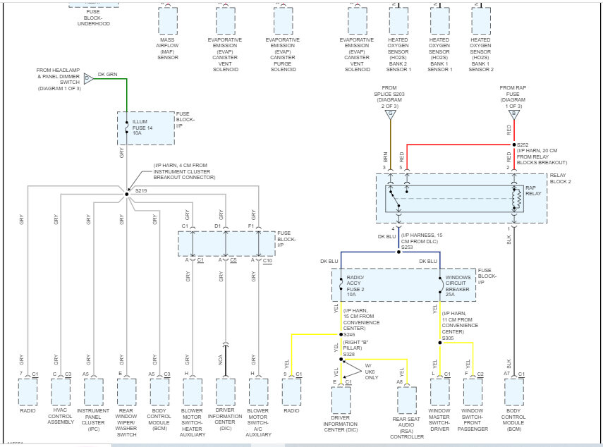

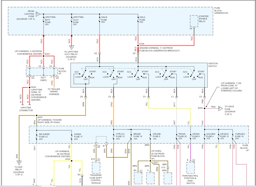

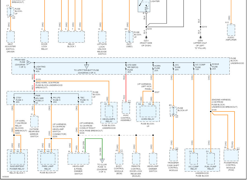

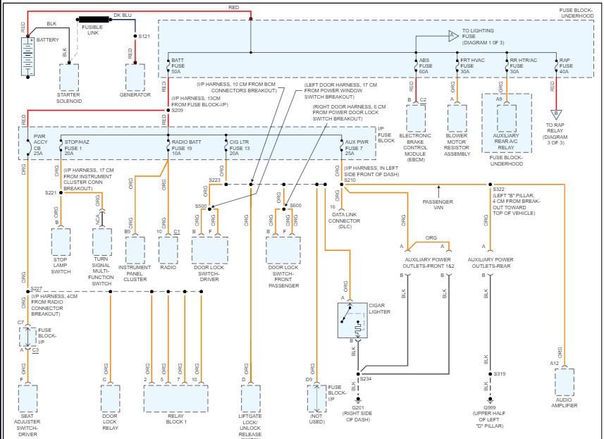

I have attached the power distribution wiring schematic below so you have a reference. If you want to try what I suggested, you will need it.

See pics below. Note: I had to cut each pic in half to make them readable. I did overlap them so you can follow from one to the next.

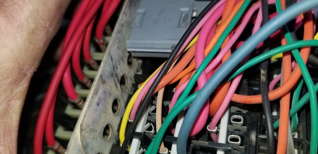

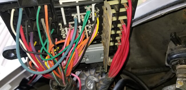

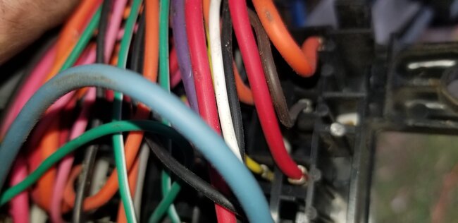

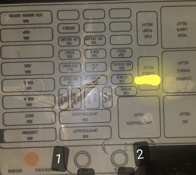

I am adding photos one is measurements I recorded from fuse box in the engine compartment all fuses removed and added one and removed them and went to next did notice at first. When I tried to leave each fuse in it would not show the same draw. So is why I added, and the removed wires marked 1 and 2 had no bearing. when I removed them will remove again if not raining tomorrow, tried to get the bottom cover off that box and failed didn't want to break it will try tomorrow weather permitting with different battery I do have a steady 1.12 draw with all fuses removed from the same fuse box.
Dec 5, 2022 at 12:06 PM
IAMWHOIAM
  • 18 POSTS
How to tell it is the fuse block nothing appears to be burnt to me.
Dec 6, 2022 at 3:47 AM
  • 110,244 POSTS
If there was an issue, most times the affected area will be dark gray or black indicating a short. In this case, I agree with you. The wiring actually looks really good.
Do this. remove the lamp in the glove box and see if it stops. I just read that there has been a big issue with the switch failing to turn that light off.

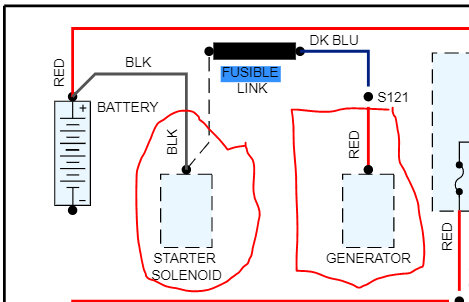

Also, and I'm sorry to ask, do I understand correctly that with all fuses removed, the draw still exists? If that is the case, then let's jump before any fuses are used, the starter and the alternator. See pic 1 below.
Disconnect the alternator to see if the draw stops. Note that the red wire on the alternator will have battery voltage at all times, so make sure to insulate it.
If there is no change, remove the heavy gauge black wire on the starter. The same thing is present there, power at all times. Make sure not to allow the wire to short.

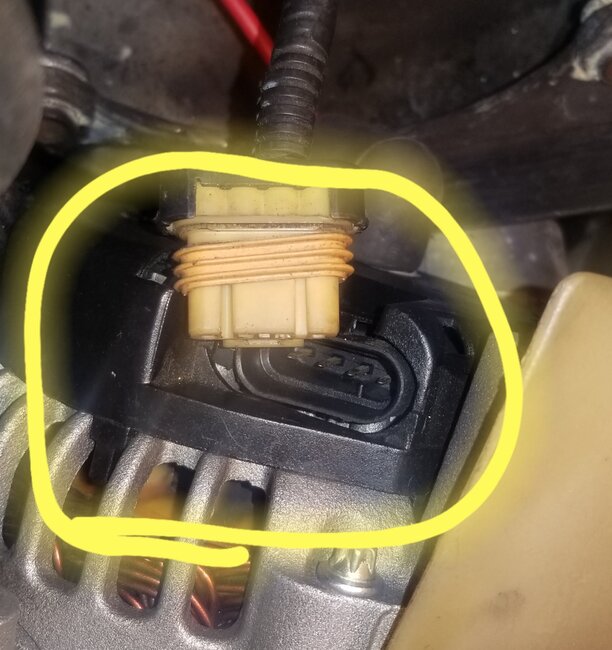

This is what I found today when I connect the wire plug to alternator my draw appears when disconnected it is gone.
Dec 9, 2022 at 9:49 AM
  • 110,244 POSTS
You found the source. Are there any damaged pins in the connector? If there isn't, the issue is most likely the alternator itself. We could have a faulty diode.
Let me know about the connector and closely inspect the wiring to and around that connector.
Let me know what you find.

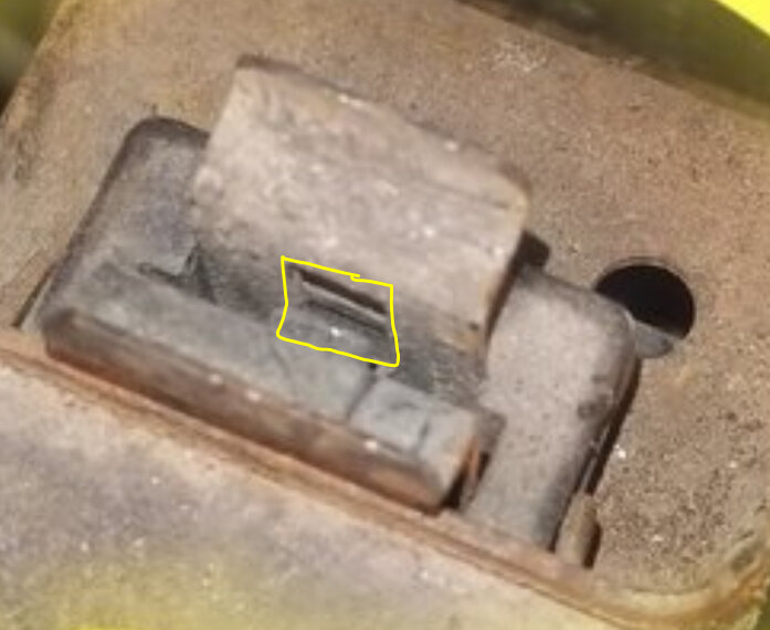

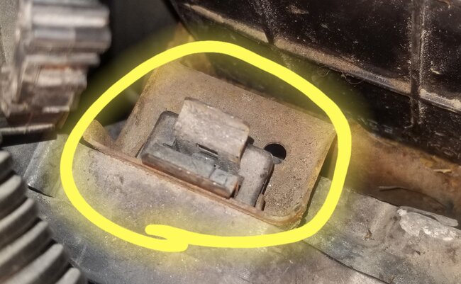

Can this possibly be the PCM reason for asking I unplugged it and the draw was .10 as soon as I plugged in the PCM it went back up I do have a PCM here that is swappable and if is possible that it could be the issue how do I get the metal clip to release so I can pull it out.
Dec 10, 2022 at 2:04 AM
  • 110,244 POSTS
I'm not 100% sure what I am looking at in the picture. The tab I circled below appears to be what would be pressed away from the tab and then pull up on the metal strap.

I got the clip figured out it was what held the PCM in had to push down and squeeze together and the alternator was not the issue I still have the draw as soon as I hook the exciter wire. The plug is not damaged nor is the wire.

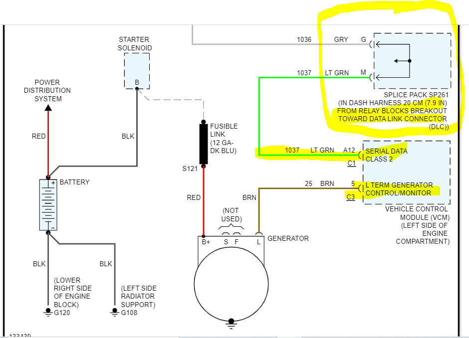

Also, I did take out the PCM and draw is still there but only shows when the brown exciter wire is hooked up.
Dec 11, 2022 at 8:37 AM

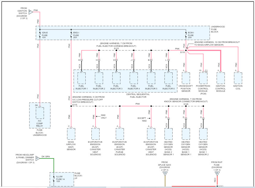

  • 110,244 POSTS
There is a splice pack under the dash between the data link connector and the relay box. You may want to consider checking the splice to see if there is anything causing the draw.
I attached the charging system schematic below.

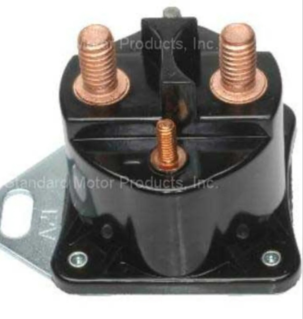

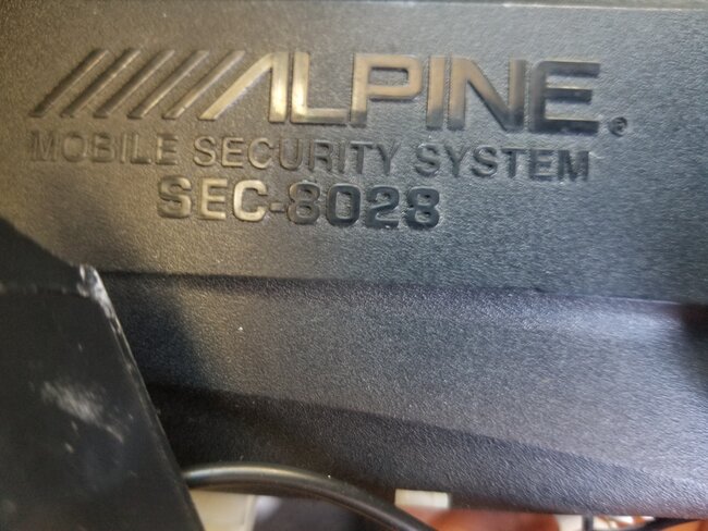

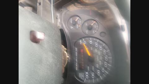

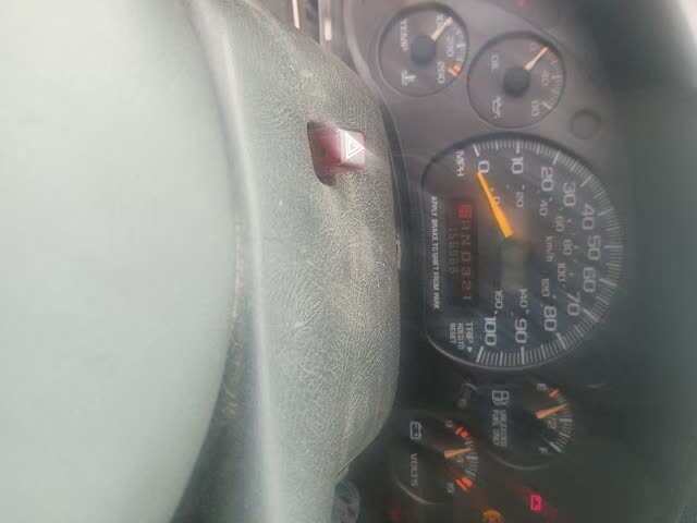

This is what it is doing. Rough start for a few seconds and shuts off.
Dec 21, 2022 at 2:40 AM
  • 110,244 POSTS

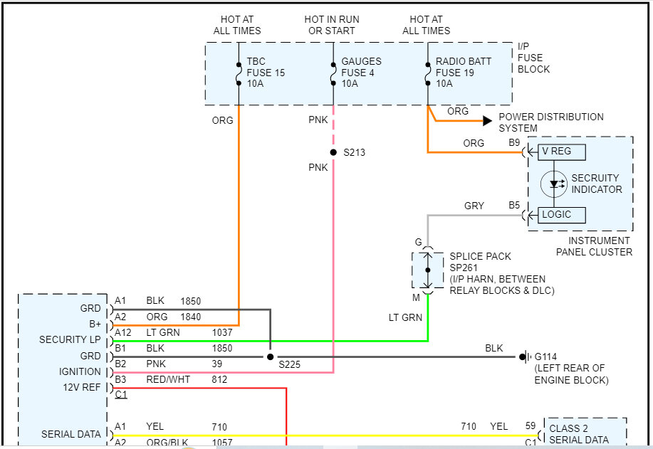

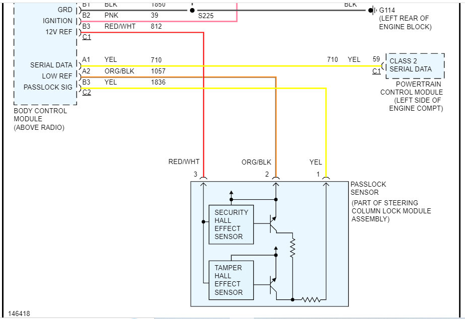

I watched the video and I do hear the click. It seems in time with the shift indicator light going on and off.

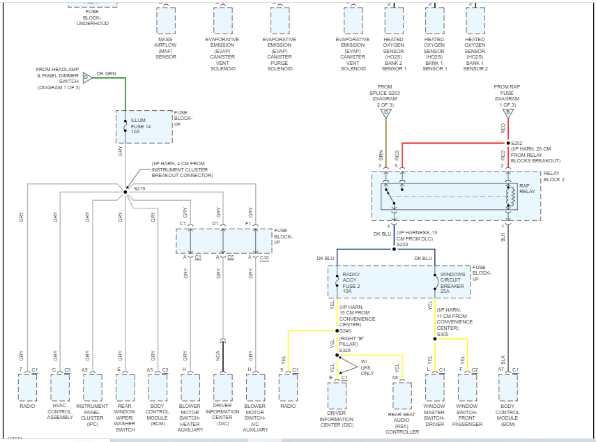

Based on that, I would think it is a relay or something similar to a relay/flasher, but looking at the schematic for the anti-theft, I don't see one. Take a look at pics 1 and 2 below.
Could it be the body control module you feel clicking?
Dec 21, 2022 at 11:59 AM
IAMWHOIAM
  • 18 POSTS
It was the security module that was clicking. It is an Alpine security system; I am beginning to wonder if it's not the BCM again was replaced almost 2 years ago also what scanner could one get to relearn the PCM and crankshaft positioning sensor.
Dec 21, 2022 at 12:43 PM
  • 110,244 POSTS
That is an aftermarket security system. Have you tried disconnecting it to see if the draw goes away? I have no idea where or how it was installed, but it can certainly create issues.

I did get issue resolved, was the security system. thanks
