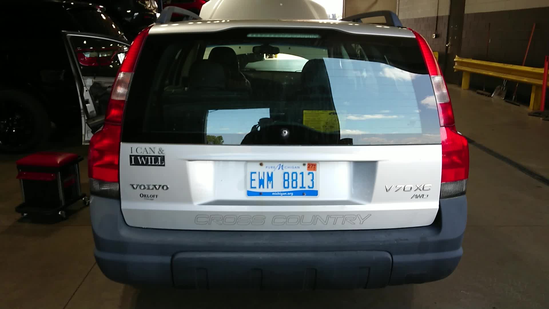

my question; is the latch on this vehicle connected to +12v independant of the MASTER SWITCH?
i have the master switch unplugged/out of circuit and still have 0.190ma ~ .225ma drain

i pulled fuse #25 and the driver master switch and still have a drain of .225A, (225ma), which seems like a lot

i unplugged the main wiring harness to the door and still have a 225ma drain, measured from the negative battery terminal to the negative cable.
i think the $640 doorlatch isn't the issue.

Yep so that was not it, that would have been a waste, 30–50 mA is acceptable. So the hunt continues, we must complete the CAN scan to help point us in the right direction. It sounds like the BCM is no going to sleep bad I could be wrong that is why we need the scan.
