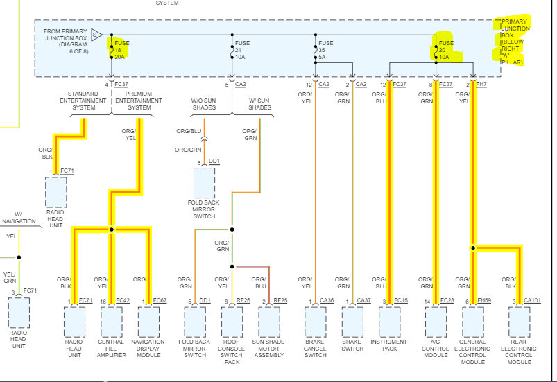

Having electric issues, the alternator failed and toasted battery at the same time. ordered an alternator and got a new battery on warranty. Upon installing the new battery so I could use my locks while I wait for alternator (no alternator in car) I noticed the battery was drained the next morning so I did a parasitic drain test and come to find out that f18 fuse (passenger fuse compartment) radio/navigation/cell was pulling 3.5amps and f20 (same compartment) was pulling 1amp GEM/air conditioner/instrument cluster power. With those 2 fuses removed my drain is.40ma. I thought it might be my amp, so I unplugged it and tested it again, not the amp... Do you guys have circuit information for those fuses? I've gone as far as I can and could use some help... Thanks
Mar 10, 2023 at 8:01 AM
  • 110,248 POSTS
If removing those fuses stops the draw, the problem is after the fuse. I looked at the power distribution schematic and located the fuses.
If you look below, I attached the schematic showing what those fuses power. I would disconnect one component at a time to see which stops the draw.
See pic below.

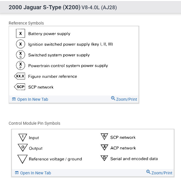

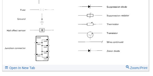

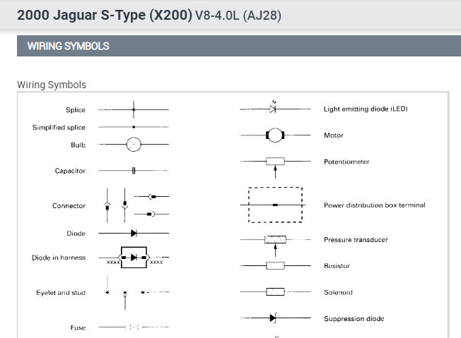

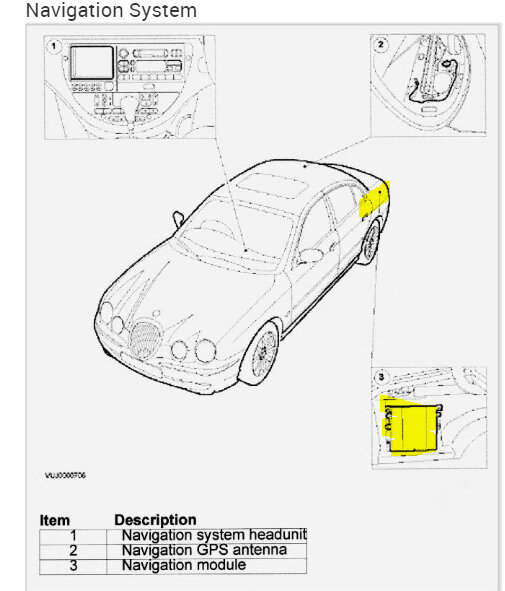

Thank you very much, that's exactly what I'm looking for. Two more questions - (1) say I'm looking at F18 20amp fuse, I follow the diagram down to navigation display module FC67 (how do I find the module itself) ...this is the part I really would like to learn, comprehension of the diagrams. Is there a key you can send me, so I know what these symbols and numbers mean? Is there a place where all these modules are located? I will be hunting for this problem module today and also installing the new alternator... Thank you, Joe.
Mar 10, 2023 at 8:18 PM
  • 110,248 POSTS
Without a manual, it will be difficult to locate the components. However, I can help so don't worry about asking.
If you look at pic 1 below, it shows the display module. If you open the trunk, it is on the left side.
The remaining pics provide the other information you requested.
