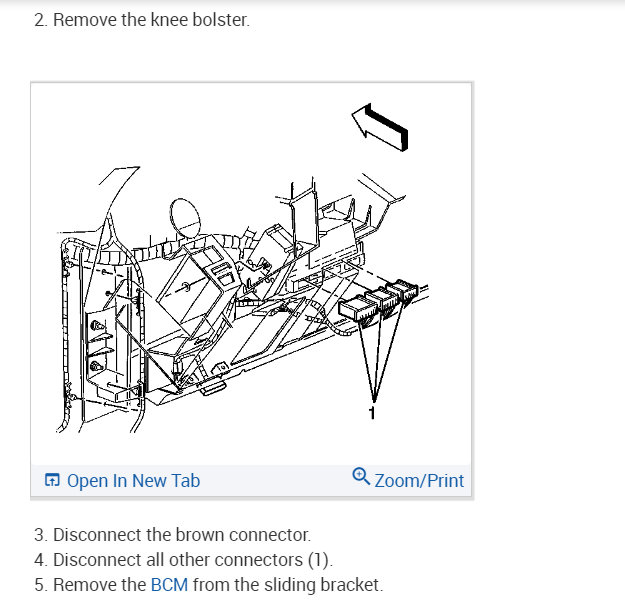

Hey guys, I'm having a problem with a parasitic drain. I haven't done a test, but I did scan it for codes and b1480 and b2610 came up. Could these codes cause the drain? If so, how should I go about fixing it? Thanks so much!
Aug 14, 2022 at 8:32 PM
  • 55,421 POSTS

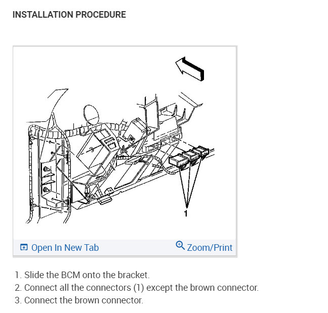

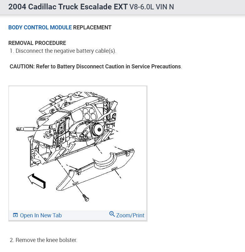

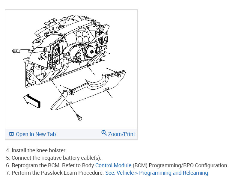

The b1480 code is the Battery Rundown Protection is not working so yes this will cause the battery to run down. You will need to replace the BCM here are the instructions in the images below.
