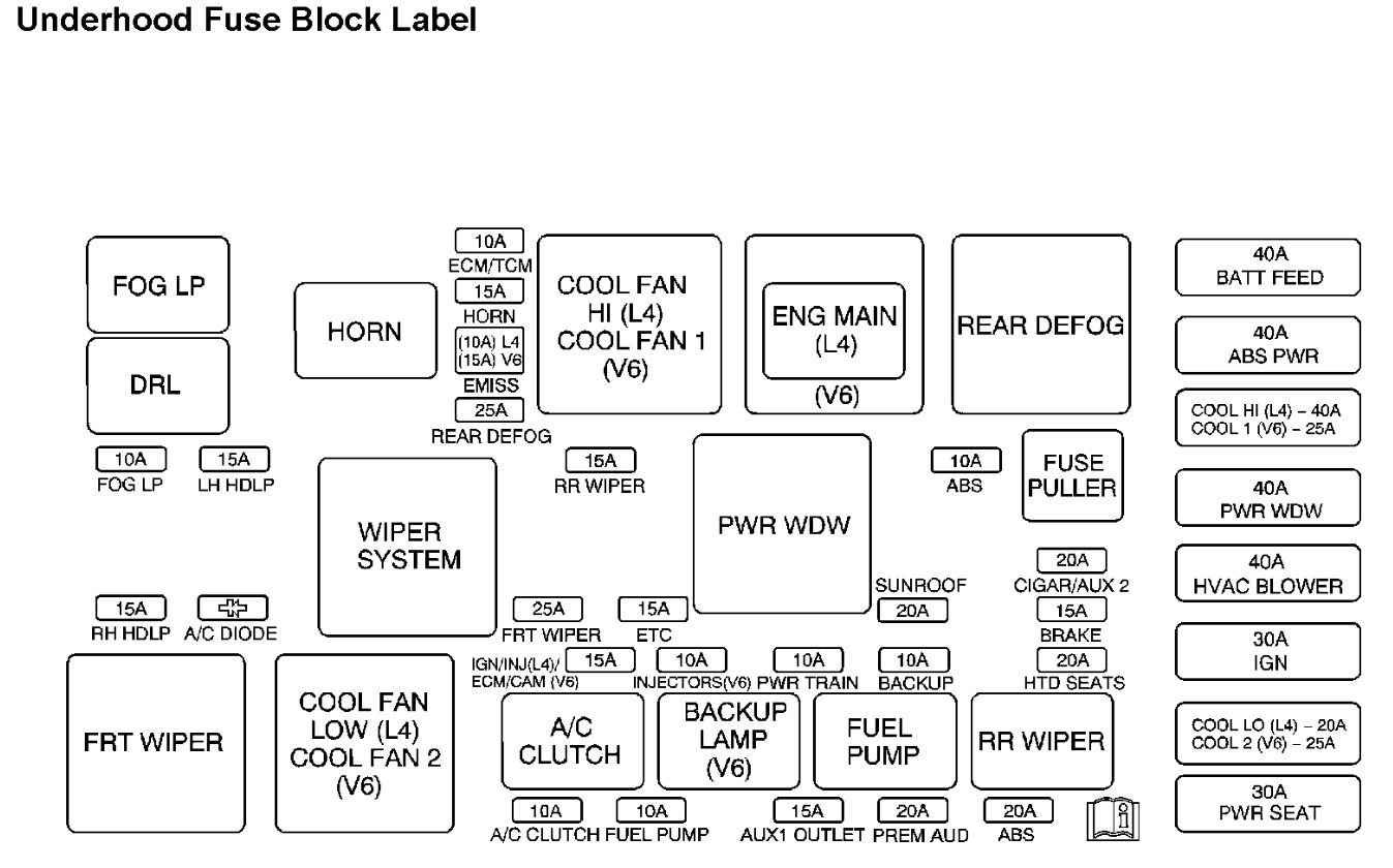

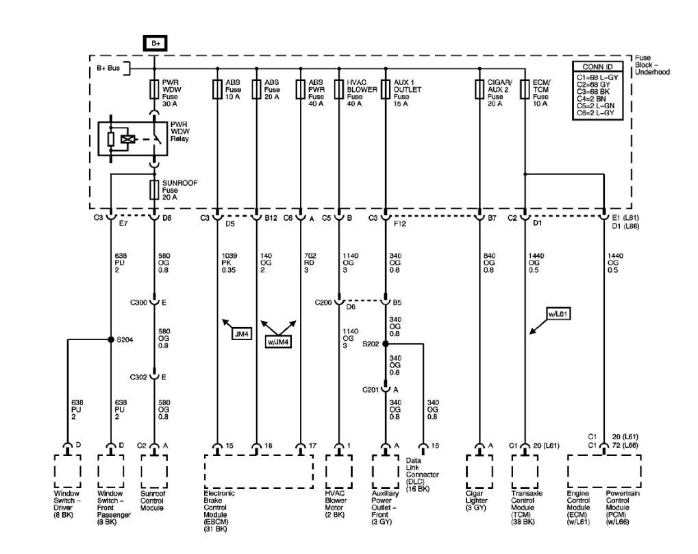

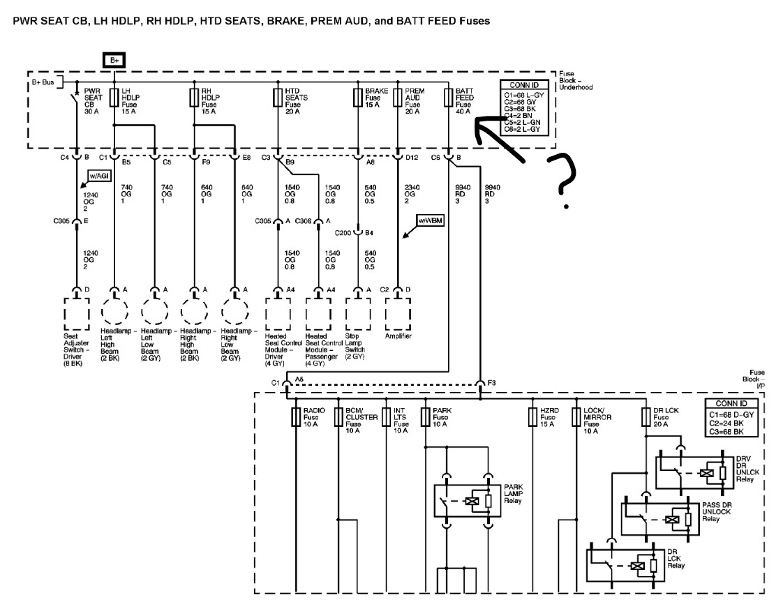

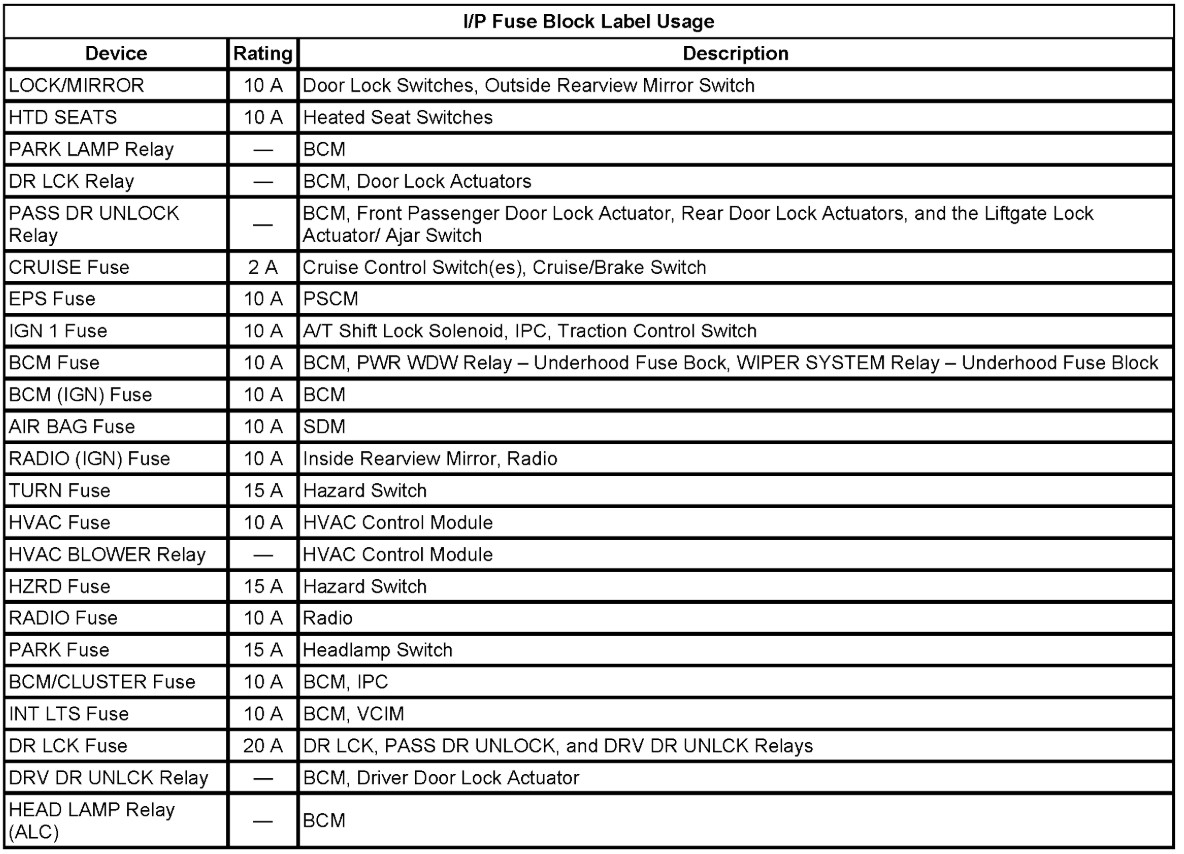

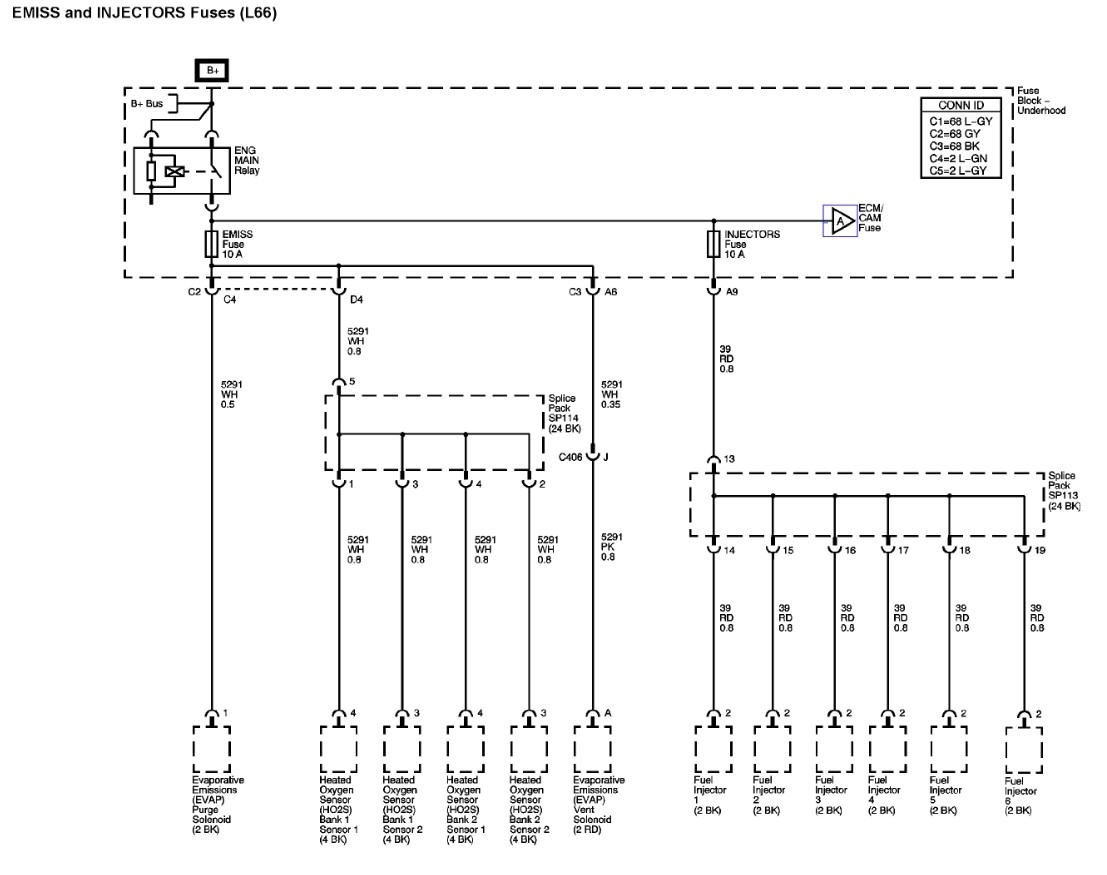

Recently, my battery was dead out of nowhere. I replaced the battery because it was older just in case. Now the battery drains down in one or two days of sitting in the driveway. When I remove all of the fuses in the fuse panel, I do not see a draw from the battery when I touch the cable to the post (it does not spark).. When I install the 40 amp main fuse that feeds the entire circuit board and with no other fuses installed, there is a pretty good spark when I touch the cable to the battery post, and the battery will drain down. Also, I have the other cable that goes to the starter disconnected. Not sure where to go from here to identify what is causing the battery to drain.?
Dec 19, 2025 at 2:45 AM
STEVE W.
  • 15,352 POSTS

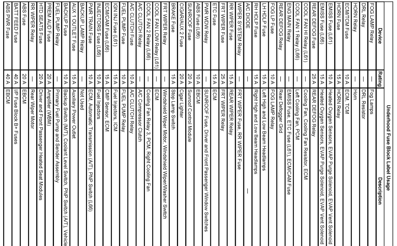

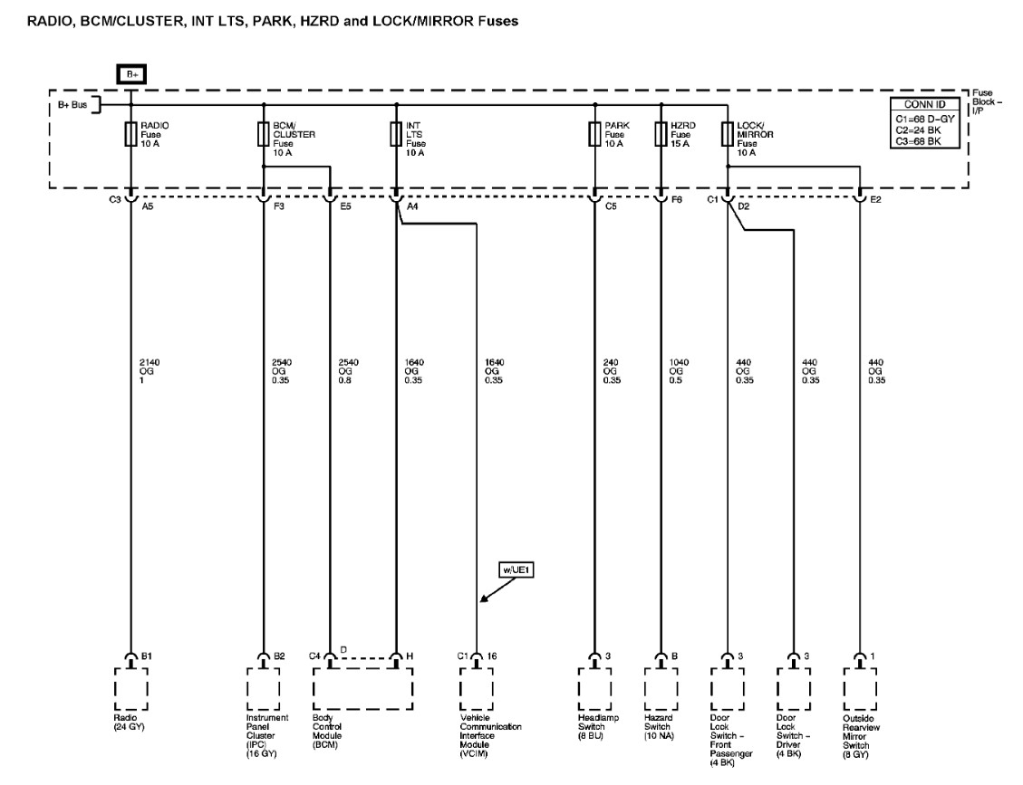

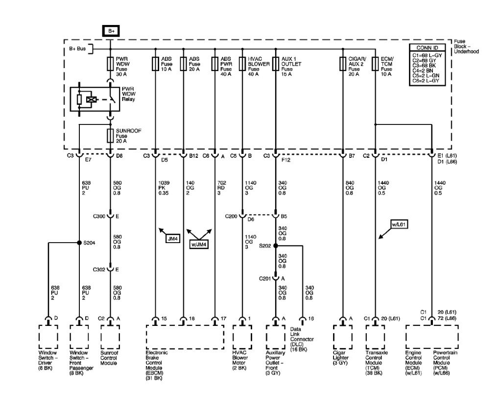

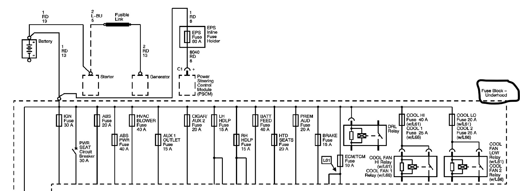

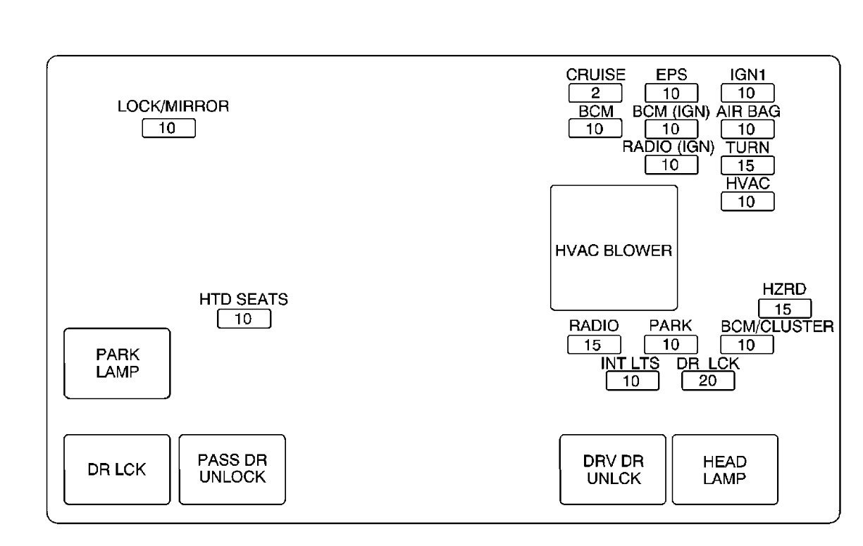

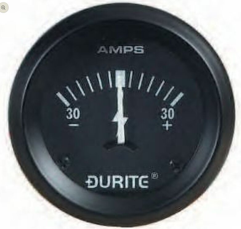

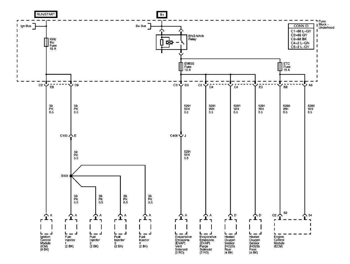

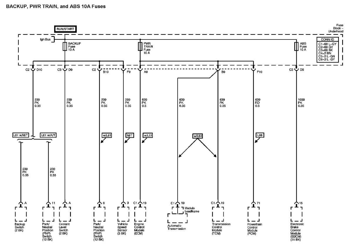

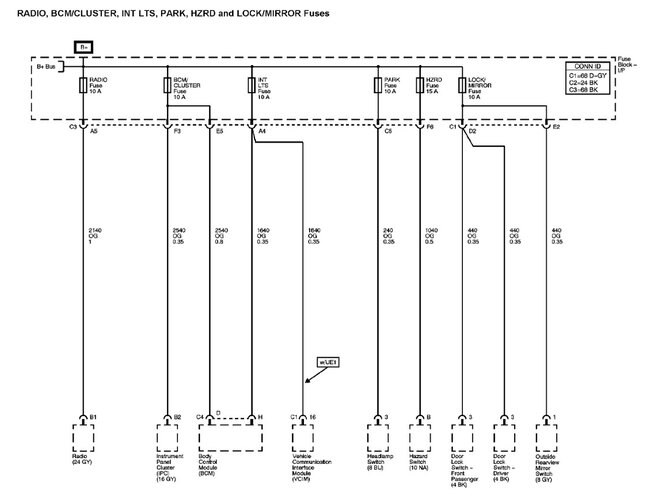

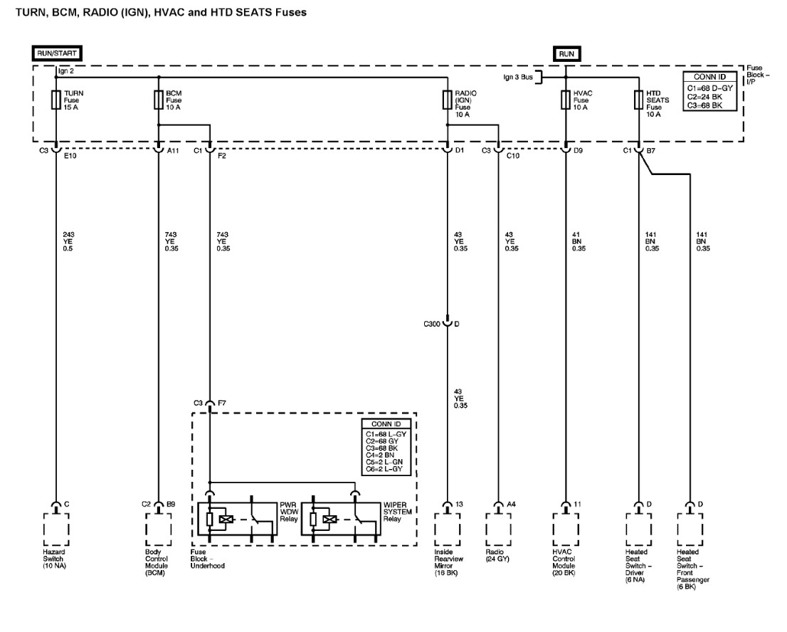

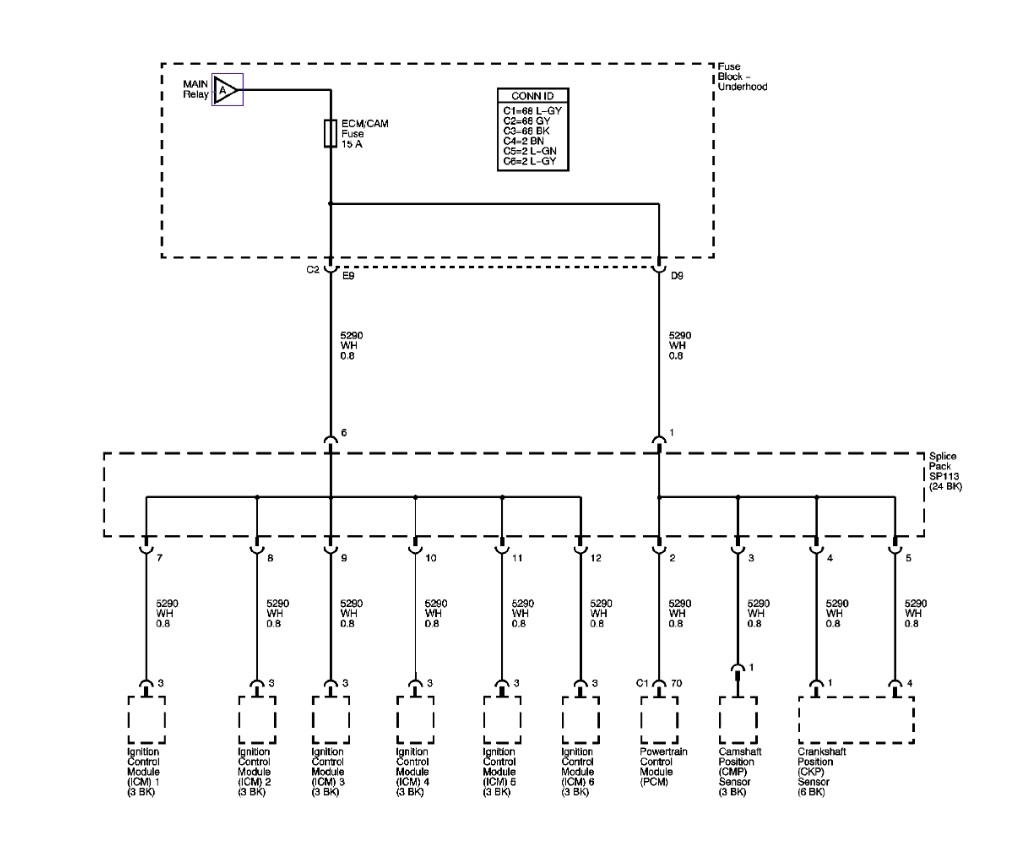

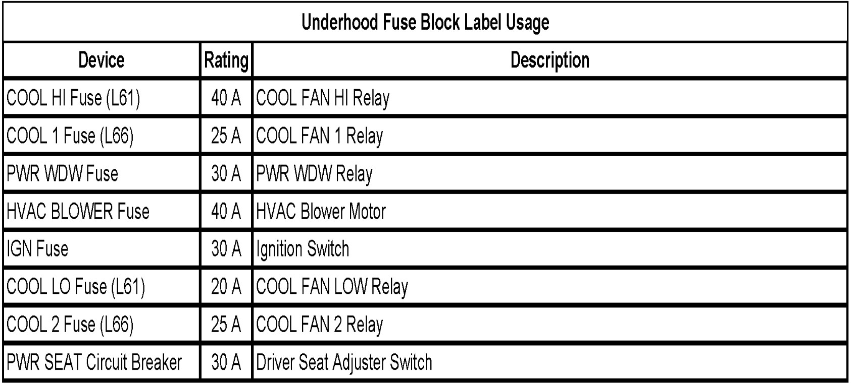

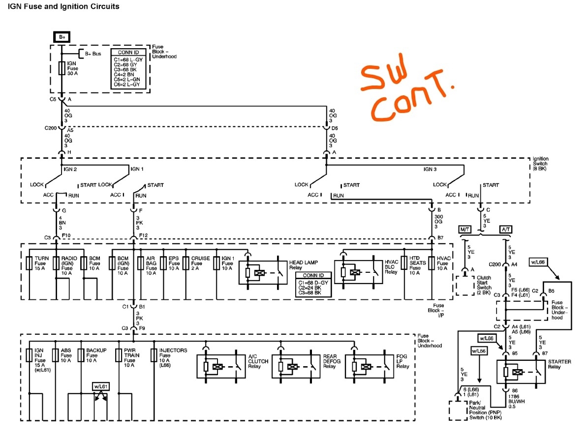

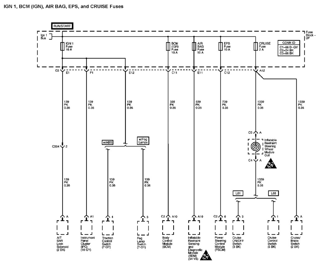

OK we need to narrow down the actual circuit as there are multiple fuses that could be the issue. Do you have a test light or a meter to test with? Is the fuse you pulled the one labelled Batt Feed? That one feeds the interior fuse panel. These diagrams should cover all the fuses. For testing you will need three items. A large 30 amp ammeter like you would install in the car, a smaller multimeter that has at least a 10 amp amp rating and a pen.
The pen will be used to trip the latch on the door so that the switch in the lock stays off.
Then connect the large current ammeter between the battery negative post and the negative battery cable. Leave the key OFF (this is because you don't know the extent of the short yet, if it is over 10 amps it will blow most of the common multimeters fuses or circuits while it won't damage the larger meter)
Now with it connected install the fuses in the under hood fuse box one at a time. Skip the 40 amp for now. If one of them causes the meter to jump up, wait a few minutes to see if it goes back to sleep, if not write down the number and move to the next one until they are all back in. Now if the meter is on zero or very close to it, disconnect one side and connect the multimeter in the circuit with it on the 10 amp or higher setting and write down the amp draw (if any). Now disconnect the meter and re-connect the larger meter. Plug in the fuse that is the problem. If it's the one that feed the interior box great. Note the reading. Now go to the interior fuse panel and pull the fuses there until the draw drops. Note that fuse and put it back in, keep going until you have pulled them all. Now you should have one or two fuses that caused the load to stop. Either look on the diagrams for the fuse number and what it feeds or reply back with it and we can continue. Common ones that cause a draw are the BCM, the radio (especially aftermarket) fuel pumps and lights.
Now you just need to follow the draw and the circuit. The last images are what each fuse actually feeds. Do some testing and see what you find, then we can see about fixing it.

Hello, thank you for the quick and thorough response. Yesterday was the first time we had a chance to look at it. We first checked the amp draw between the two positive cables and the + battery post and found there to be between 3.6 & 3.8A on the two cables. We then continued monitoring the amp draw on each cable while pulling the fuses in both the engine bay and under dash fuse panels. We never could see any change in the draw. After that we inquired online about what to do and we then tried the same method but on the negative side instead of the positive side. On the negative side, we only saw about 20 mA of draw which seemed to be normal. Before we started, I told the mechanic that I had already pulled positive cables off while the car was running to see if you would stay running in an effort to test the alternator.. He told me that the only way to do it is to pull the negative side cables off of the battery while it’s running, and if it continues to run, then the alternator would be good. When we tried that step, the car quickly died. So, it was the mechanic’s diagnosis that it needs a new alternator. I just ordered one today from the auto parts store and it should be coming in later. I will try that and make sure it works and let you know the end result..Thank you

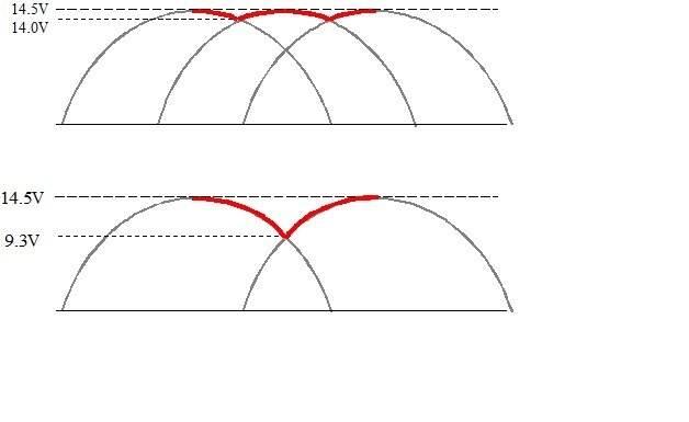

All "AC generators" develop three-phase output, like what's shown in the top waveform in my drawing. The red line on top shows the normal "ripple" voltage that you'd see with an oscilloscope. That alone would cause a very annoying whine on AM radio, but it's the battery's job to smooth that out. Ripple voltage doesn't cause other problems except when there is no battery, or in the case of '87 and newer GM generators, can result in huge, damaging voltage spikes that lead to repeat generator failures. What is of concern is how the voltage regulator reacts to ripple voltage.
The voltage regulator's goal is to maintain system voltage between 13.75 to 14.75 volts, (give or take a little depending on which textbook you read). Normally it looks at battery voltage. There are exceptions, mainly on GM vehicles with digital instrument clusters, but that's not important to this sad story. Lets use 14.0 volts for this explanation. As I drew in this diagram, without the battery connected, the voltage regulator would "see" 14.0 volts very briefly. Most of the time system voltage is higher. Some regulators would respond by trying to lower those higher voltages. It does that by cutting back on generator output, but with no battery, it does that without success. Even though average voltage drops, the regulator still reacts to the instances when voltage goes over 14.0 volts. It eventually cuts back so far, the engine stalls due to voltage to the ignition coils, injectors, and electric fuel pump being too low to operate properly. Since the engine stalled, you incorrectly think the generator is defective.
More commonly, most voltage regulators respond to the lower system voltages, in my drawing that would be the 14.0 volts. If it's trying to maintain system voltage of, . . . say, . . . 14.2 volts, it will see the 14.0 volts and try to bump up generator output. The peaks may go to 15, 16, even 18 volts, but it's still reacting to the 14.0 volts. No matter how high output voltage goes, it keeps on seeing voltage that's too low. It's the battery that keeps the regulator seeing a nice, steady 14.2 volts. I did this every year for a class demonstration. With the generator on a test bench, and the battery disconnected, it was very easy to get the output voltage to exceed 30 volts. That would be catastrophic to any vehicle with computers or older ignition modules.
What CAN save you with this procedure is to generate a voltage mechanically, you need three things. Those are a wire, (coil of wire is more efficient), a magnetic field, (we use an electromagnet because it's easily adjustable), and most importantly, movement between them. That's why we spin the electromagnet with a belt and pulley. Because of that movement, all generators are rather inefficient at low speeds, like engine idle speed. That's also why all professional testers include "raising engine speed to 2,000 rpm" as part of the procedure.
Where this becomes more confusing is when a diode fails. "Diodes" are one-way valves for electrical current flow. All AC generators use at least six of them. Two are used in each phase, or group of coils, but they share and trade off which coils they're working for as the magnetic field rotates. The bottom line is when one diode fails, you lose one phase, as shown in my lower drawing. Ripple voltage goes extremely high, 5.2 volts in this case, and you lose exactly two-thirds of the generator's output current capacity. Today it's very common to find generators with a rating of 100 amps. With one failed diode, the most you'll be able to get under the "full-load output current" part of the professional test is around 33 amps. That isn't enough to run the entire electrical system under all conditions. The battery has to make up the difference as it slowly runs down over days or weeks. Even worse, the voltages in my drawings are just representative as part of the explanation. On the car, these voltages can be much higher and can be basically uncontrollable with the battery disconnected. This is a case where the generator is defective but the engine will likely stay running, (poorly), with the battery disconnected.
