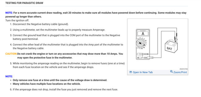

Theft message, car may not start but is always does. Replaced switch, still have message. Park indicator stays on all the time and battery dies overnight. Battery and alt are good.
Jan 3, 2020 at 4:55 AM
SCGRANTURISMO
  • 4,897 POSTS

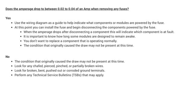

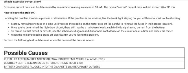

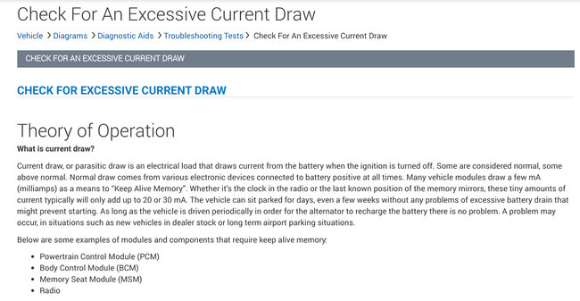

In the diagrams down below I have included a guide on how to find out the cause of parasitic draw in an automotive electrical circuit. Please go through this guide and get back to us with.
