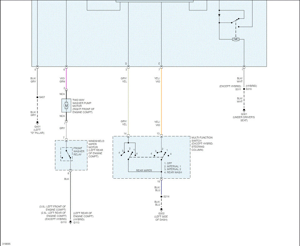

Previous mechanic pulled the fuse out for the rear wiper and that solved the drain problem (but rendered rear wiper non-functional). I put the fuse back in recently just to see what would happen and it of course drained the battery. Then after jump-starting the vehicle I pulled out the electrical cable bundle going into the rear wiper motor, thinking that would solve the drain problem even with the fuse still in. It did not - the battery drained again. Prior to that happening I assumed I just needed a new rear wiper motor, but now I wonder if the drain is happening somewhere else between the battery and the wiper motor.
Apr 2, 2020 at 11:46 AM
  • 110,248 POSTS

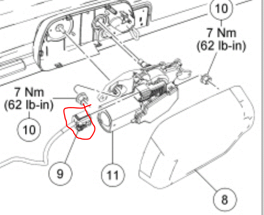

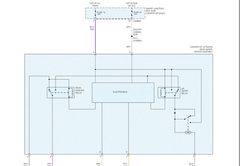

The rear wiper wiring isn't real complex, but anything is possible. I attached two pics below. It is the wiring schematic for the entire wiper / washer circuit. (pics 1 and 2) When you disconnected the motor, did you check to make sure there is no damage to the connector pins? I have seen them short internally. How many wires were on the connector to the motor?
Also, if you look at pic 3, is that the plug you disconnected?

Thank you for your help. Turned out I just hadn't left the engine on long enough after jumping to charge the battery enough to start the next day. the new wiper motor wasn't draining the battery after all, and everything works now. Thank you!
