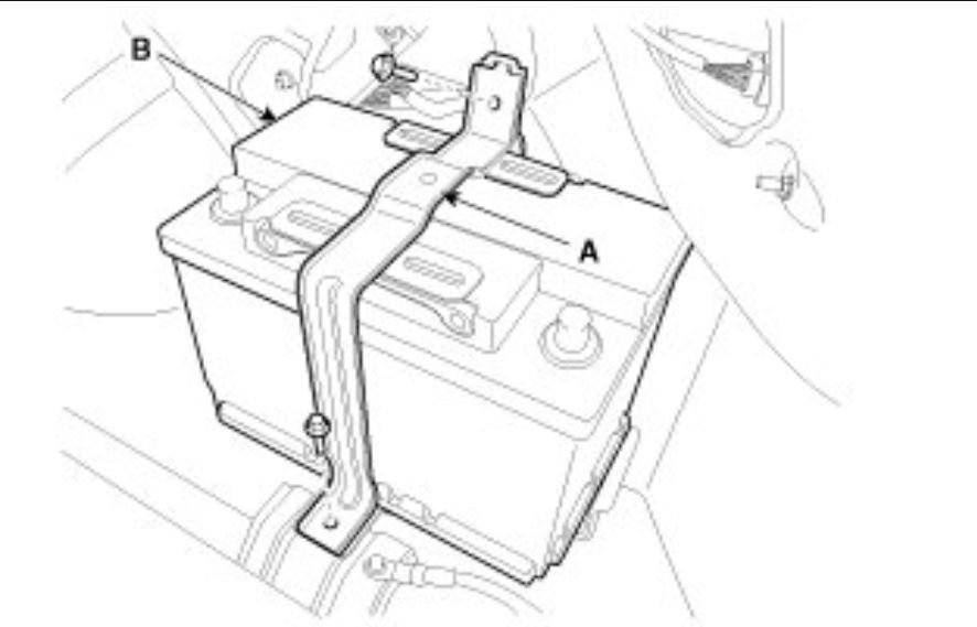

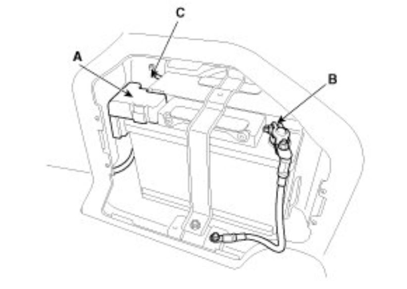

Removal and Installation
1. Disconnect the battery negative terminal (B) first, then the positive terminal (A).
Tightening torque :
(+) terminal (A) : 7.8 - 9.8N.m (0.8 - 1.0kgf.m, 5.8 - 7.2lb-ft)
(-) terminal (B) : 4.0 - 6.0N.m (0.4 - 0.6kgf.m, 3.0 - 4.4lb-ft)
2. Disconnect the vent hose (C).
3. Remove the battery upper bracket (A) and then remove the auxiliary 12V battery (B).
Tightening torque :
19.6 - 29.4N.m (2.0 - 3.0kgf.m, 14.5 - 21.7lb-ft)
4. Remove the battery tray (A).
Tightening torque :
5. Installation is the reverse order of removal.
CAUTION:
Install the battery upper bracket after locating the battery at the closest position to the side panel.
