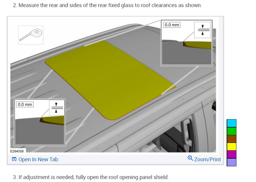

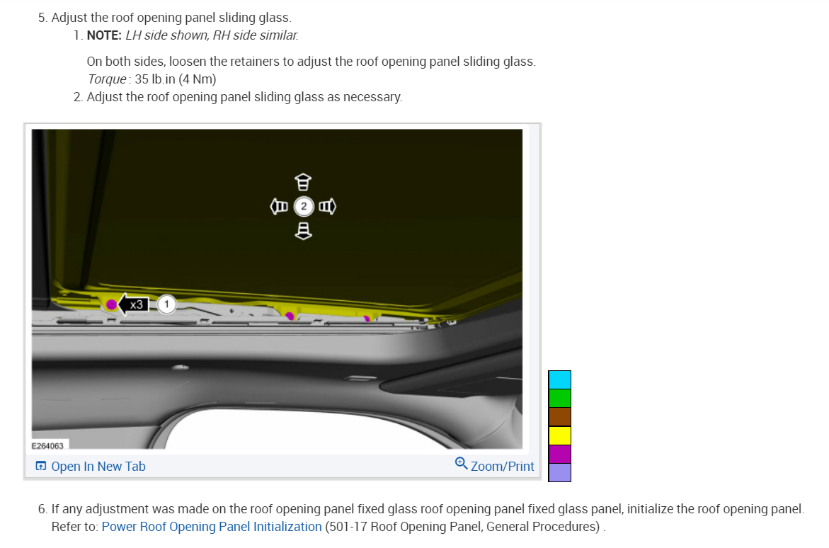

The sunroof was not sliding right, took off the glass and it broke the plastic piece. tested it and it ran fine. I did a reset before I put the glass back on and I think that is where I messed up. Now when I try to reset this, with the glass on it thinks the window is all the way in the back, so forward will click but the tilt and back button does not work, what do I need to do to erase the memory? So, I can do a reset? Thanks, Dave

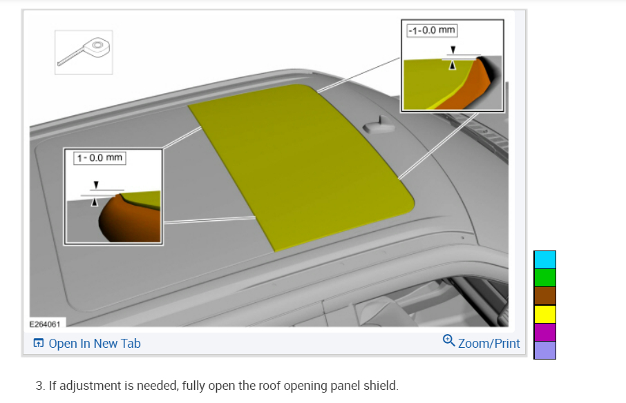

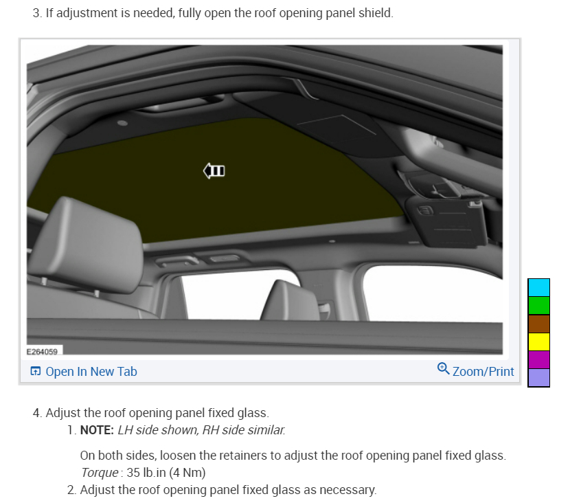

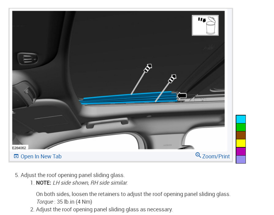

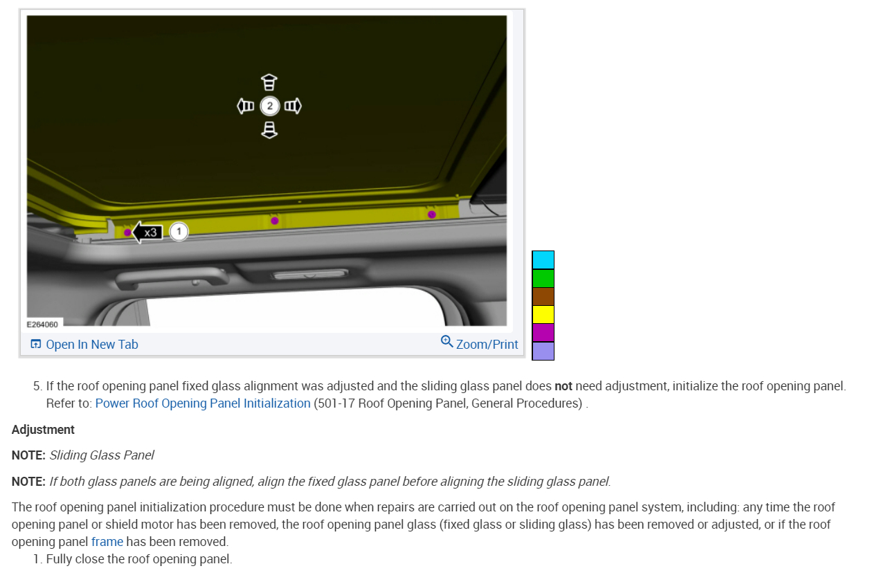

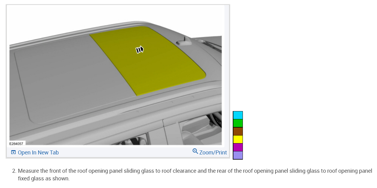

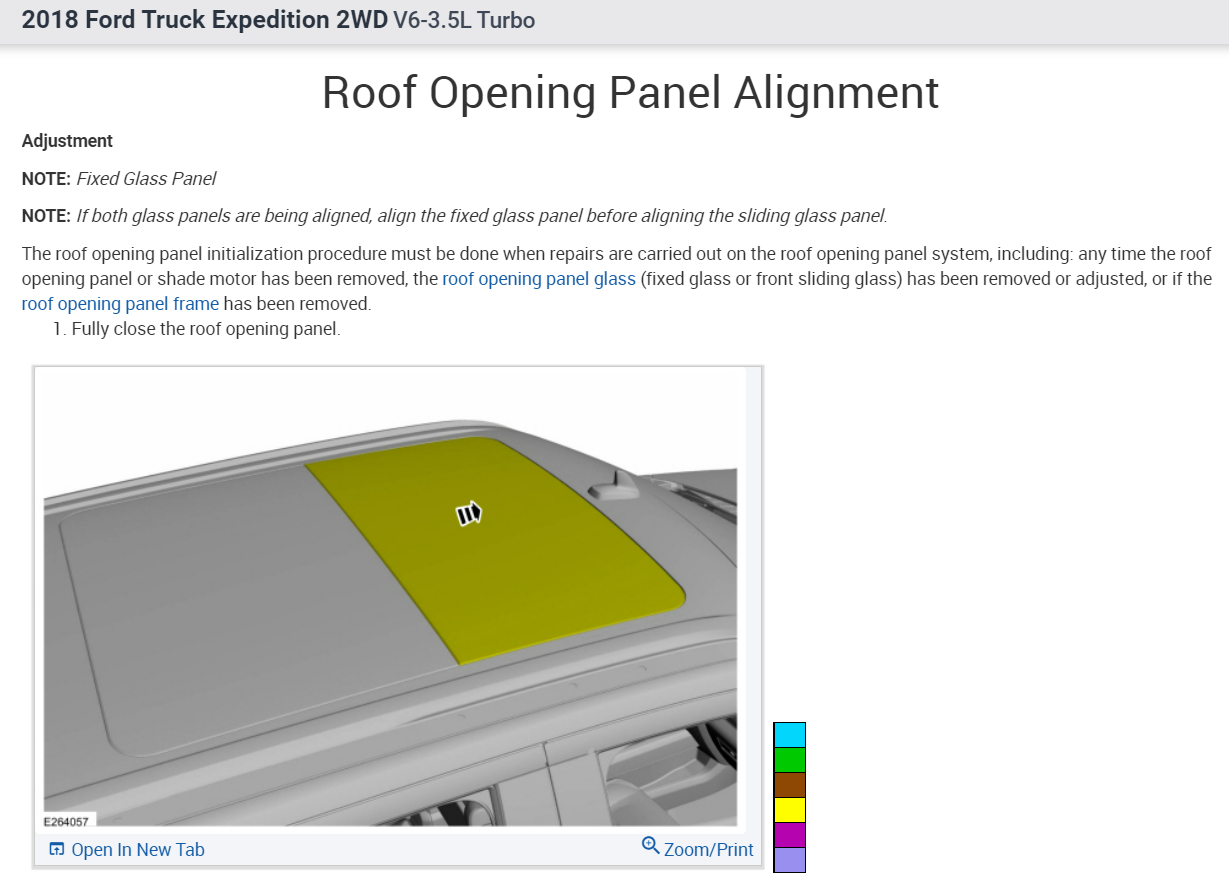

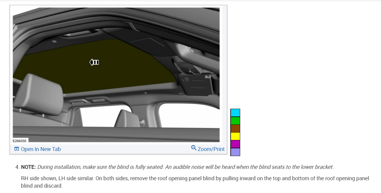

This can be happening because the adjustment could be off, also there is a set up procedure that must be done if the adjustments don't work. Here are the instructions in the diagrams below. Here are the roof opening instructions:
Power Roof Opening Panel Initialization
Initialization
image WARNING: Keep objects and body parts clear of the glass panel when carrying out the initialization procedure. During the initialization procedure, the glass panel closes with high force and cannot detect objects in its path. Failure to follow this instruction may result in serious personal injury.
NOTE: The roof opening panel motor must be initialized when repairs are carried out on the roof opening panel system, including: any time the roof opening panel motor has been removed, the roof opening panel glass (fixed panoramic or front sliding) has been removed or adjusted, or if the roof opening panel frame has been removed.
NOTE: Carrying out the initialization will initialize both the roof opening panel glass motor and the shield (sunshade) motor.

Check out the diagrams (Below). Let us know what happens and please upload pictures or videos of the problem.
