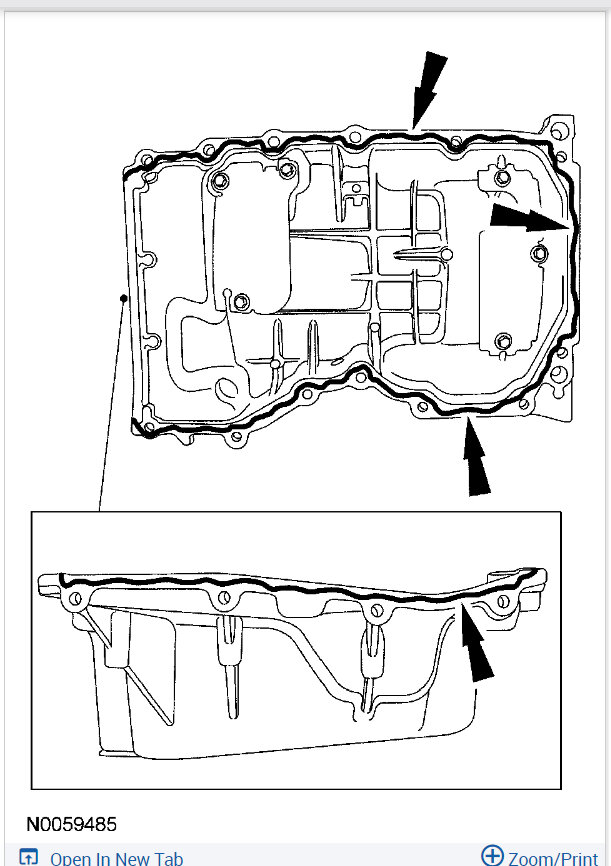

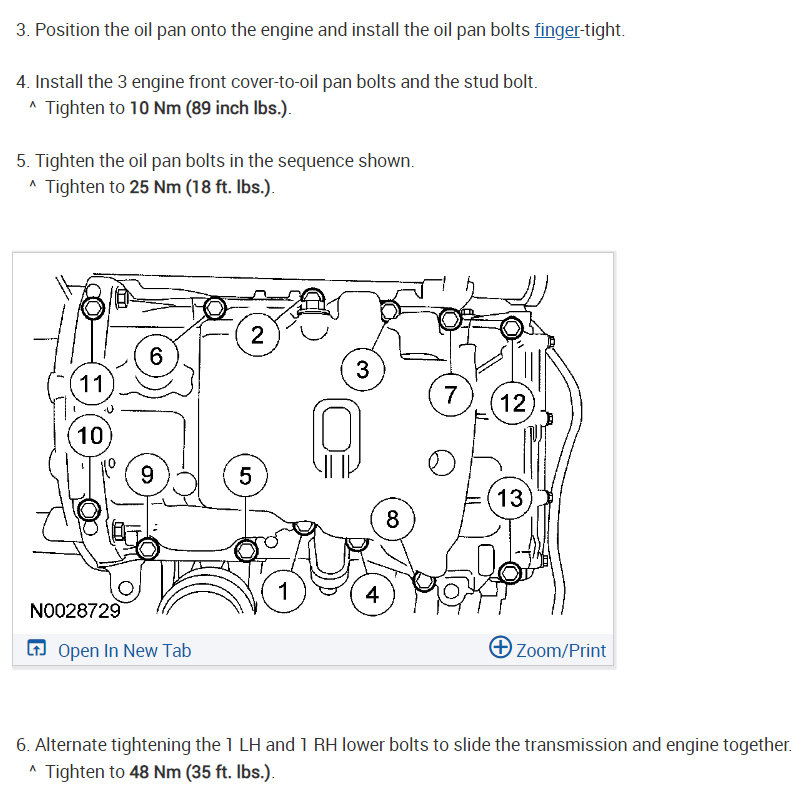

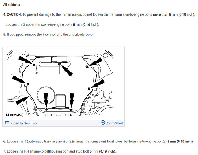

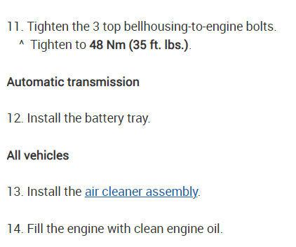

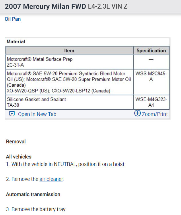

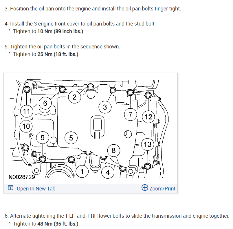

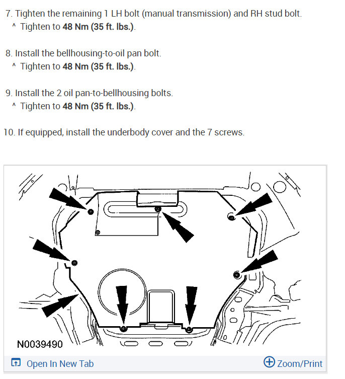

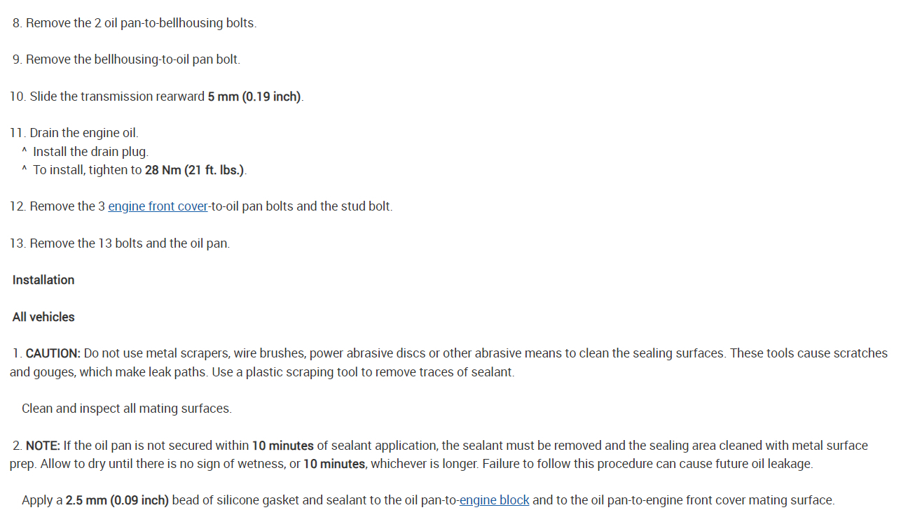

Hello, do you all have any diagrams to remove and replace an oil pan for my car.
Dec 28, 2023 at 2:25 PM
  • 55,616 POSTS
Start by draining the engine oil and raising the car up so you can get underneath it. Here are the instructions for replacing the engine oil pan and gasket. Check out the images (below). Let us know if you need anything else.
