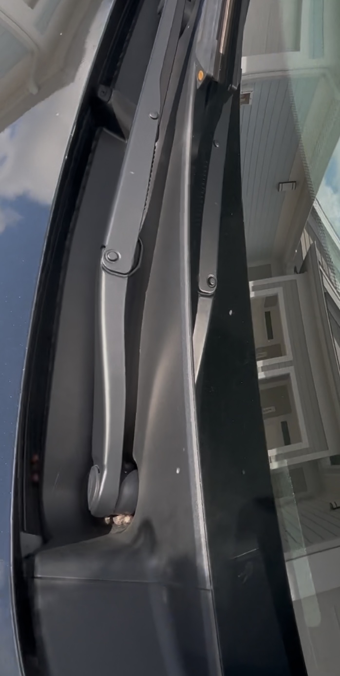

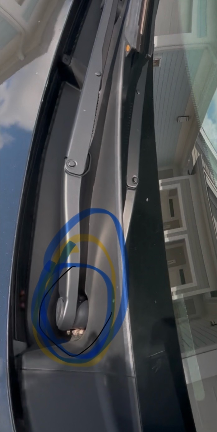

After a thunderstorm I had noticed some palm seeds at the base of my wiper arm junction, I couldn’t seem to remove the seeds even with tweezers. Wipers operate fine, is this a concern or can I leave it alone?

Won't hurt anything but they could draw bugs or hold moisture. Probably the easiest solution would be a car wash, one where you have a wand to wash the car with, use the spray to blow the seeds away. Or use something with a point on it to loosen them up and pull them out.

Not going to cause a problem. Just blast them out. Under that plastic is open and drains out.

I don’t have any air or anything to blast it with. Is it worth taking to a mechanic to do or just leave it alone? It happened during a thunderstorm and it blew those sabal palm seeds all over my windshield and it got into the nooks and crannies of my wiper blade arm junction as u can see in the picture I submitted, I was just worried it would jam something internally or block some sort of air intake in the cowling

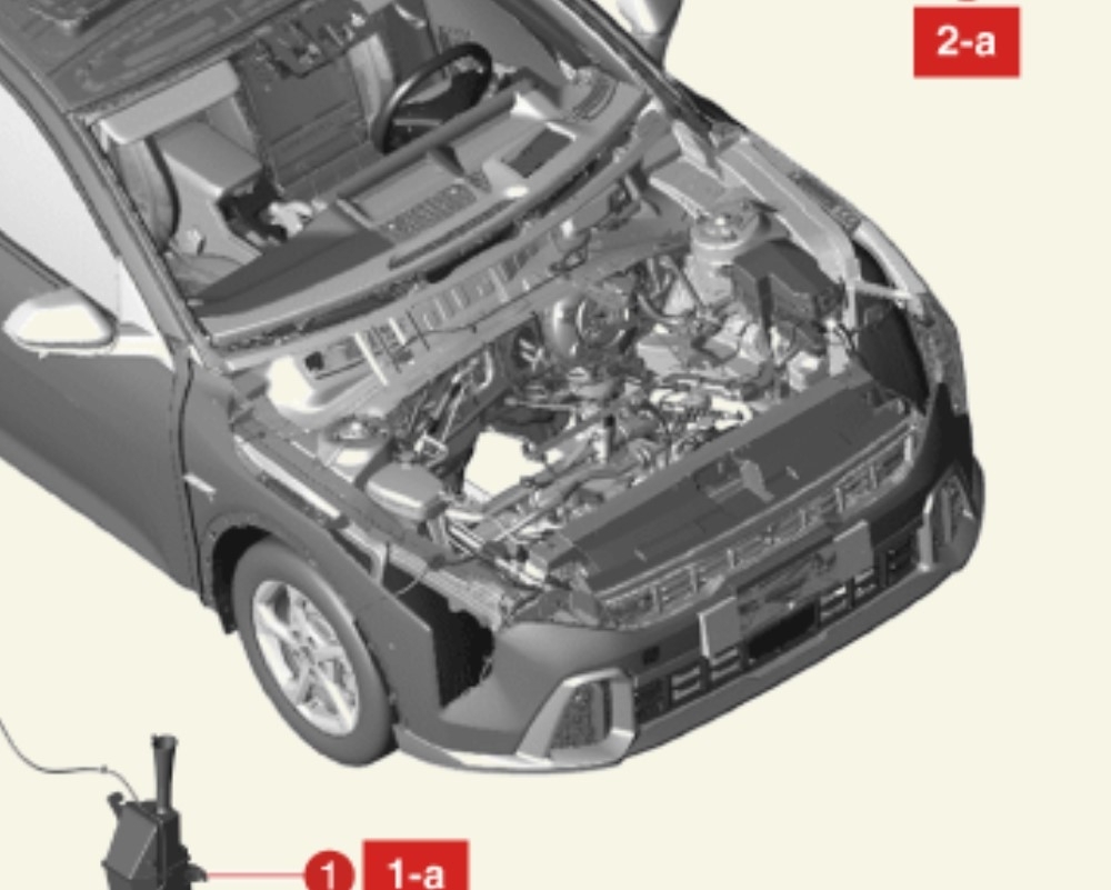

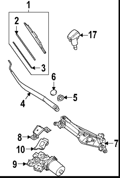

It connects to the wiper transmission which then has an arm on the back that connects to the other wiper and the motor uses another arm to power both. The plastic is just a cover. If you removed it you would see a large empty area below the windshield that goes across the cowl. That is where the air for the heater and vents is pulled from. Where the seeds are is just an open hole under it. That is why I said that you can ignore them or wash them out, there is nothing there they can hurt.

There is a linkage but not that close. If you took it apart you would find a shaft that the wiper attaches to, that goes through a plate that has an arm on the back. The plate bolts to the car and acts as a pivot. If you were to strip the metal and covers off the first image is the top of the firewall and shows the area below the glass where that mounts. The other shows the parts that move the wipers. All of those parts are designed to handle water, snow, dirt, and whatever else you might drive through, a few seeds are not going to be an issue.
