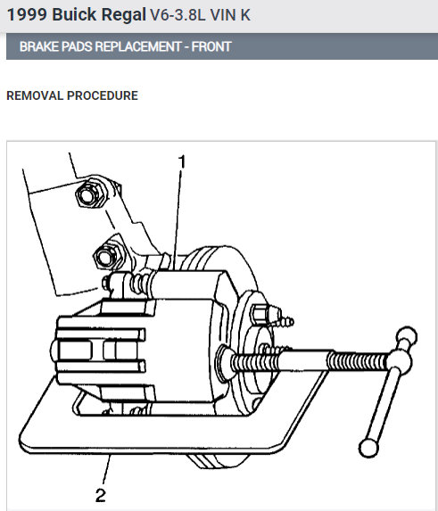

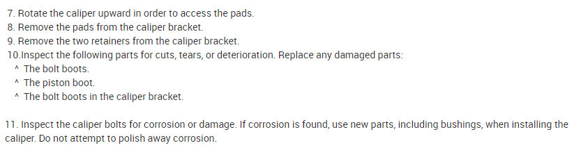

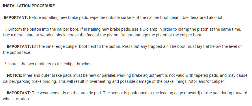

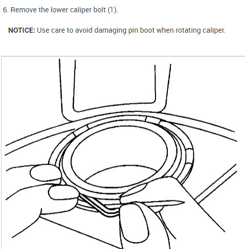

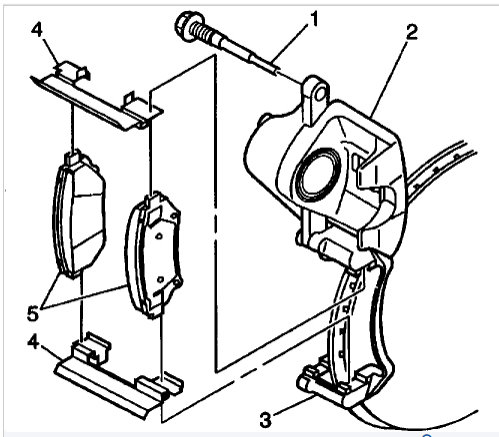

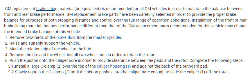

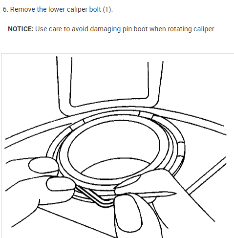

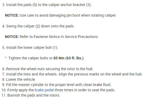

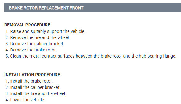

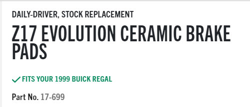

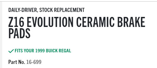

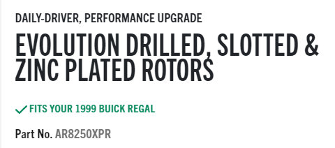

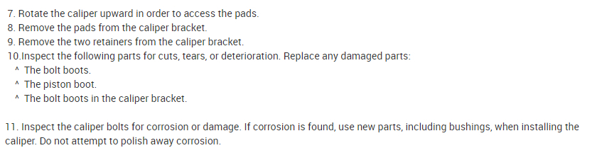

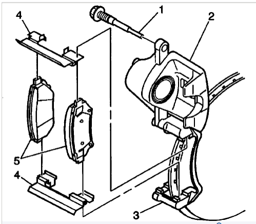

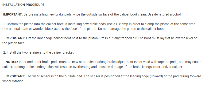

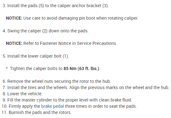

Here is the information you requested. This is a tutorial showing step by step what is involved on how to change front brake pads and brake rotors:
I've attached picture steps below on how to change the front brake pads and rotors on your car. As far as the PowerStop part numbers I've added them below as well but I would advise you to visit their website to view for yourself. Hope this helps and thanks for using 2CarPros.

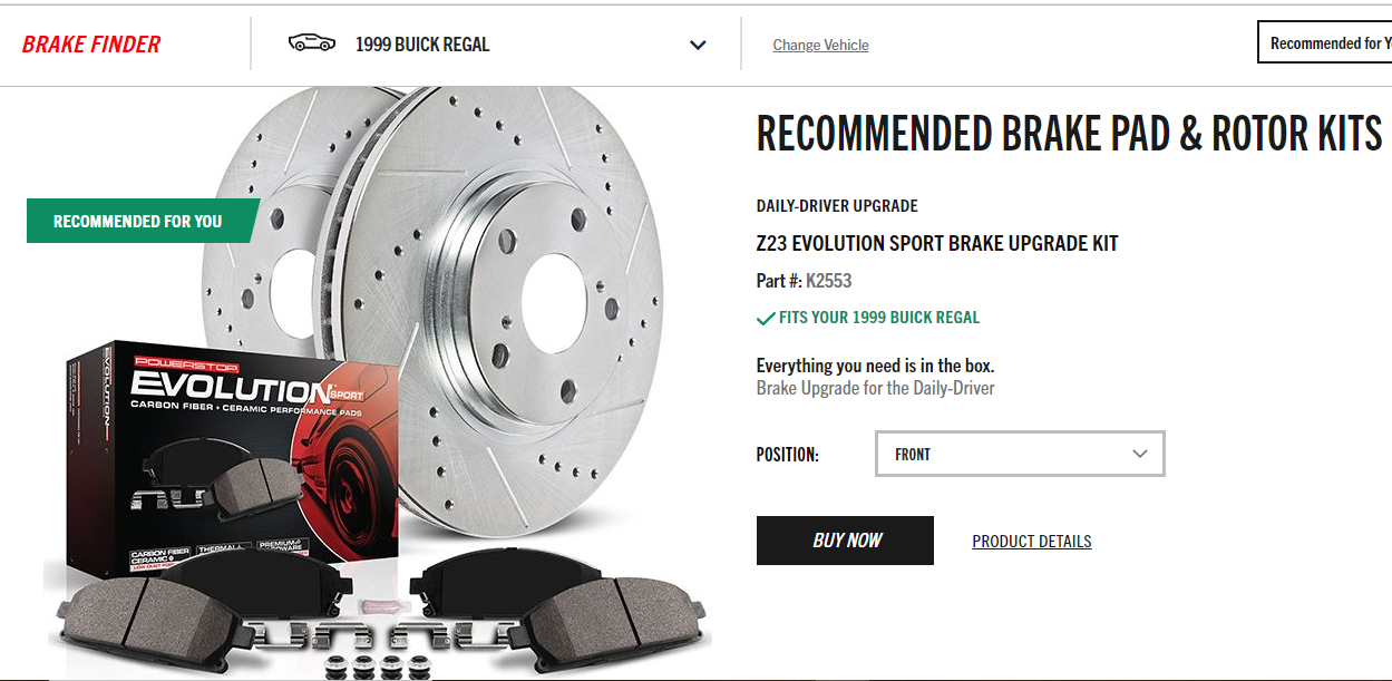

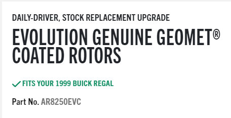

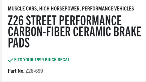

PCULQUI
  • 354 POSTS

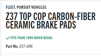

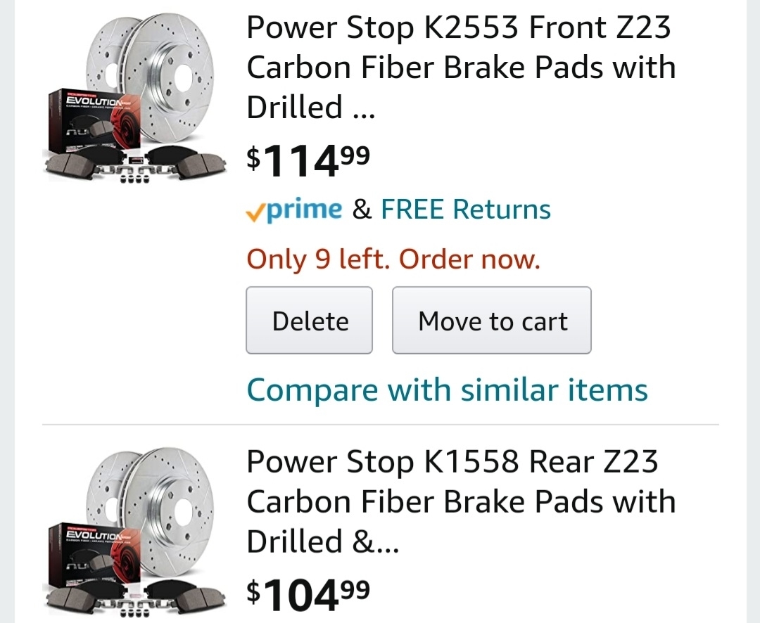

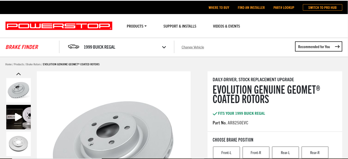

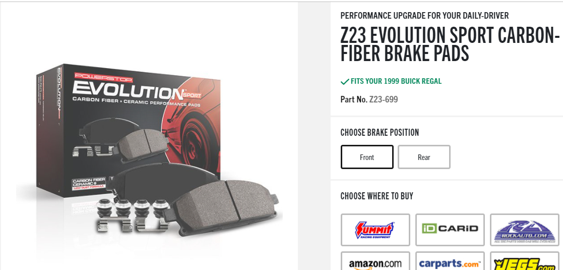

Will these pads and rotors pictured below fit my vehicle.?
Apr 10, 2021 at 7:58 AM (Merged)
DANNY L
  • 5,648 POSTS
Hello again.
Yes, those are the correct part numbers for your car listed above. I Hope this helps and thanks again for using 2CarPros.
