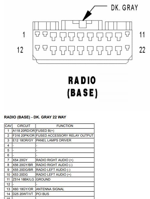

Car failed to start, gas gauge on empty, airbag lights on, immobility service on message board. I went back with spare keys everything worked car started drove home. Next morning same thing. This time I drove it farther. Several time, about 4, during the trip gas gauge dropped to empty, airbag lights came on, same message came up. Car kept running so I kept driving and 2 to 3 seconds after it started it clears. Is this an anti theft mater. Key switch, PCM, BCM, could be involved however mechanic friend said similar problem turned out to be corroded relay near fans. Is there a PCM relay if so where is it.

Had PCM and BCM scanned at shop. It said PCM, BCM no communication because I had disconnected the battery. He checked both and scanned history only thing found was fob battery low. Changed them seemed everything was okay, then gas gauge dropped to empty both air bag lights came on then dash went black. I got onto a parking spot and shut it off. No service engine light. Recently had pioneer radio installed and mechanic suggested the halo ring which reads the fob might be weak or radio tech might have tapped into wrong wire. Also suggested have keys checked for fob failure but in both seems odd. Next time I’ll take picture of dash.

Sounds good. Based on the no communication codes you mentioned, it sounds like that may be your issue. If the PCM is unable to communicate with the rest of the modules on the network, the engine most likely won't start. You mentioned the installation of an aftermarket radio. The original, factory radio was actually on the same communications network as the PCM and the rest of the critical modules. It's very possible if the installer accidentally tapped into this network(Bus) circuit, that it is causing the entire system to crash at times. I suggest removing the radio and inspecting the connector and wiring to make sure nothing is connected to this Bus circuit. If you look at the attached connector diagram, you'll notice a circuit called "PCI BUS" located in cavity 14. That's the one we're after. Make sure nothing is connected to this circuit.
Let us know what you find!
