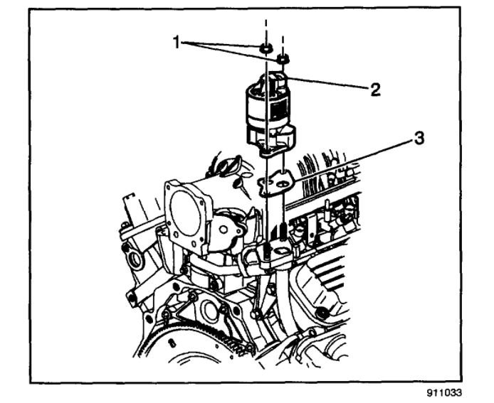

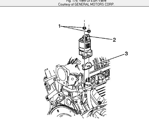

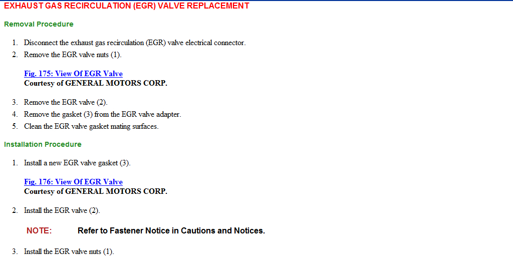

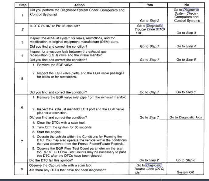

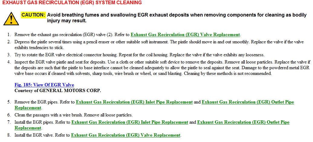

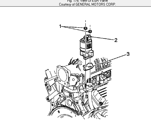

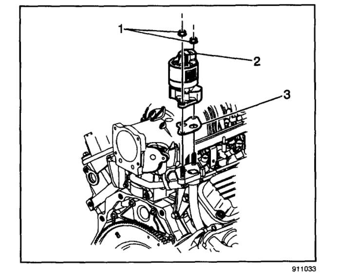

P401 code showed, I changed EGR valve, clean throttle body, cleaned EGR ports, replaced fuel pressure solenoid and gas cap. When I plugged EGR valve back in the car still idles fine but soon as I put it in drive and try to give it gas it shuts off.

I would remove the EGR valve and start the engine. You should have a large exhaust leak and a heavy vacuum leak if the passages are clear.

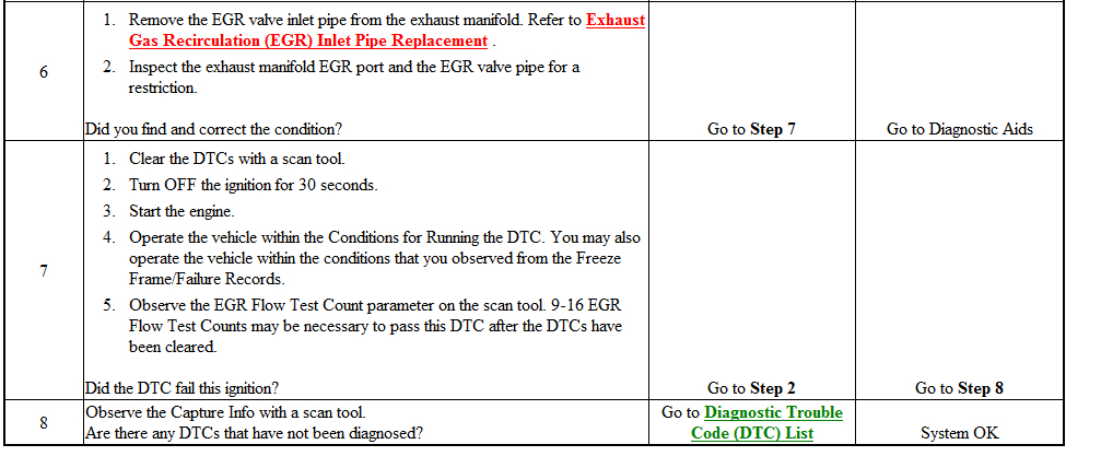

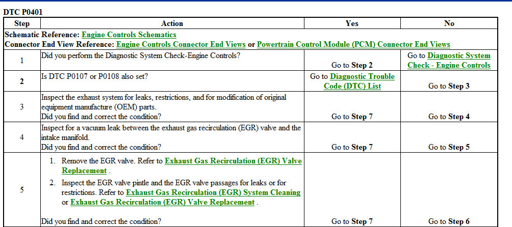

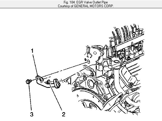

I attached the flow chart for the code below. Did you follow all the steps?
DTC P0401
CIRCUIT DESCRIPTION
The powertrain control module (PCM) tests the exhaust gas recirculation (EGR) system during deceleration. The PCM does this by momentarily commanding the EGR valve to open while monitoring the signal circuit of the manifold absolute pressure (MAP) sensor. When the EGR valve is opened, the PCM will expect to see a predetermined increase in MAP. If the expected increase in MAP is not detected, the PCM records the amount of MAP difference that was detected and adjusts a calibrated fail counter towards a calibrated fail threshold level. The number of EGR flow test counts required to exceed the fail threshold may vary according to the amount of detected EGR flow error.
Normally, the PCM will only allow one EGR flow test during an ignition cycle. To aid in verifying a repair, the PCM will allow up to 16 EGR flow test counts during the first ignition cycle following a code clear event. Between 9-16 EGR flow test counts should be sufficient for the PCM to determine adequate EGR flow and pass the EGR flow test. If the PCM detects an EGR flow error, DTC P0401 sets.

Inspect for the following conditions:
A vacuum restriction to the MAP sensor-A skewed MAP sensor reading can cause the PCM to read incorrect MAP changes during the EGR flow test.
An engine that is running poorly due to a mechanical condition such as worn piston rings, worn camshaft, etc.-These types of conditions can cause low engine vacuum and thus can cause a less than expected MAP changes during the flow test.
Excessive back pressure in the exhaust system may cause this DTC to set. This condition can cause low engine vacuum and thus can cause a less than expected MAP changes during the EGR flow test. Possible causes of this could be a restriction in the exhaust system or non original equipment manufacture (OEM) exhaust parts.
Exhaust system leaks can cause an insufficient amount of EGR flow through the EGR valve. This condition can cause a less than expected MAP changes due to insufficient exhaust back pressure. possible causes of this could be a leaking exhaust system, a leaking EGR pipe or non original equipment manufacture (OEM) exhaust parts.
A restriction in the intake manifold such as carbon deposits and casting flash
TEST DESCRIPTION
Steps 1-8
The number below refers to the step number on the diagnostic table.
2. MAP sensor faults must be diagnosed first. A skewed MAP sensor reading could cause this DTC to set.

Check the attachment below of complete procedure of the fault code p0401,with diagrams.
let us know what happens with you.
