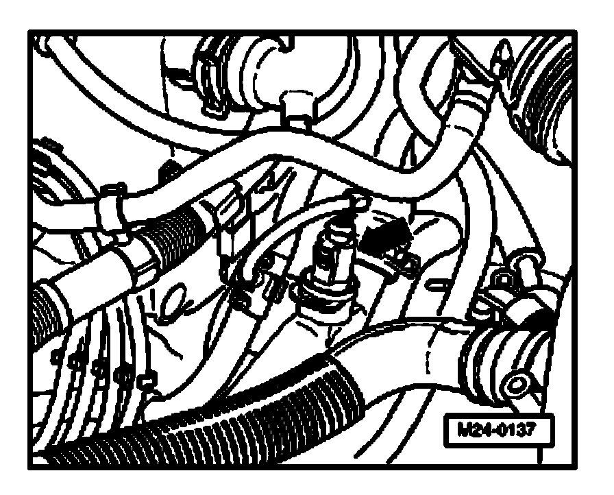

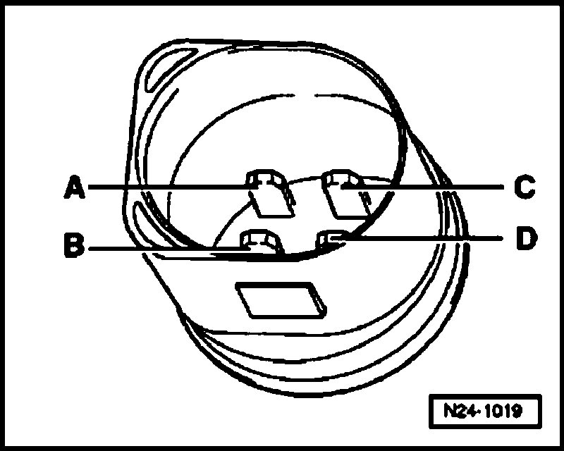

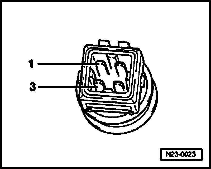

Also, the temperature gauge goes to low range then back to normal range intermittently. I do not believe that the engine is overheating. How many sensors and where are they located that are related to this?
Aug 11, 2018 at 5:02 PM
  • 110,244 POSTS

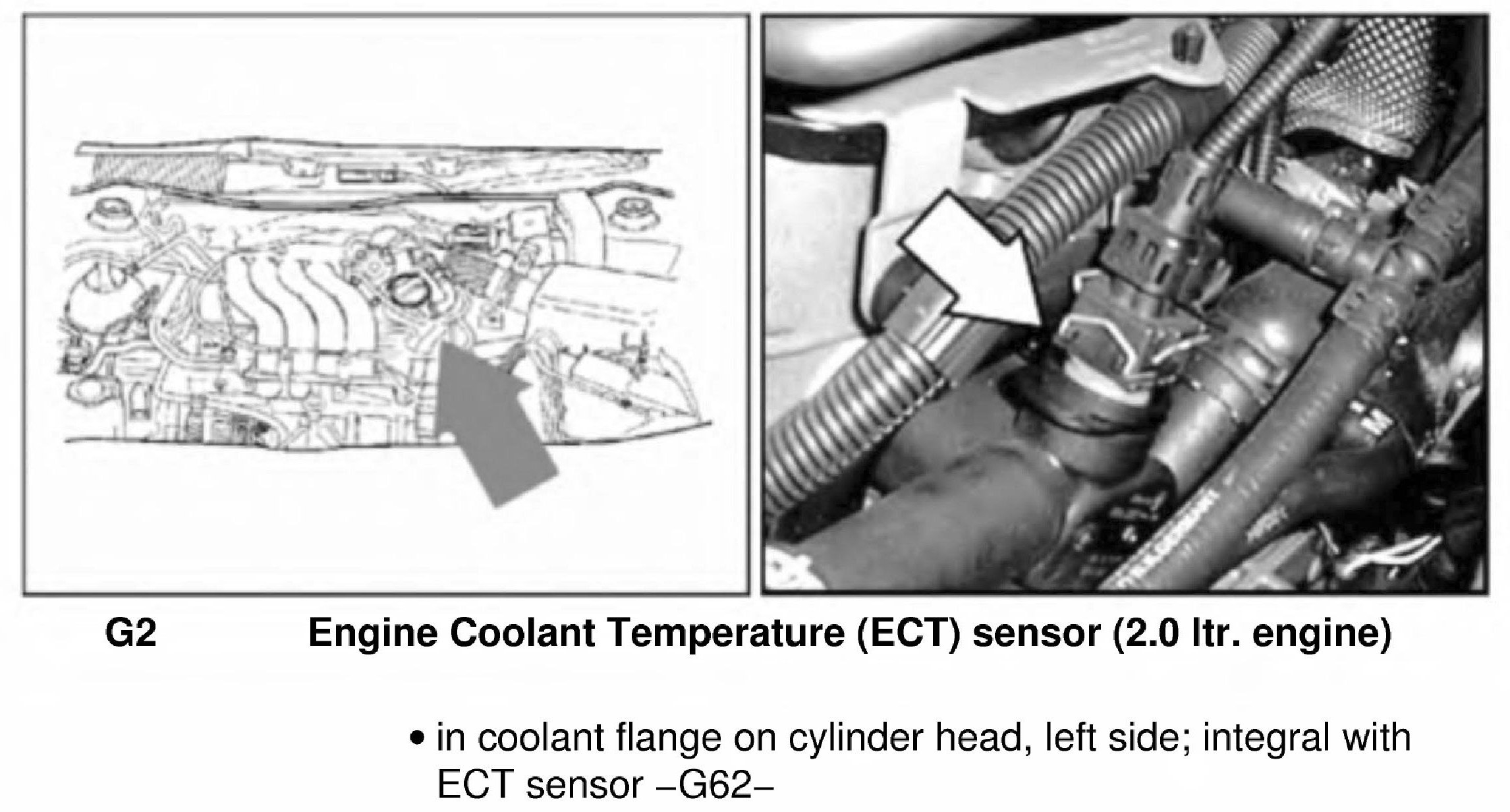

The code indicates the engine coolant temperature sensor (ECT) is indicating the engine isn't warm enough. The sensor which correlates with this tells the computer the coolant temperature. From that, the computer determines what the fuel/air ratio should be for the engine.
Since the gauge is giving you trouble at times inside, (which is a different sensor), I have a feeling the thermostat is stuck open and not allowing the vehicle to meet the minimum recommended operating temp. However, the sensor could be the issue.

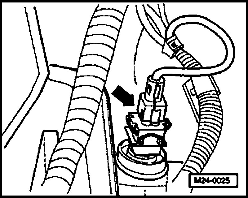

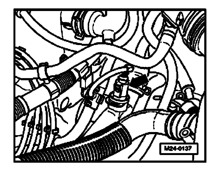

Pic 1 is the ECT. It shows where it is located and what to look for.
I have attached the directions for checking the sensor, but to be honest, it is very extensive. You indicated that you are a mechanic, so I am sure you are familiar with this type of trouble shooting information. All remaining pictures correlate with these directions.

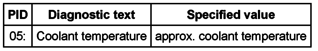

- Connect diagnostic tester. See: Computers and Control Systems > Reading and Clearing Diagnostic Trouble Codes > Diagnostic Tester, Connecting
- Switch ignition on.

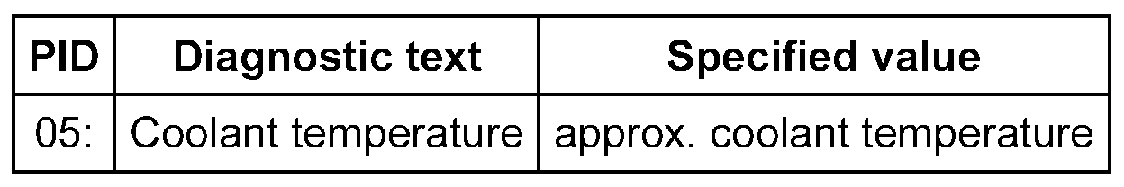

- Under address word 33, select "Diagnostic mode 1: Check measured values."
- Select the measuring value "PID 05: Coolant temperature".
- Check specified value of coolant temperature:

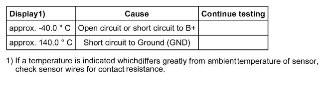

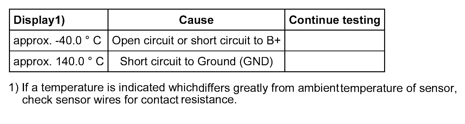

If specified value is not obtained:

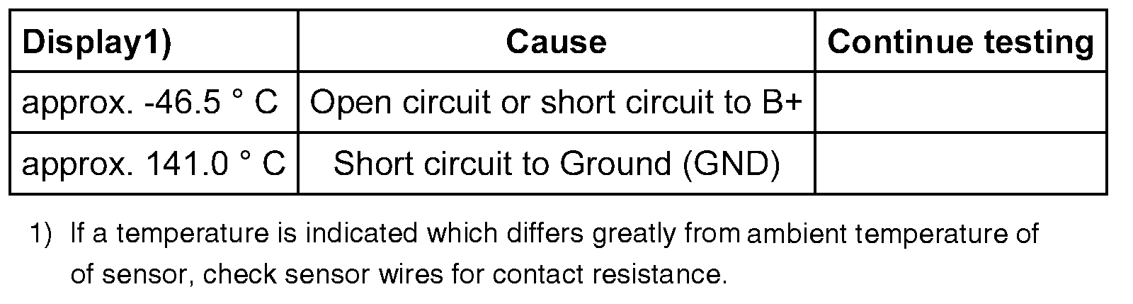

- Continue test according to the following table:
If specified value is obtained.
- Start engine and let run at idle. The temperature must climb uniformly.

- If the engine shows problems in certain temperature ranges and if the temperature does not climb uniformly, the temperature signal is intermittent and the sensor should be replaced.
Continuation of test if indication is approx. -46.5 degrees C

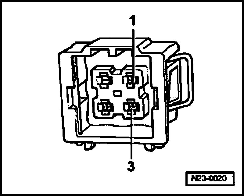

- Disconnect 4-pin connector from Engine Coolant Temperature (ECT) sensor -G62- with Engine Coolant Temperature (ECT) sensor -G2- (arrow).

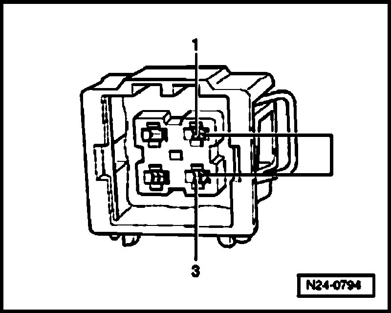

Vehicles with old connector shape
- Bridge terminals 1 + 3 of connector using the respective adapter cables and observe the indication on display.

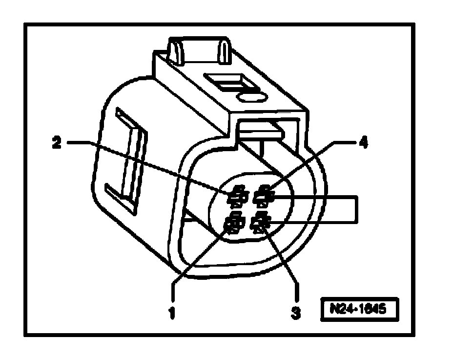

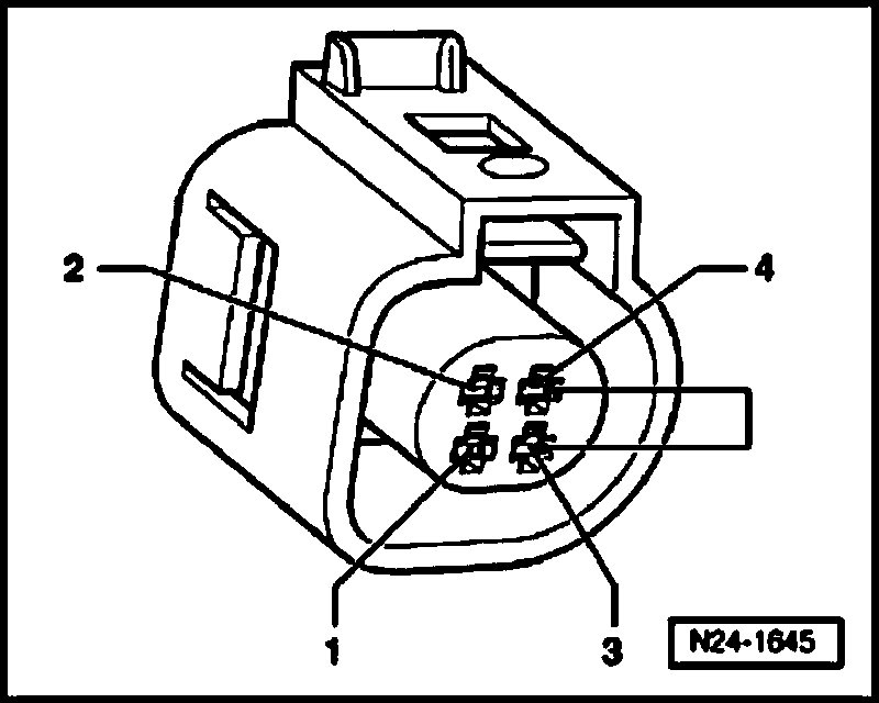

Vehicles with new connector shape
- Bridge terminals 3 + 4 of connector using the respective adapter cables and observe the indication on display.
Continued for all connector shapes
If indication jumps to approx. 141.0 degrees C
- End diagnosis and switch ignition off.

If indication remains at approx.-46.5 degrees C
- Check wires according to wiring diagram.
Continuation of test if indication is approx. 141.0 degrees C

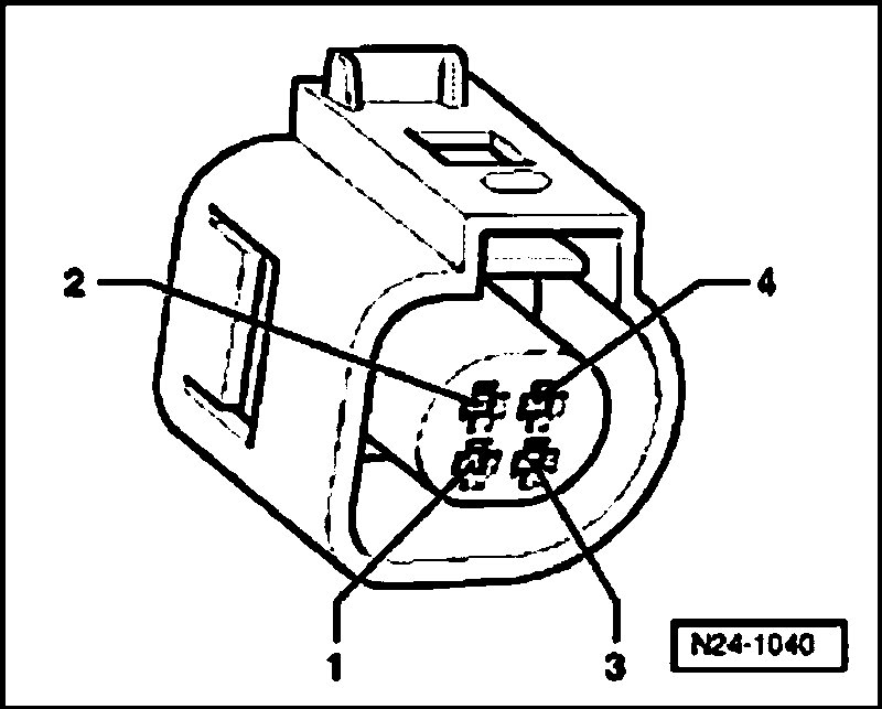

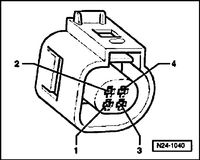

Vehicles with old connector shape (see pic)
- Check wires between test box and 4-pin connector for open circuit according to wiring diagram.
Terminal 1 + socket 67
Terminal 3 + socket 53
Wire resistance: max. 1.5 Ohms
Vehicles with new connector shape (see pic)
Terminal 3 + socket 93
Terminal 4 + socket 108

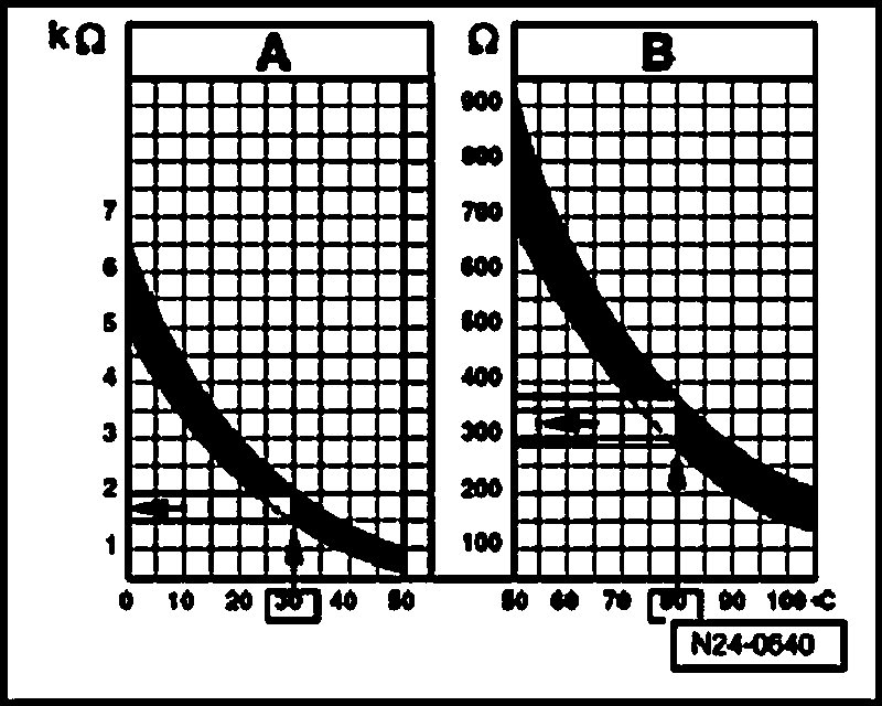

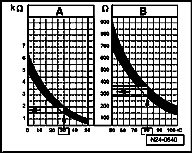

- Perform a resistance measurement at Engine Coolant Temperature (ECT) sensor -G62- terminal 1 (Ground) and 3 (signal).
- Measure resistance at Engine Coolant Temperature (ECT) sensor -G62-, terminals C (signal) and D (Ground).
Continuation for all connector shapes
Range A displays resistance values for temperature range of 0 to 50 degrees C, range B displays resistance values for temperature range of 50 to 100 degrees C.
Read-out examples:
- 30 degrees C is in range A and corresponds to a resistance of 1.5 to 2.0 kilo Ohms
- 80 degrees C is in range B and corresponds to a resistance of 275 to 375 Ohms
- Select measuring value "PID 05: Coolant temperature".
If specified value is obtained:

- Measure resistance at Engine Coolant Temperature (ECT) sensor -G62-, terminals C (signal) and D (Ground (GND)).
Range A displays resistance values for the temperature range of 0 to 50 degrees C, range B displays resistance values for the temperature range of 50 to 100 degrees C.
Read-out examples:

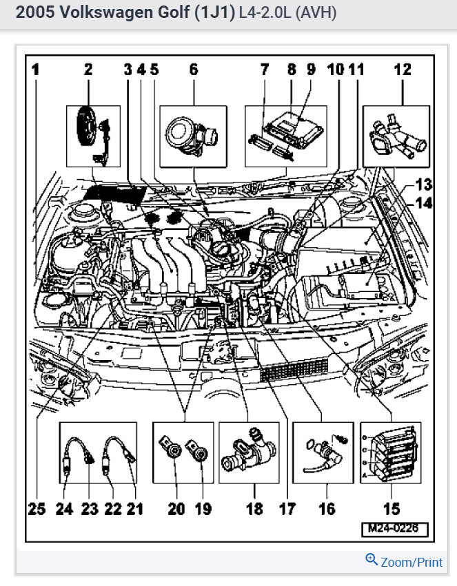

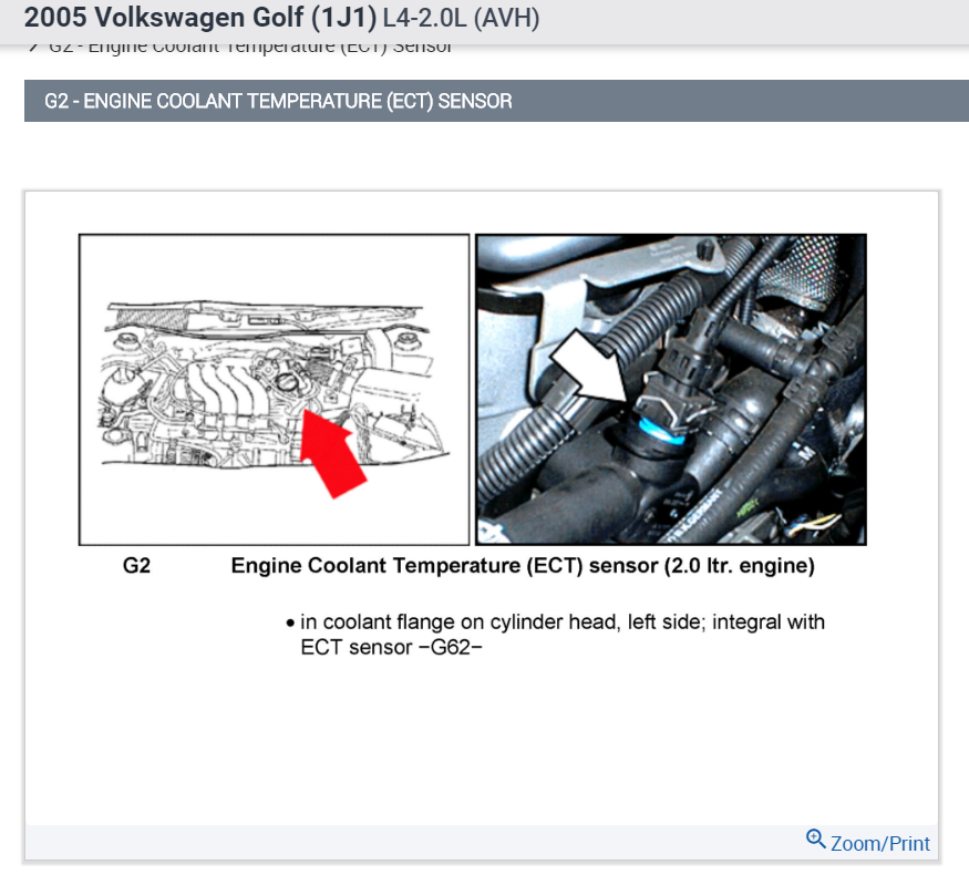

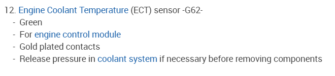

Are you sure there are two different sensors? I am only seeing one on the thermostat housing. It is held in with a clip and has an o-ring
Aug 25, 2018 at 4:07 AM
  • 55,433 POSTS
Here are more diagrams on the coolant sensor location and a guide to help you see what you are in for when changing the sensor out:
https://www.2carpros.com/articles/coolant-temperature-sensor-cts-replacement
Aug 28, 2018 at 3:53 AM
