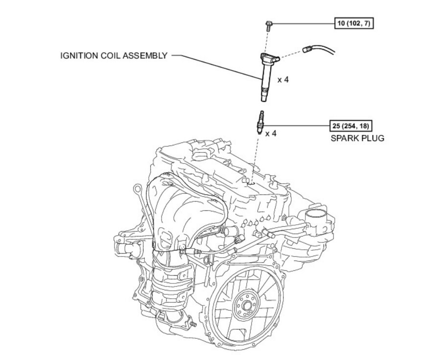

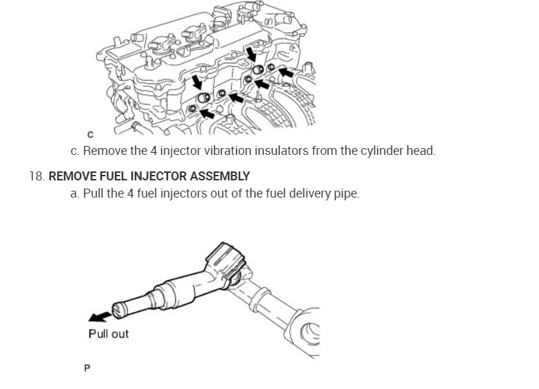

I got cylinder misfire code P0303. then i cleaned the ignition coil and interchanged coil from cylinder 3 and 1. I got again the same code P0303. I get this misfire P0303 and engine vibration while going up on bridges in highway. It's not responding when i give accelerate at bridges. Can anyone suggest what to do next? Recently changed all spark plugs (before 2 months).
Mar 21, 2023 at 12:40 AM
  • 55,758 POSTS

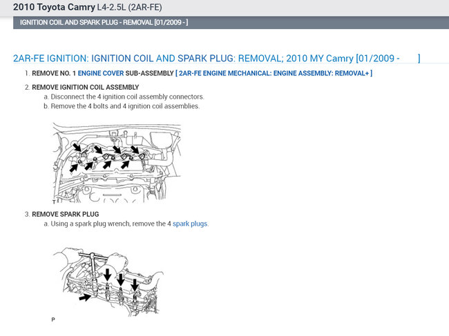

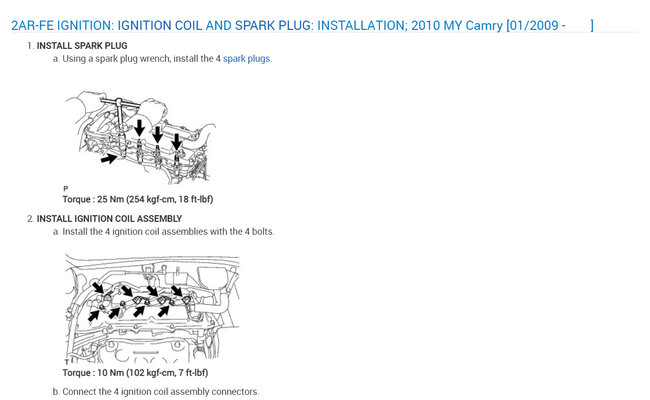

You could have a cracked or defective spark plug. The first thing I would do is change out the spark plug for a new one. Here are instructions in case you need them.
https://www.2carpros.com/articles/how-to-change-spark-plugs
Mar 21, 2023 at 3:52 AM

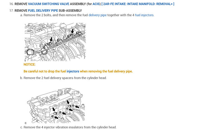

Thanks for your suggestion and I have checked the spark plug which is black color and changed new spark plug in cylinder 3. but today again I face the same problem where engine light was blinking and stopped after 15 seconds which driving upwards on highways, but the check engine light was not recorded. So I am not able to see the code.
Mar 22, 2023 at 11:50 PM
  • 55,758 POSTS

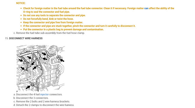

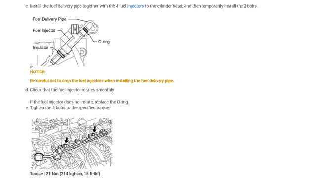

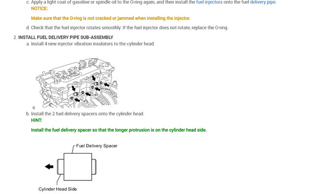

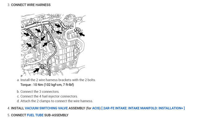

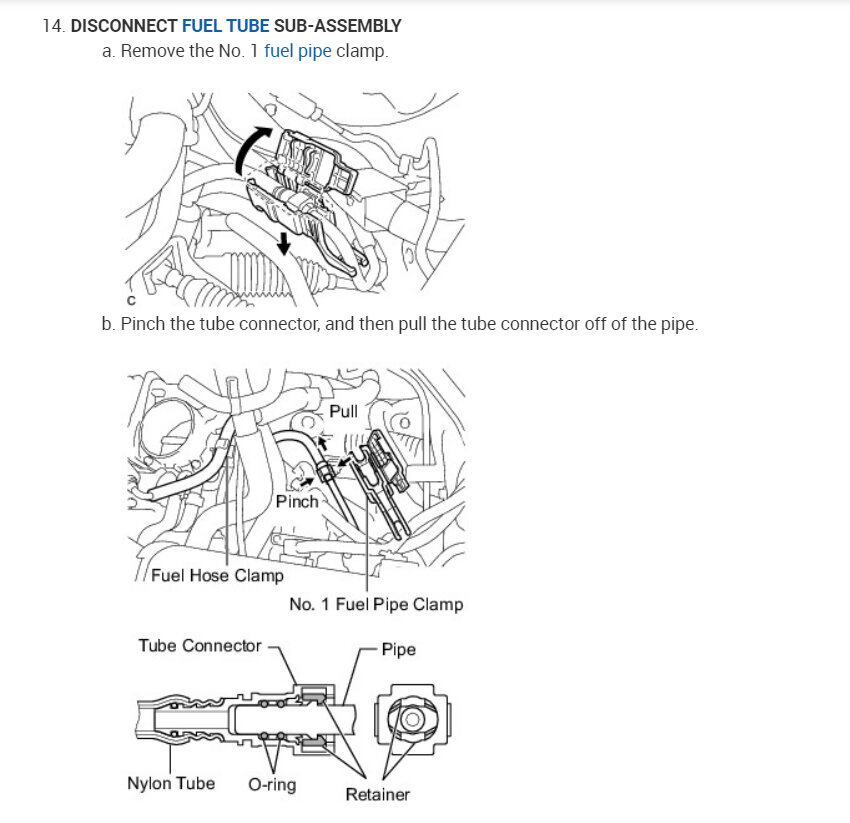

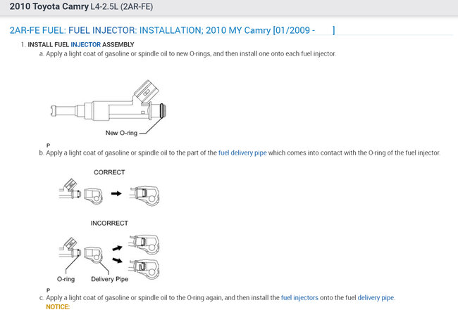

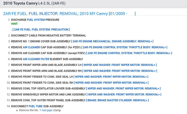

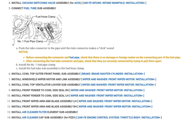

If the spark plug has black it sounds like you have a stuck injector. I would do a compression test as well, here are the instructions so you can get the job done.
Here is how to change the injector out. Check out the images (below). Please let us know what happens.
