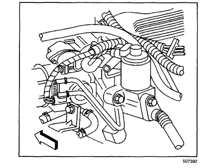

Furl pressure is between 52 to 57 psi. Engine skips at idle and at high engine rpm engine surges.
Apr 12, 2018 at 5:27 AM
Okay, that reading is good.
Try disconnecting the EGR valve electrical connector and drive it and see if it continues.
Apr 12, 2018 at 6:19 AM
SAMGREW
  • 59 POSTS
Disconnected EGR electrical connector. No change.
Apr 12, 2018 at 11:38 PM
Okay not the EGR. I would also check the catalytic converter. An easy way to check is to remove one of the upstream O2 sensors and drive it and see if it changes. that will check for partial restriction in the converter.
