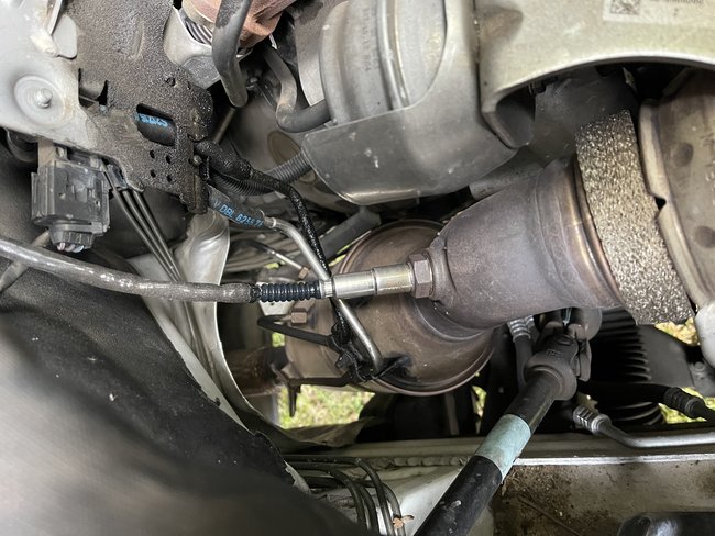

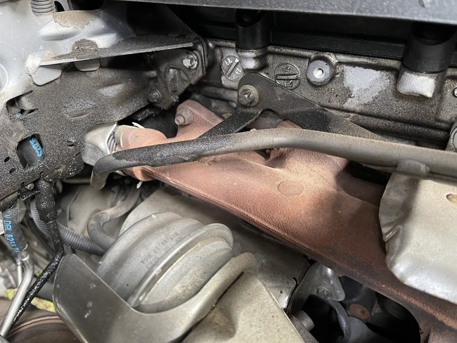

Hi Kenny. The 02 sensor part number is 003 542 18 or 16. I replaced it with a non-genuine part, but Mercedes coded it into my ECU. It didn’t stop it. I saw that it looks like I have an injector seal leak. I’ve attached pics. Also, the 02 sensor was replaced.
Thanks
Jun 11, 2022 at 12:40 AM
Interesting. Clearly, we can't have a leak, but I am not sure this is the cause of the NOx code. However, we need to fix what we see and then retest.
So, I would repair that and go from there because I can make the case that it could cause it.
