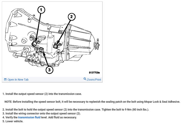

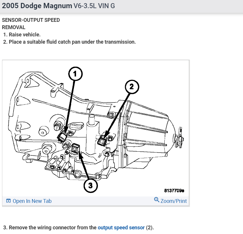

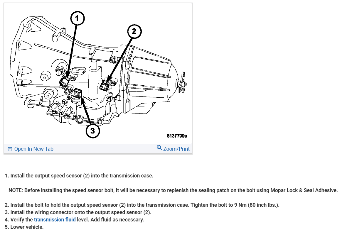

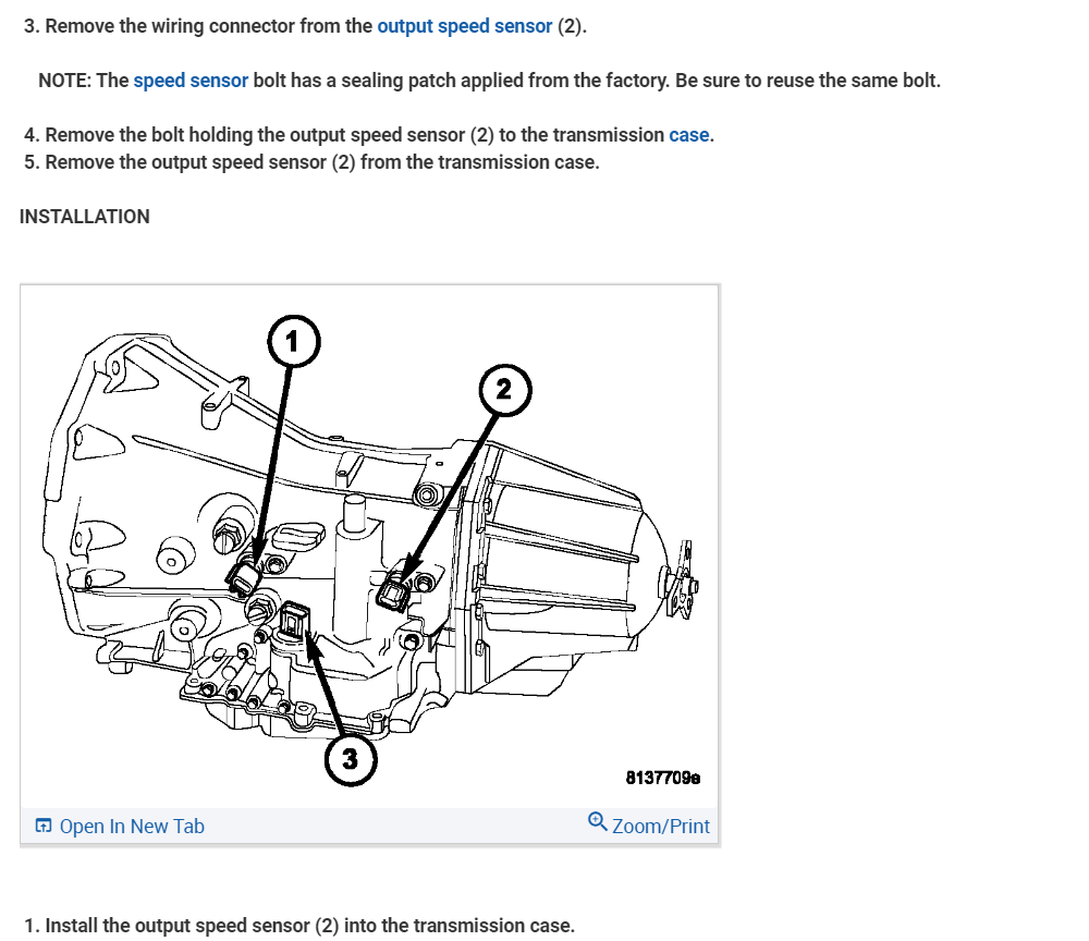

It sounds like the Input shaft or turbine shaft speed sensor is bad.
The error code P2767 in a 2005 Dodge Magnum corresponds to an issue with the Transmission Control Module (TCM).
Here is how to change the sensor it out (1). Be sure to clear the codes after the repair is complete. Check out the images (below). Please let us know if you need anything else to get the problem fixed.

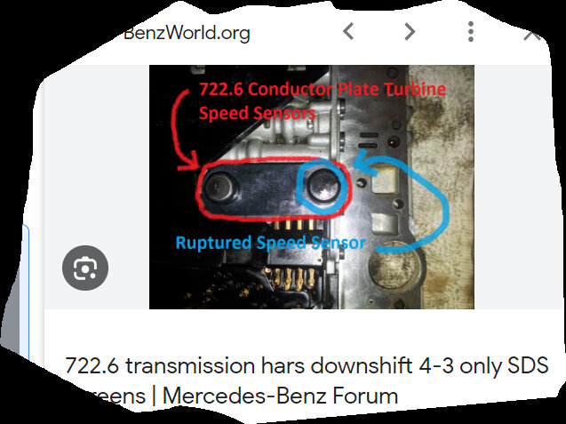

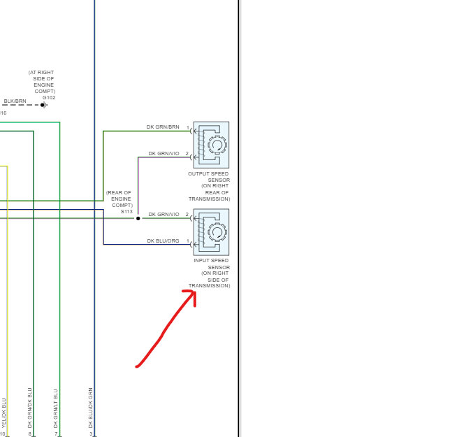

i have a nag 1 transmission. Isn't the sensor on the conductor plate inside the transmission?
Jul 15, 2023 at 4:50 AM
  • 55,224 POSTS
I double checked and this is where they say it is. Check out the images (below). Please let us know what happens.

this is the turbine speed sensor on a 722.6 transmission on the conductor plate!
Jul 16, 2023 at 3:53 AM
  • 55,224 POSTS
Maybe it is a mid-year change, I would inspect the transmission and if the sensor is not on the side of the transmission it is inside on the conductor plate. Please let us know what you find.

I've already changed out the conductor plate with the sensor on it. So far, it's doing okay. Kind of slow changing into 3rd hopefully it's just fluid level!
Jul 17, 2023 at 3:59 AM
  • 55,224 POSTS
Good job, it might take some time for the logic to relearn, just keep driving it it should be okay. Use 2CarPros anytime, we are here to help. Please tell a friend.
