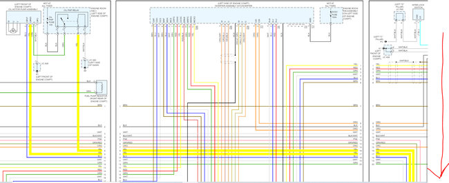

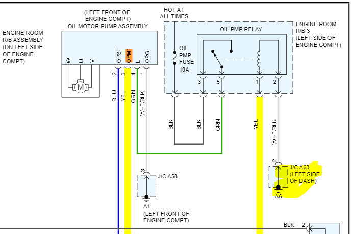

The diagnostics you have are the same as mine. The signal wire to the primary side of the relay shows yellow. Is that what you are seeing? If not, what colors are you finding?
Did you check if the primary side is getting a power signal? If it has power, does the white wire with a black tracer provide a ground to the primary side?
Are there any other codes?
See pic below.

The primary side does not get power. That is my issue.
I am also concerned that the wiring diagram is not accurate in terms of what I am seeing in the car. The relay has white wire for primary side and white/black for ground. White/black does provide ground, but I am not getting power on the primary side.
The ECU pin that is connected to the primary side is yellow, but somewhere along the line it changes to white at the relay. No power output at the ECU pin.

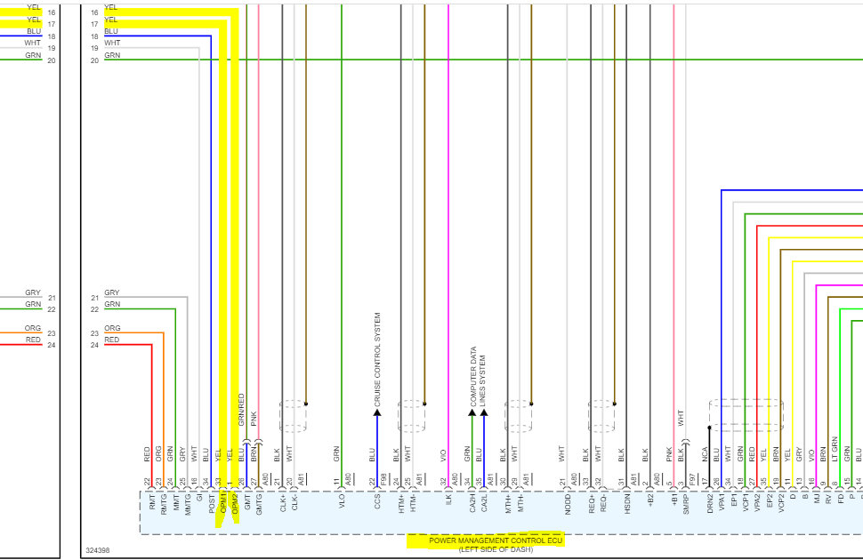

Also, according to the wiring diagram, the power wire to the relay is BLK. Mine is BROWN. It does have battery voltage on it.
I have no 12v output on OPM2 (pin 1) and (checking with oscilloscope) no waveform signal on OPM1 (pin 33) - or OPST for that matter.
Diagnostic says Replace Power Management ECU - this is the 3rd one. How many faulty ones can I have?

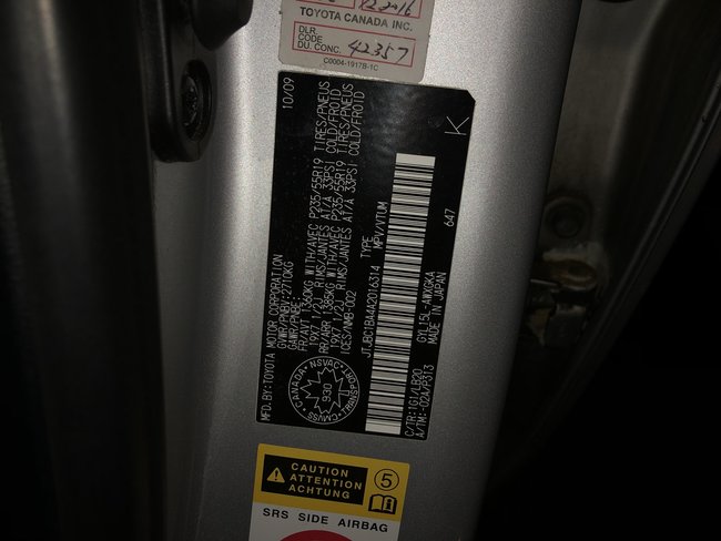

I'm sitting here thinking about this issue. By chance, could you provide the manufacturing date of the vehicle? If it is an early or late model, something may have changed.
Aug 15, 2022 at 12:19 PM
SPEEDRACER3
  • 25 POSTS
I was wondering about that myself. The black nameplate on the door jamb, with the VIN on it says 10/09 in the top right. Oct/09?
Aug 15, 2022 at 1:54 PM
  • 110,244 POSTS
It's an early model year production vehicle. No luck. I went back a year. They are totally different. Nothing is listed for OPM doesn't show up on a 2009.
Joe.
Aug 16, 2022 at 10:39 AM
SPEEDRACER3
  • 25 POSTS
So, the wiring diagrams are not the right ones for it? This is going to be fun trying to figure the ECU pinouts. All the other 3 wires line up in colors with the current data. Just the output to the relay is different (on the relay side) - the ECU side is yellow.

I went through two manuals and found the same thing. Something isn't adding up. According to my schematic, the wire is yellow from the ECU to the relay. See the pics below. Other than that, we are missing something.
Aug 17, 2022 at 1:15 PM
