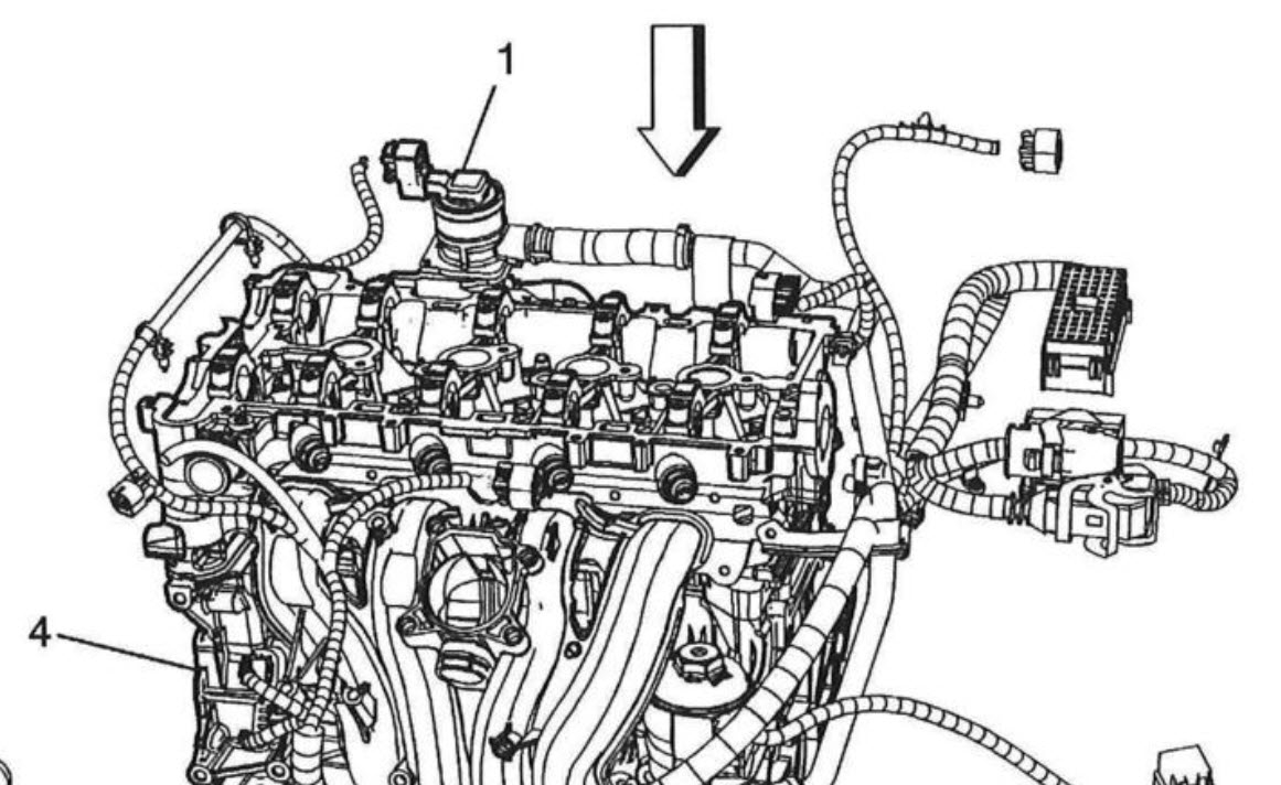

P2430 code on check engine light
2009 CHEVROLET COBALT
48,000 MILES • 2.2L • 4 CYL • FWD • AUTOMATIC
JOHN MCDONALD
Does this type engine run safely at 207°?

normal temperature is around 210 degrees. it is under pressure so it takes about 260-275 degrees before it boils over so i would say it is normal.

sorry did not read question completely, 2430 is secondary air injection system pressure sensor circuit.this can be a connection problem to solenoid for this system or wiring shorting out or solenoid. see picture for location of solenoid.
