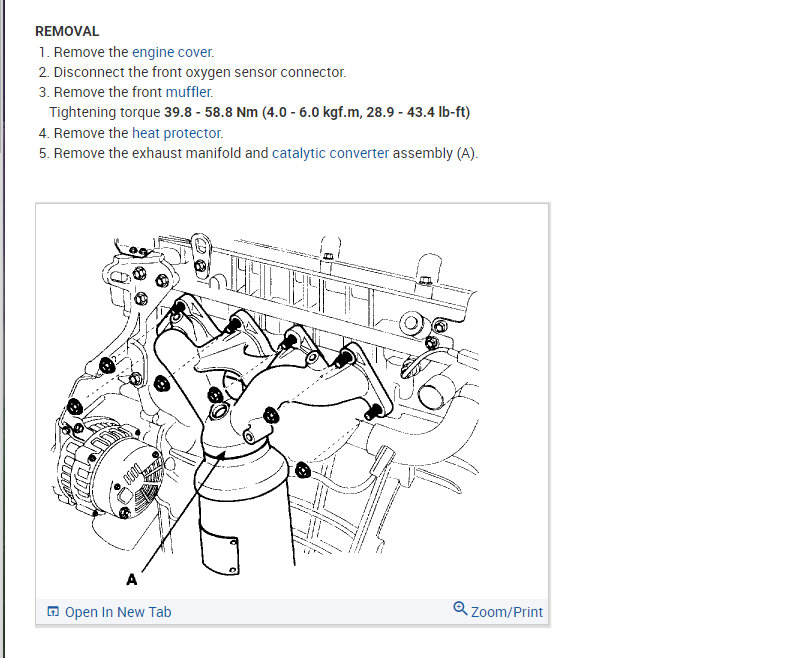

I need to change the bank 1 sensor 1 oxygen sensor can you help me?
2008 HYUNDAI ELANTRA
118,000 MILES • 2.0L • 4 CYL • 2WD • MANUAL
SJAMESN

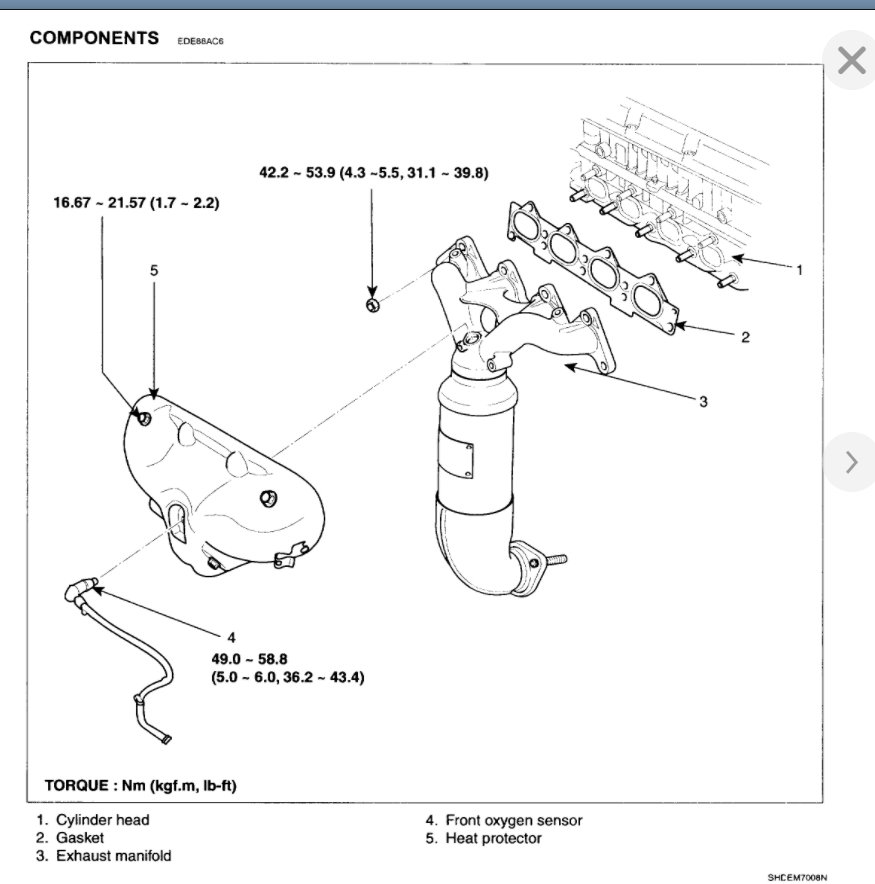

I need to locate the oxygen sensor 1. If you could show me where both of the upstream sensors are that would be great, that way I know I have the right one. Also, if you could point me in the right direction regarding which brand of oxygen sensor I need for my car specifically, that would be fantastic as well.

Here is a guide that will help with step by step instructions on how to replace this:
https://www.2carpros.com/articles/how-to-replace-an-oxygen-sensor
Plus here is a video on a Honda that will be similar to your vehicle which will give good detail that will help:
https://youtu.be/gY69eK79Fhk
Also, the attached info below will show the location and process on how to remove the sensor.
Please let us know if you have other questions and we can go from there. Thanks
