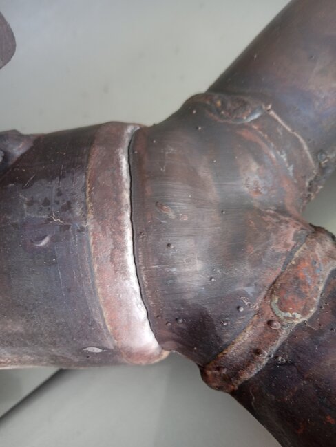

p2238 oxygen sensor pumping current circuit low (for a/f sensor) (bank 1 sensor 1). what is the common cause of the code and other causes ? is the code related to the heater circuit or to the sensor sense circuit ?also what i noticed is that the o2 sensor heater monitor says n/a usually when the monitor is not complete it says inc and when ready it says ok .

The code P2238 refers primarily to the sensing/pumping-current portion of the upstream air/fuel-ratio sensor (Bank 1 Sensor 1), rather than being specifically a heater-circuit code. This can be caused by a cylinder misfire, can I ask how the engine is running? If the engine is running okay I would replace the primary oxygen sensor. Here is the location. Please clear the codes once the repair is completed.

the engine runs good no misfire or hesitation. I found a crack in the exhaust manifold. i guess corollas are famous for cracked exhaust manifold .the old AFR is a Toyota one .i bought a Denso

Yep, you found the problem, nice work, I would have it rewelded or try to find a used one on Ebay.
